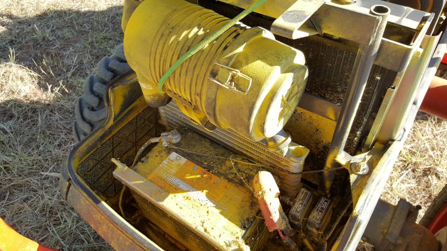

There have been times, in very dusty brushhogging situations, where I've wondered if the exhaust could be rerouted just enough to create an 'air curtain' in front of the grill and keep the air holes from getting clogged with grass. It's probably a long shot but it seems like even a little bit would help. I'd think the routing could be done so that the exhaust isn't getting sucked right back in the air intake.
I've been in conditions where I couldn't run for 45 minutes without having to stop and clean out the radiator. This was a no-buckle, loader-arms-up, situation so it wasn't that the bucket was kicking up all kinds of grass. I try to mow perpendicular to the wind (not too many completely calm days in OK) but sometimes that's not an option.
Whatchya think?

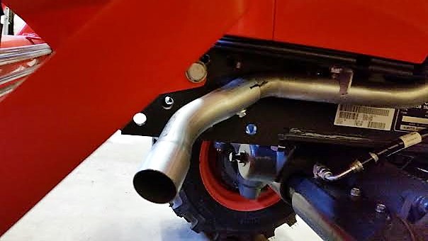

Wondered this myself as I just purchased a new B2601 with FEL, Backhoe, Forks this year to replace a 33 year old Mitsubishi Beaver III. I found the pipe below on Amazon (Camco 44862 8" 30 Degree EMT for Gen-Turi Generator Exhaust System) and it fit great! $12. Hope this helps. Tractor exhaust 1.jpg

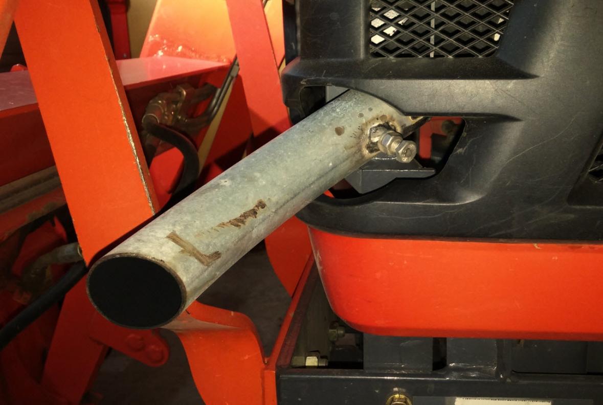

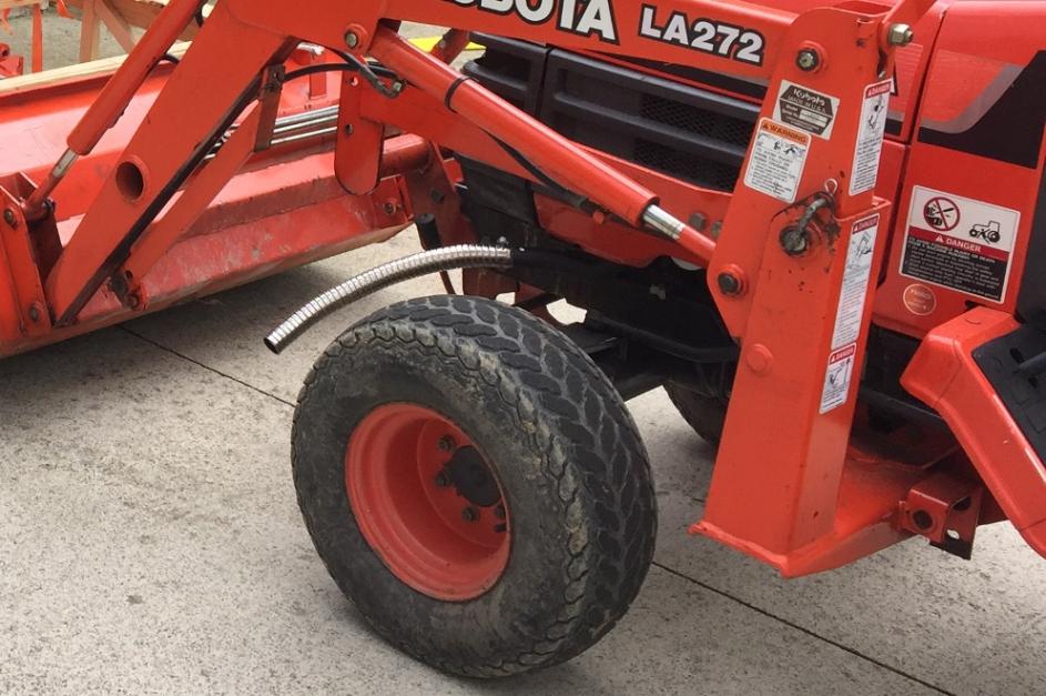

Thought I would resurrect this thread to show how I finally resolved my soot on the FEL problem.
1.25 inch stainless flex pipe joined to the original exhaust pipe with a 1.25 inch piece of antenna tubing. Cut a three inch piece of the tubing, slit is down the side and worked it into the original exhaust pipe then slid the flex pipe over the other end and used a clamp to secure it. I also used a short metal screw to secure the end in the original pipe. Extension is about 18 inches long.
Works very well.

Wondered this myself as I just purchased a new B2601 with FEL, Backhoe, Forks this year to replace a 33 year old Mitsubishi Beaver III. I found the pipe below on Amazon (Camco 44862 8" 30 Degree EMT for Gen-Turi Generator Exhaust System) and it fit great! $12. Hope this helps. View attachment 26543
That is a good fix. I couldn't find any pipe other than the flex in a 1 1/4 size. Does the B2601 have a larger diameter exhaust pipe?

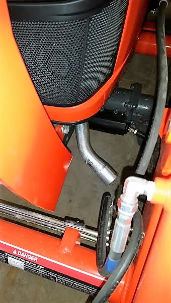

BX2230 exhaust extension.. This one is removable as that is required to get the engine shroud off.
The section cut from a 1 1/4" diameter 90 degree conduit bend is held on by the stainless steel bolt shown. The tip of the bolt was ground into a point that mates up with a small hole drilled into the original Kubota exhaust.
To put it on, slide it over the original exhaust lining up the bolt with the hole, tighten the bolt just enough to lock it in place, then tighten the second nut to lock the bolt in place..
