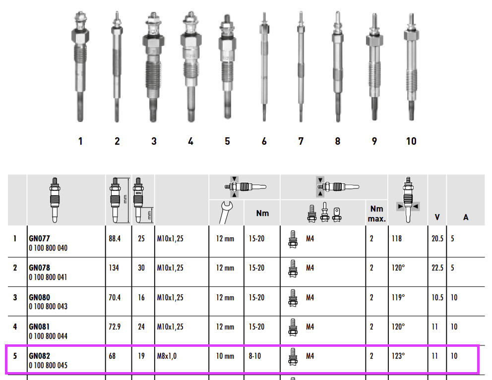

Were there any numbers at all on the glow plug you pulled? Beru is a large global manufacturer of glow plugs.

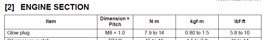

WSM says it's M8x1.0 thread.
Beru lists four part numbers in their catalog.
Of those four, only GN082 has M8x1.0 threads. Do the dimensions of GN082 match up with what you measured?
If the dimensions match up, you can cross reference GN082 with other manufacturer part numbers. NGK 2649 is one of the cross references and Rockauto does have it.
