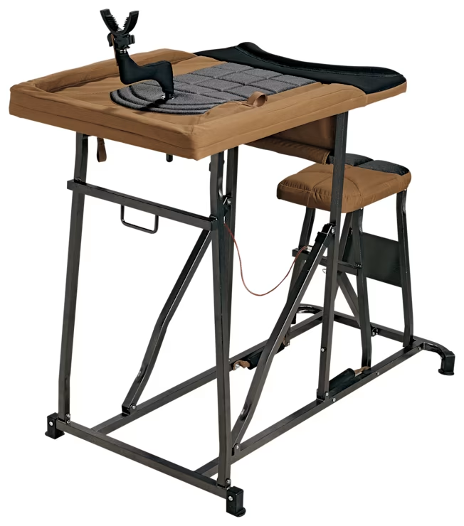

I recent bought one of these and love it.
I especially like that "height adjustable, swivel'able gun rest".
It makes for a very fast and convenient rest. It also detaches in seconds and stores nicely. (although that may not be a big deal for a permanent structure)
I really like that feature, so if it's possible, maybe incorporate something similar?

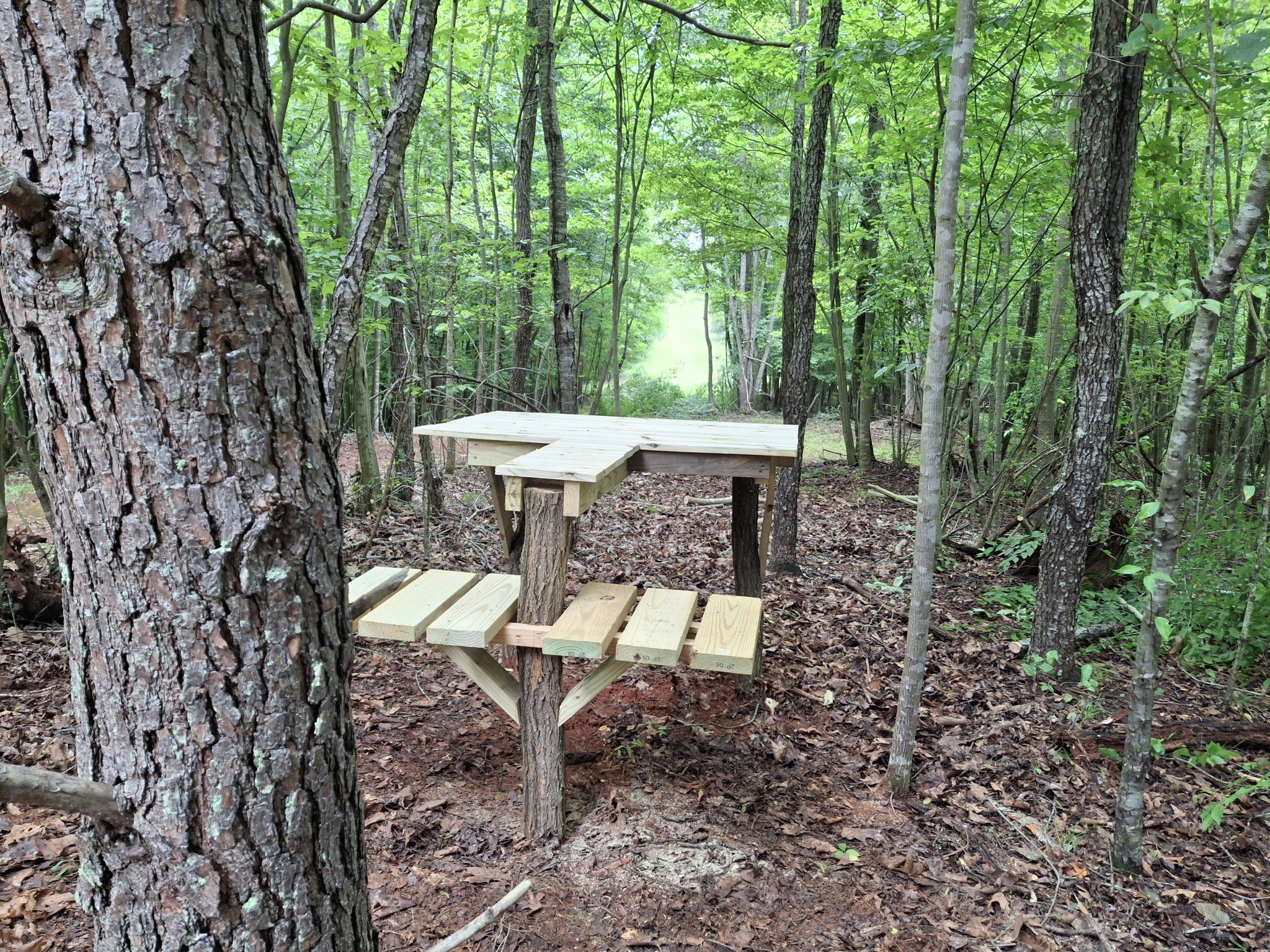

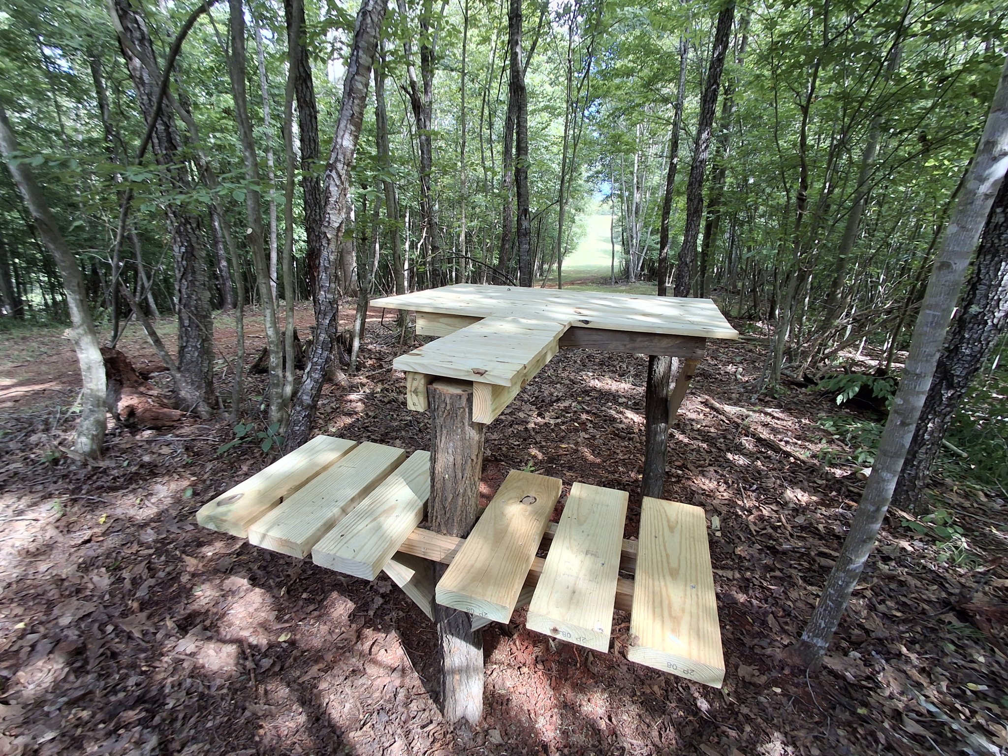

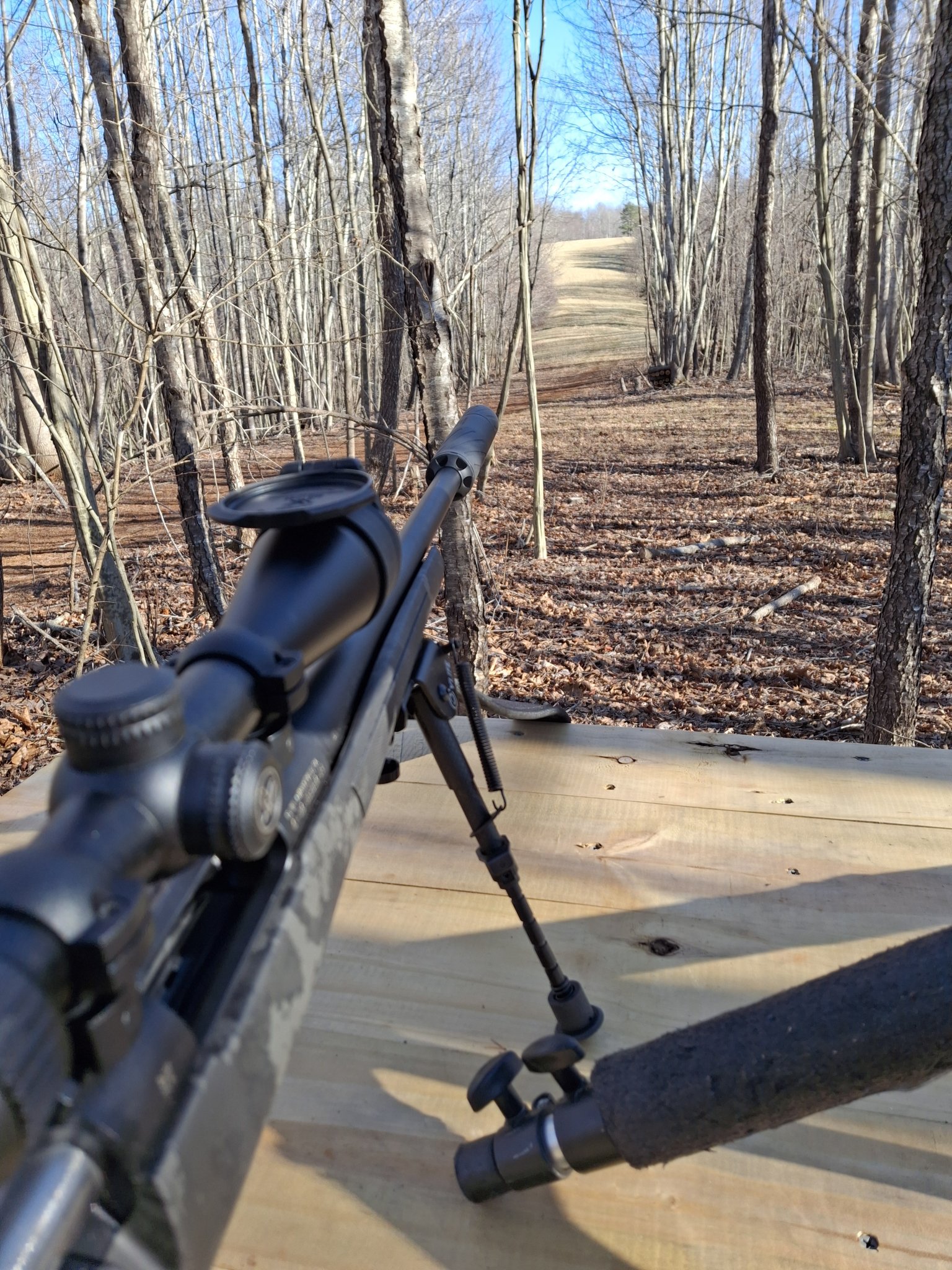

I have built several over the past few years. None are at the size you allude to. My last one is my best one. All are made by cutting down black locust trees (5in dia) which are rot resistant and then sink em a foot or more in the ground with a post hole digger. The frame and tops are fabbed from cull lumber at Lowes. I think I built my last table for less than $30. They sit out 24/7/365 so a light coating of Thompsons waterseal.

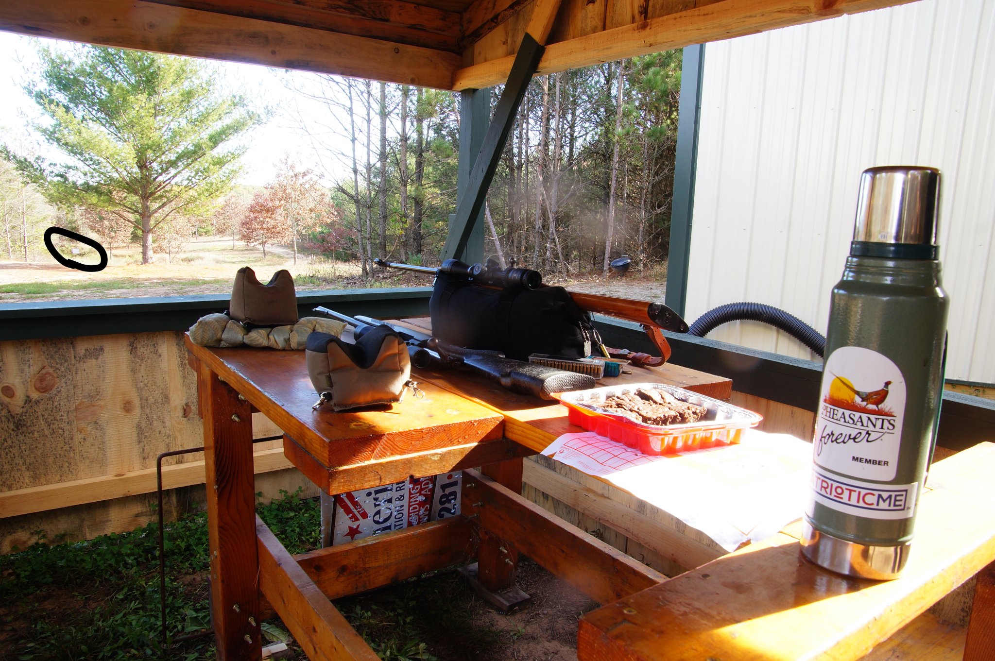

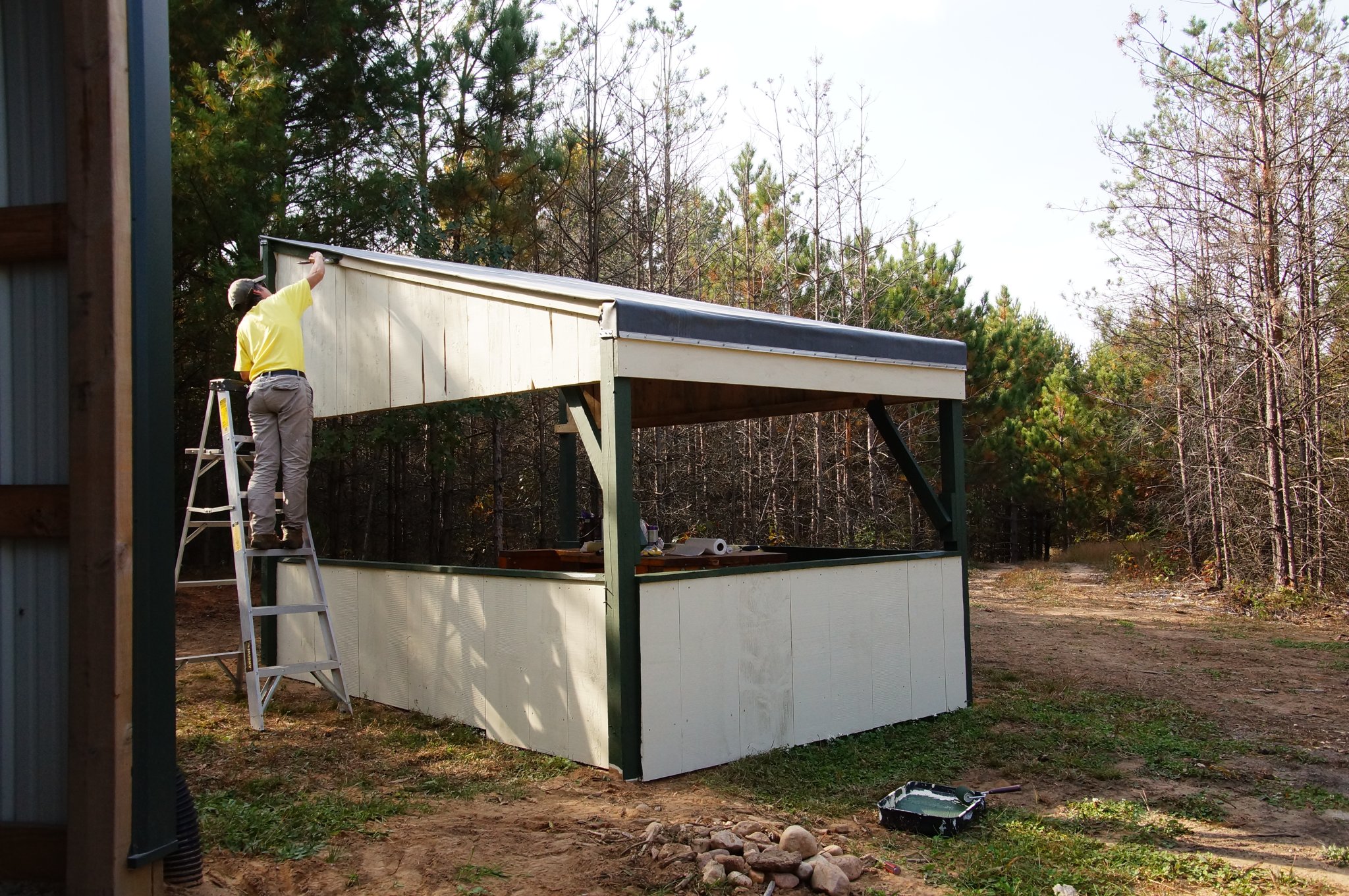

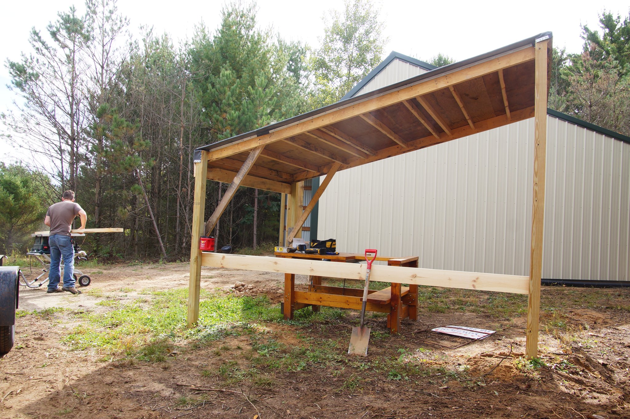

I was gifted this one. No frills but works well for me and my guests. T shaped to accommodate right and left hand shooters.
4 x 4 , 2 x 12 and 2 x 6 construction bolted and screwed together with wood sealer to protect from the elements. My soil is sandy and was easy to level and with the legs a inch or two in the sand makes for a very stable bench.
With the covered bench structure it has become a gathering space to chat, swill coffee and swap hunting and shooting stories as much as a bench to shoot from, :)
