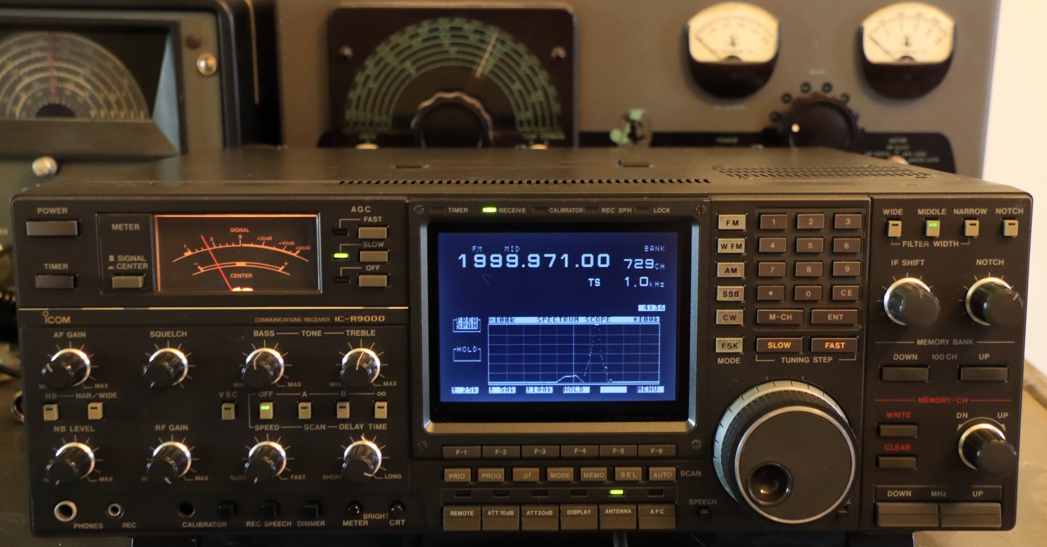

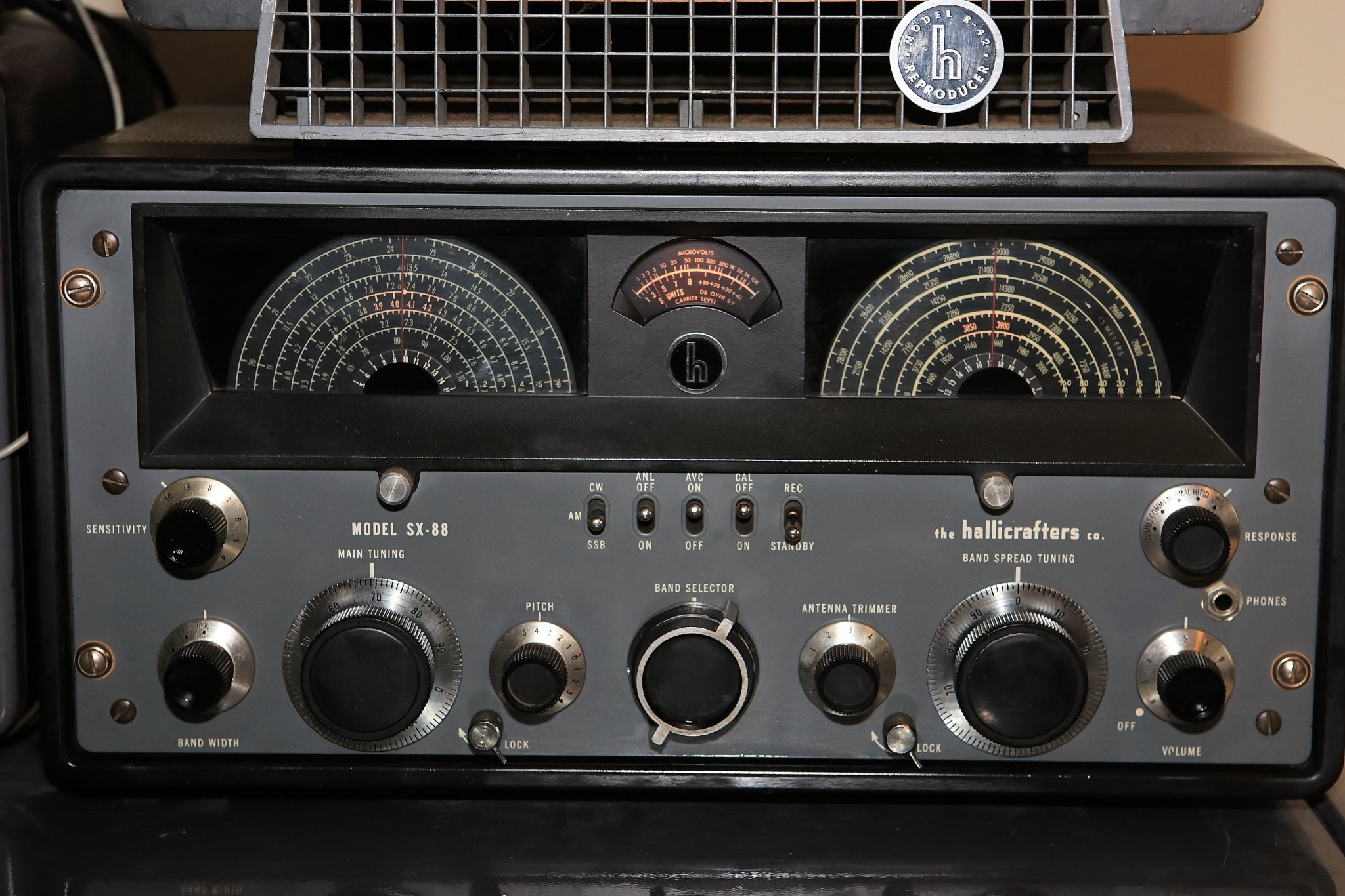

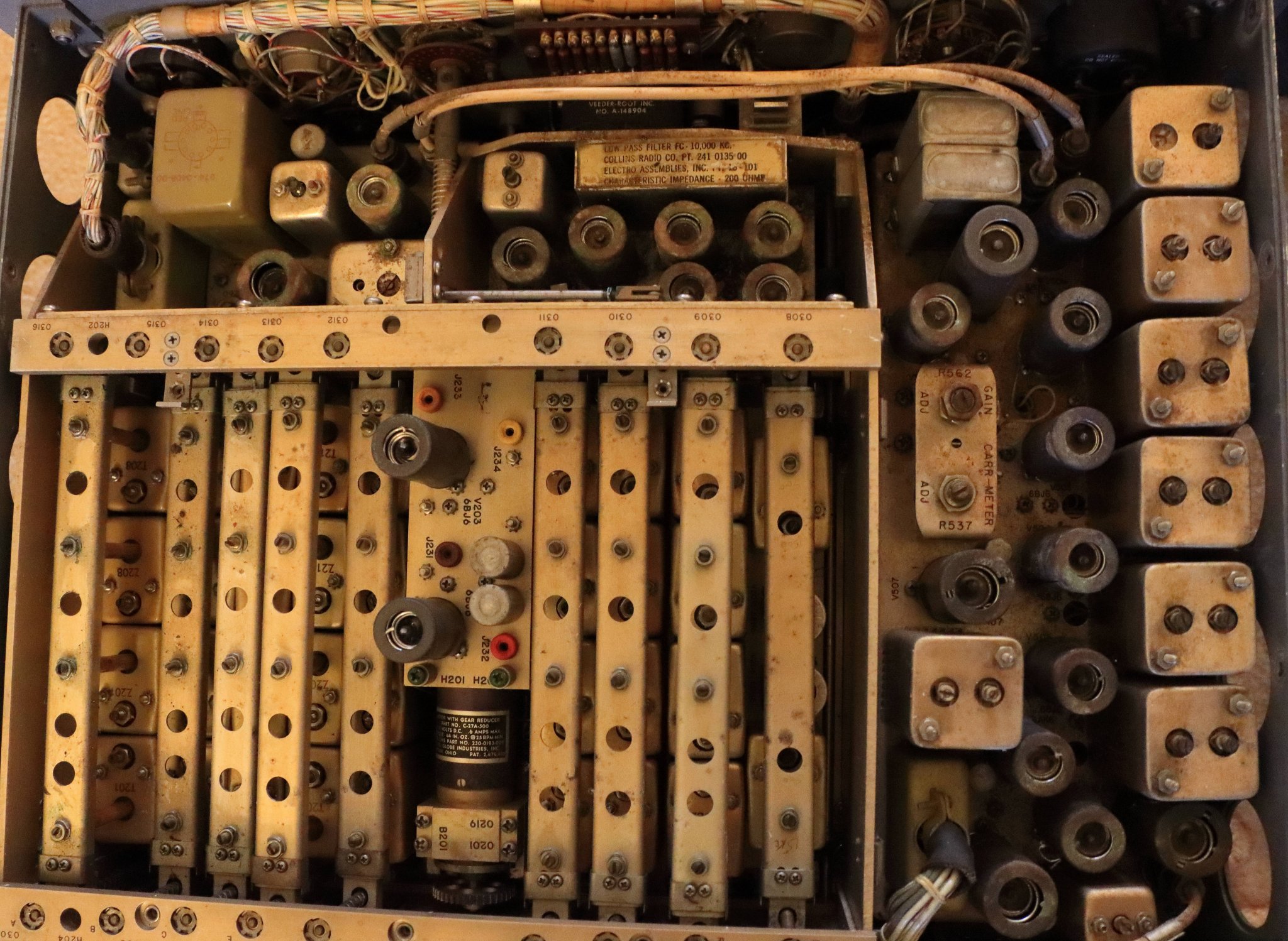

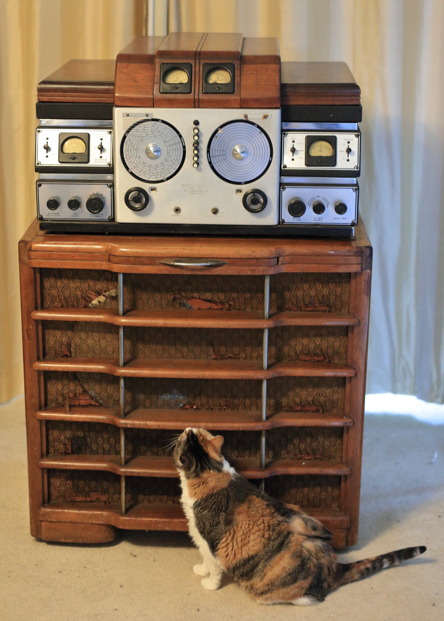

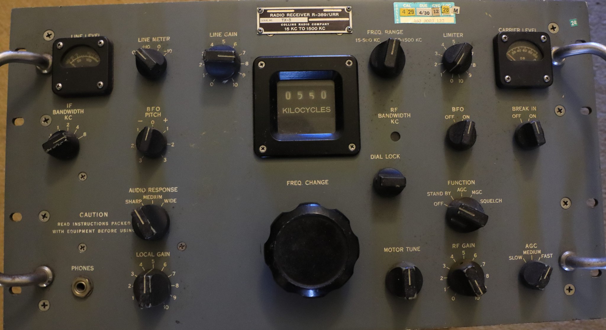

The little cheap SDR dongles are fun to play with but if you are looking for even a "semi-serious" wideband receiver, they aren't for you. The lack of front end filtering combined with the limited bit depth will quickly get you into overload and spurious response issues. To get out of the toy class, you have to move up the more expensive SDR packages.
Being a vintage gear type, I went the other direction although I do have a SDR based high end Yaesu transceiver.
