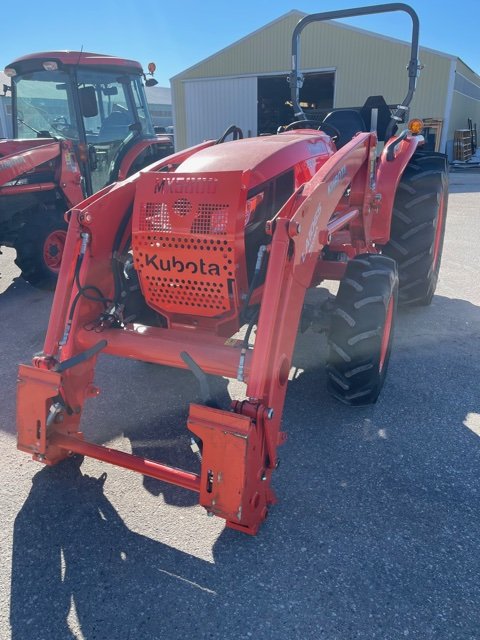

A lot of my tractor use is woodland, including grapple work. It's very easy to get damage from branches or timber on the ground, recently put a hole in the floor of my Ranger side by side from a stick laying on the track, tire flipped it up and it came through the floor!
I just fitted a grill guard on my MX5800, I saw them many months ago on here and it took me quite a while to track down Dawson who makes them. It was a simple install, just had to drill 4 holes 5/16" diameter. It did not come with hardware, you need 4 bolts 5/16" x 1 1/4", nyloc nuts, 12 flat washers.
There is a lot of expensive stuff behind that plastic grill cover on a MX5800! I then trailered it to my local dealer for an extra set of rear remotes to be fitted, getting ready for a busy time as soon as the snow and ice has gone.
I purchased another model for my L3901 which came unpainted from Lown Performance, I just gave it the first coat of paint. This 2 piece model came with a very nice "chin strap" lower piece which boxes in the space below the grill guard to give total protection from below, I will share photos after I have installed it.

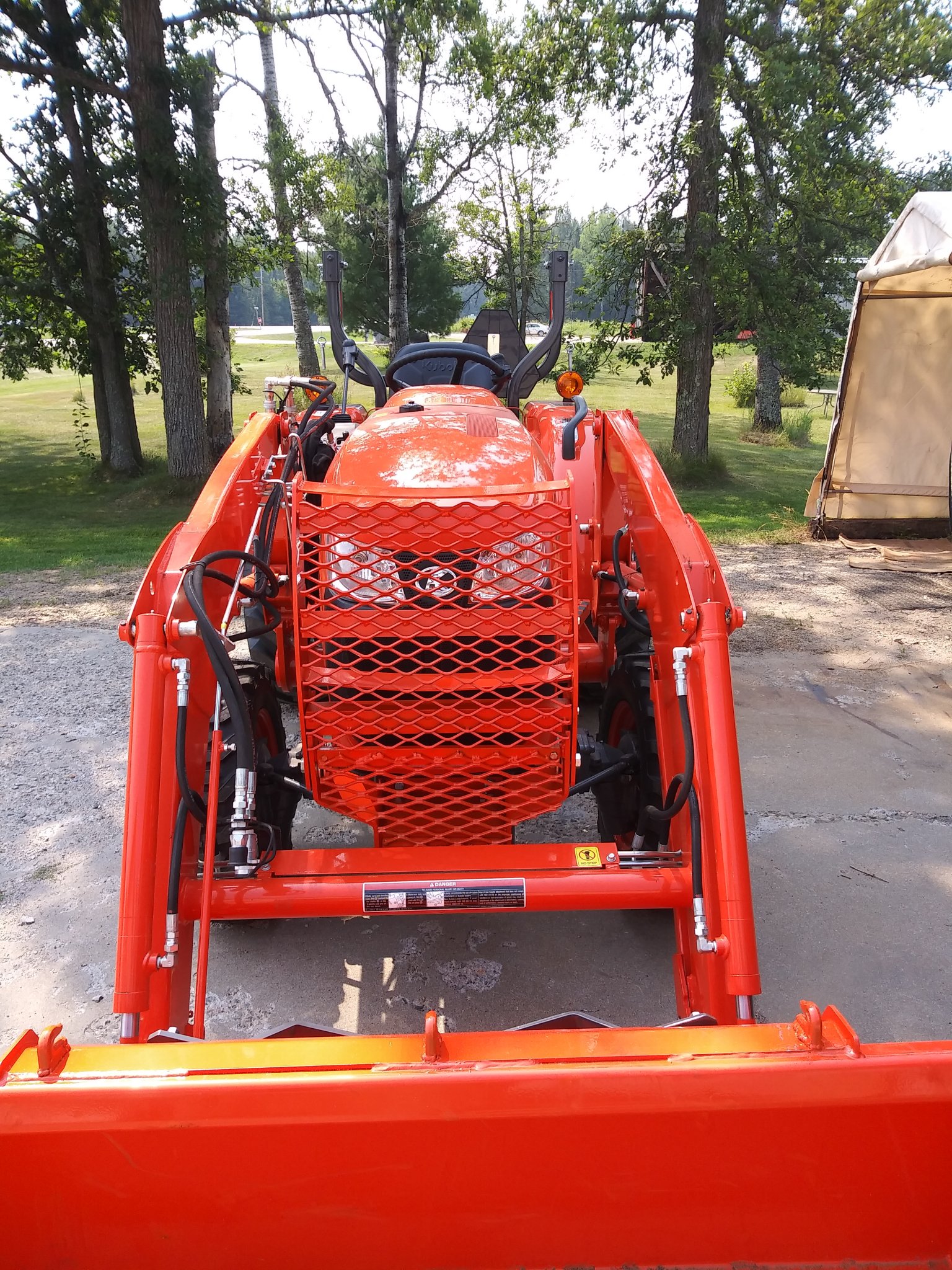

Nice I like it. Just bought one from superjet511, definitely piece of mind when using my grapple. Plus they look cool too 20210303_163149.jpg 20210303_163139.jpg

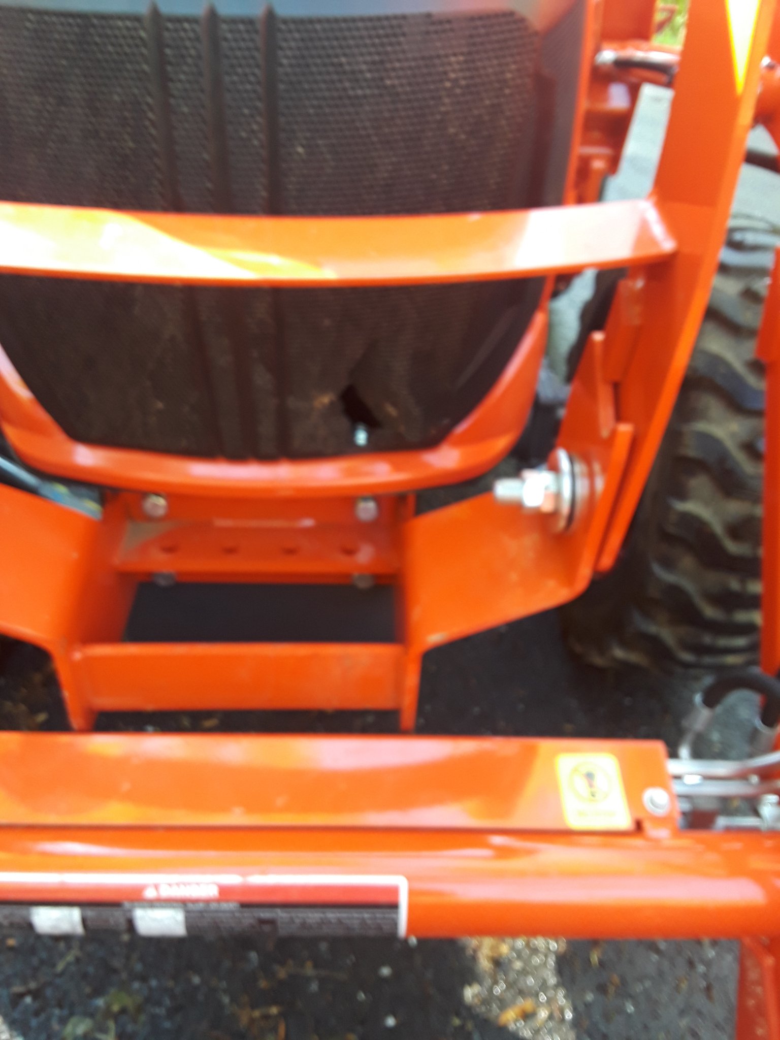

I just put a hole through my grill on my new mx5400... I will be getting a grill guard very soon

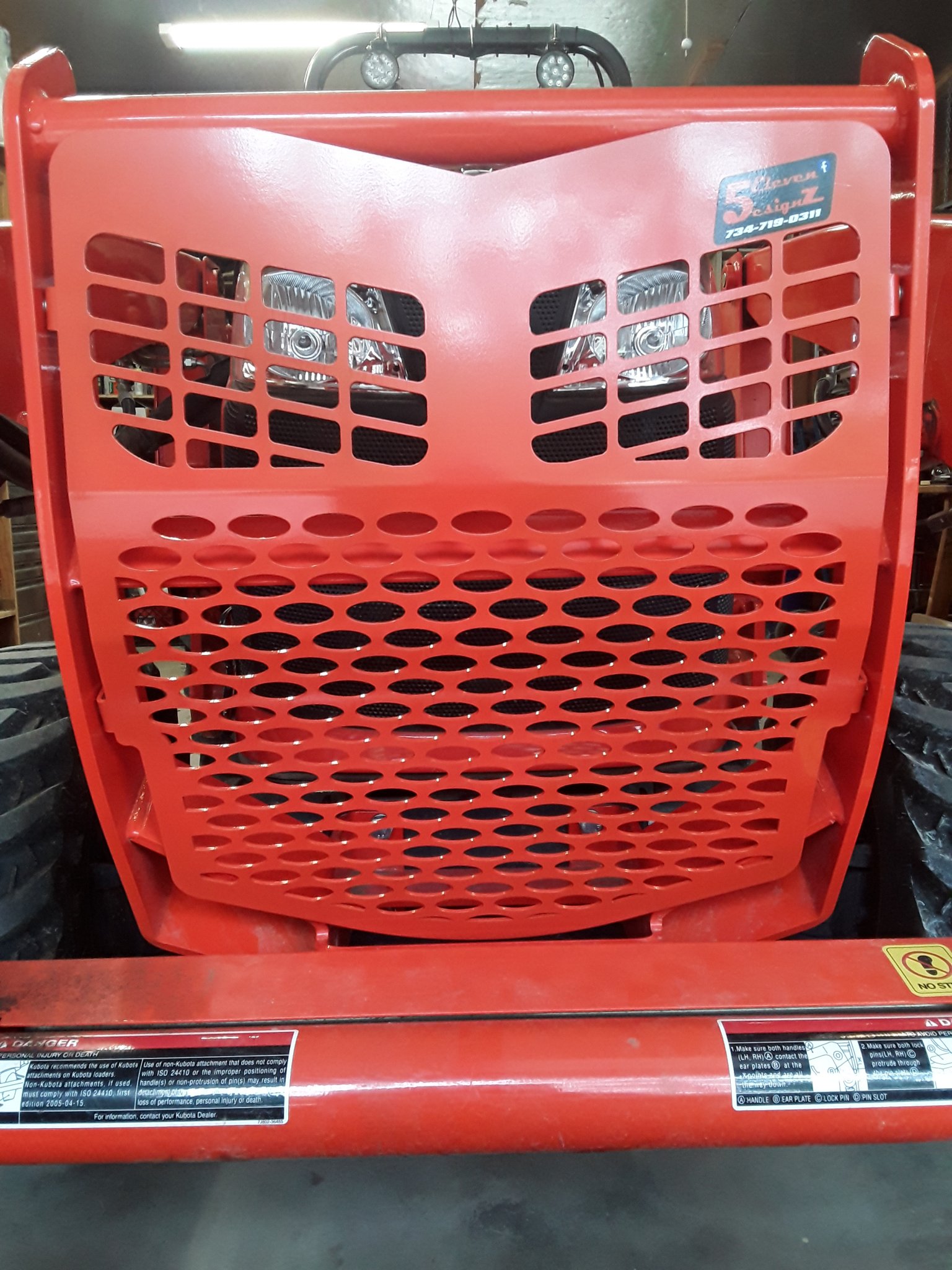

Just came across this while searching for other things. If you are still in need of a guard here is my website:
5elevendesignz.com
Have a great night!
Justin
Justin, you and others make some really cool grill guards but I'm planning on making my own. The local steel supplier doesn't stock perforated sheet but I can order it from them for a reasonable price. For those not interested in or unable to make their own grill guards they'd be hard pressed to find a better product than yours. :)
Took me less than two weeks to punch one in my new L3901. Kubota should be embarrased by the factory "grill guard". Not surprisingly Messicks has a replacement grill in stock I was preparing to roll my own from expanded metal/perforated sheet until I came across this thread.

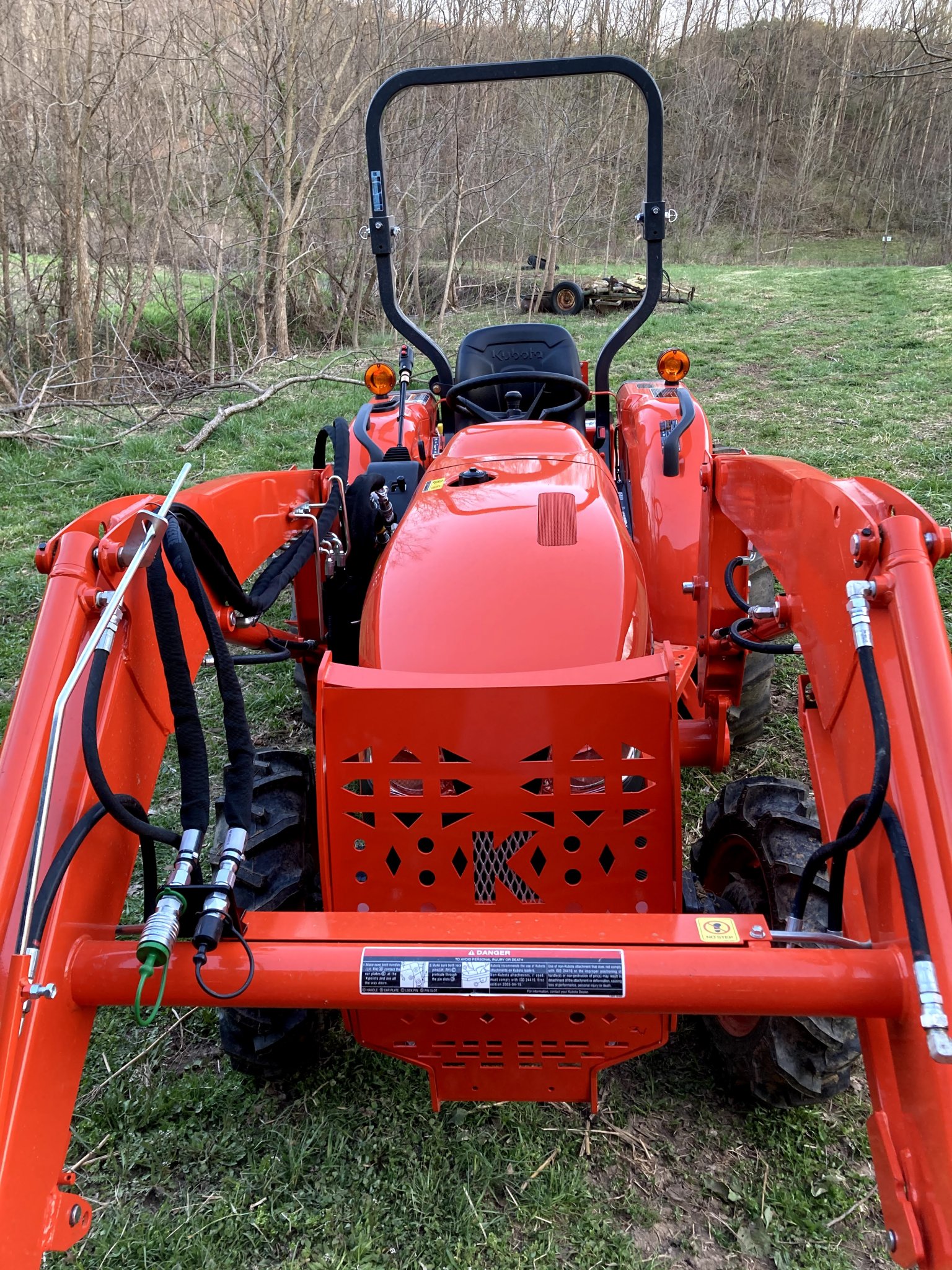

I installed a Grill/Chin Guard set on my new 3901 a few weeks ago. Got mine from Zooks Welding here in Ohio. He shipped it with stainless hardware, and I painted it up.
Last week it saved my grill. Guard took a nice scratch, but that was all...

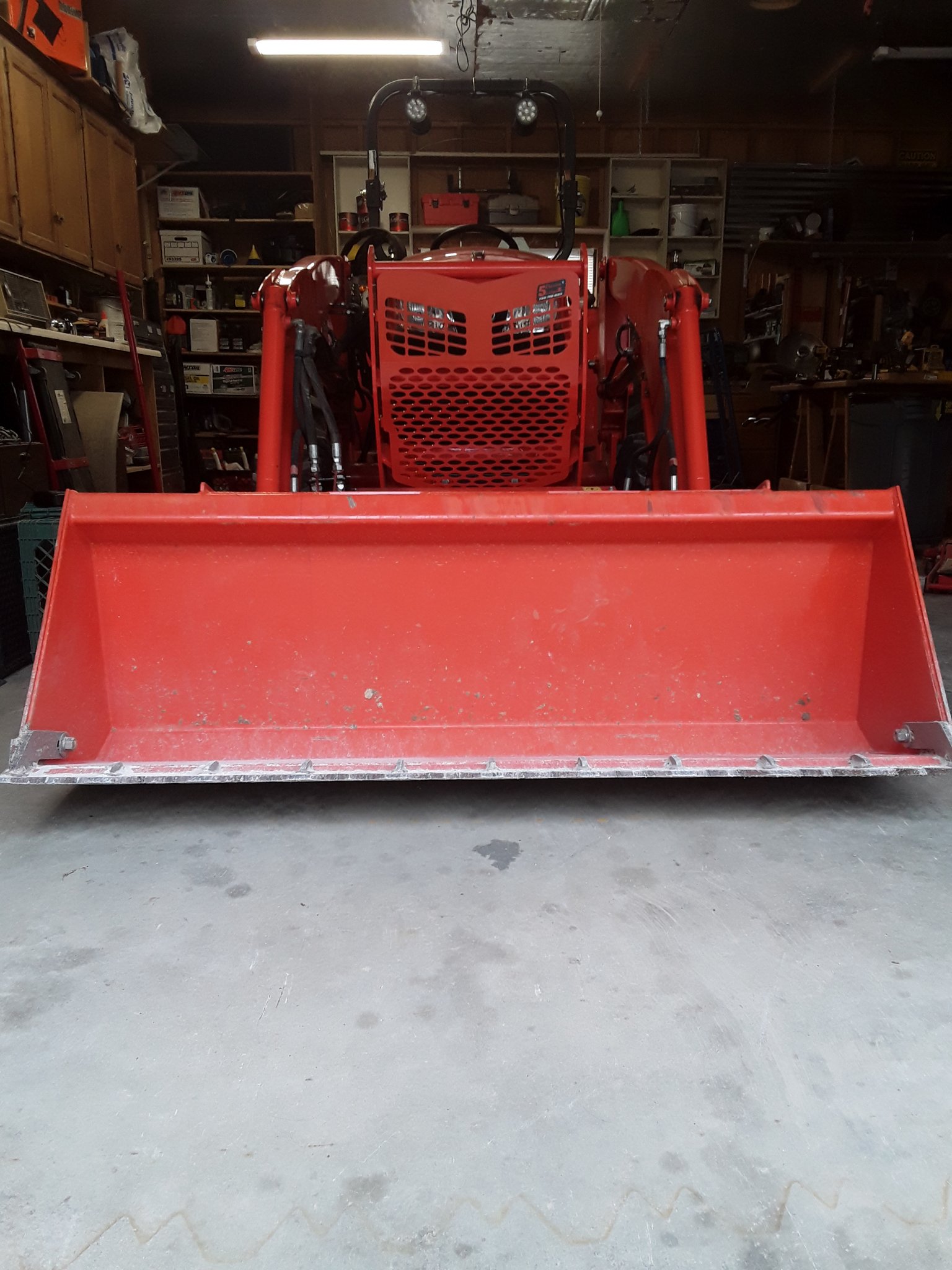

and have been reading a lot about how people have put sticks and branches through their grille. I bought some expanded steel for $30 and used some angle and flat stock I had laying around the shop. Took about 2 days and an extra day for paint to dry but this is what I came up with. Thanks for all the photos I used for inspiration. :)
