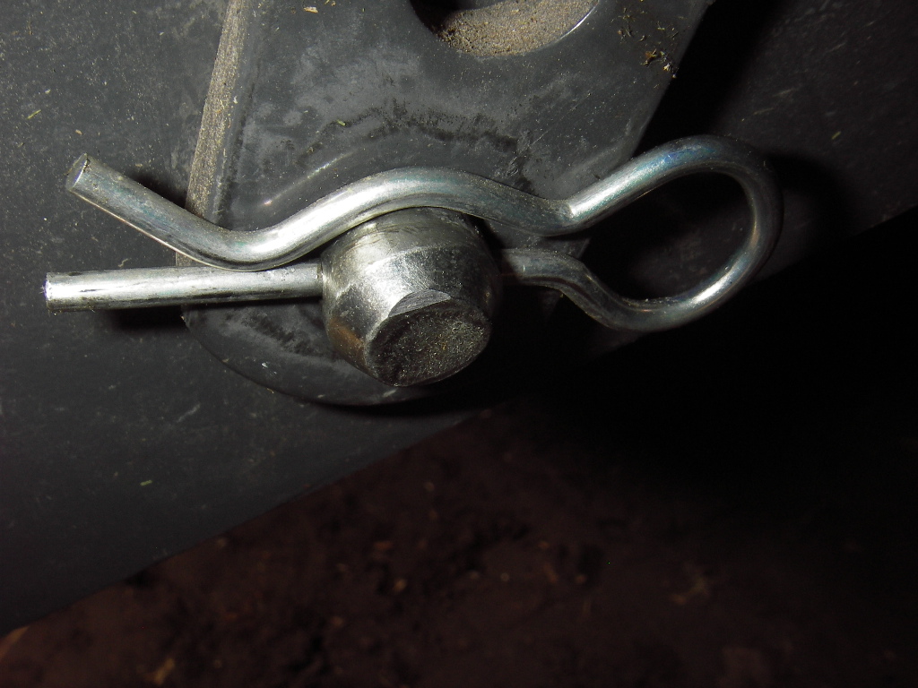

My Deere 955 manual calls for lubrication of the "ball joints" in the 3 point with clean engine oil at the 200 hour point. Given that I don't put a lot of hours on it, they get this attention every spring and have since I bought it in 1995
