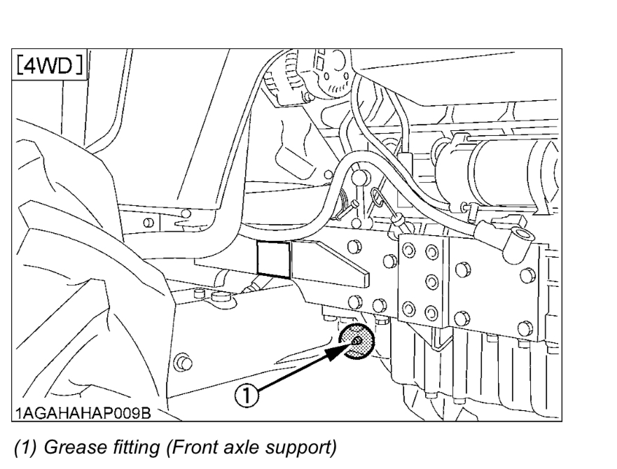

There is a Front Axle support grease fitting just behind the front axle in my MX5400 unlike the other grease points where I pump grease in until it squirts out somewhere else, where is this grease going? I have pumped and pumped but don’t seem to be able to fill up wherever it is going . Do I just keep pumping until no more goes in?

Nope. You should have stopped pumping about a tube ago. The grease is filling the housing around the front drive shaft. You can probably leave it, but someday you might have to deal with the mess. In the future, three pumps should be plenty.
You took the vent off the front zerk for the pivot point before you greased it? You should. And stop when grease comes out the vent

That is what I can’t understand. I removed the vent and nothing happened. There is another zerk on the opposite side of the vent ( very front, right side) and when you grease there, grease comes out the vent. But nothing comes out the vent when I use the zerk in the picture. Grease is definitely coming out of my grease gun.
I guess I won’t put anymore in!! Ha

If I'm understanding correctly....
One support has a zerk and vent.
The other has a zerk and no vent.
The two pivot points are not connected. So the vent is not for both pivots. The one with the vent gets grease until a little comes out the vent. Then plug the vent. The other only gets a couple 3 pumps because there is no vent.

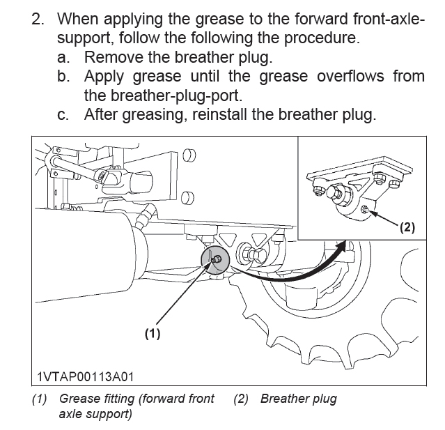

There is a Front Axle support grease fitting just behind the front axle in my MX5400 unlike the other grease points where I pump grease in until it squirts out somewhere else, where is this grease going? I have pumped and pumped but don’t seem to be able to fill up wherever it is going . Do I just keep pumping until no more goes in? View attachment 113875

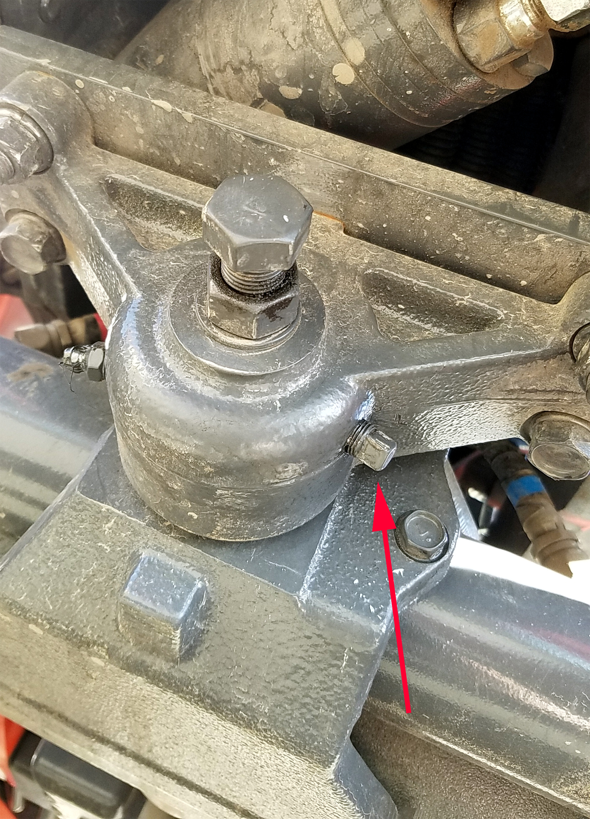

My MX6000 has a square drive plug that needs to be removed before greasing the zerk fitting at the front axle pivot point. The manual is clear about this as I pointed out a few years ago.
After removing it the first time, I ordered a socket that fits over the plug and it makes removal and installation a lot easier.
Yes that’s the forward front axle support grease fitting. On the back side of that there’s another one without a breather plug, and that’s the one I’m wondering about

What grizbota and evil twin said. Front has the plug you remove and pump until grease oozes from the plug. The back one has no vent, you just pump 2-3 times 4 if you must but that’s it. If you pump and the grease gun becomes hard to pump the zerk may be stopped up. It might need to be removed and examined or cleaned.

I've found that pipe plug has a 7mm square head.
May I ask where you found a socket that fits?
Thank You in advance!
You can use a 8 point socket. Technically not the right tool for the job, but it requires very little torque to R&R that little plug
If you want an actual 4 point, they are commonly called "pipe plug sockets". McMaster Carr has them individually

Remember this thread? 😂 @JoeR provided a link to a 9/32" 4-point socket. I ordered one from McMaster-Carr around the time that I started that thread.
