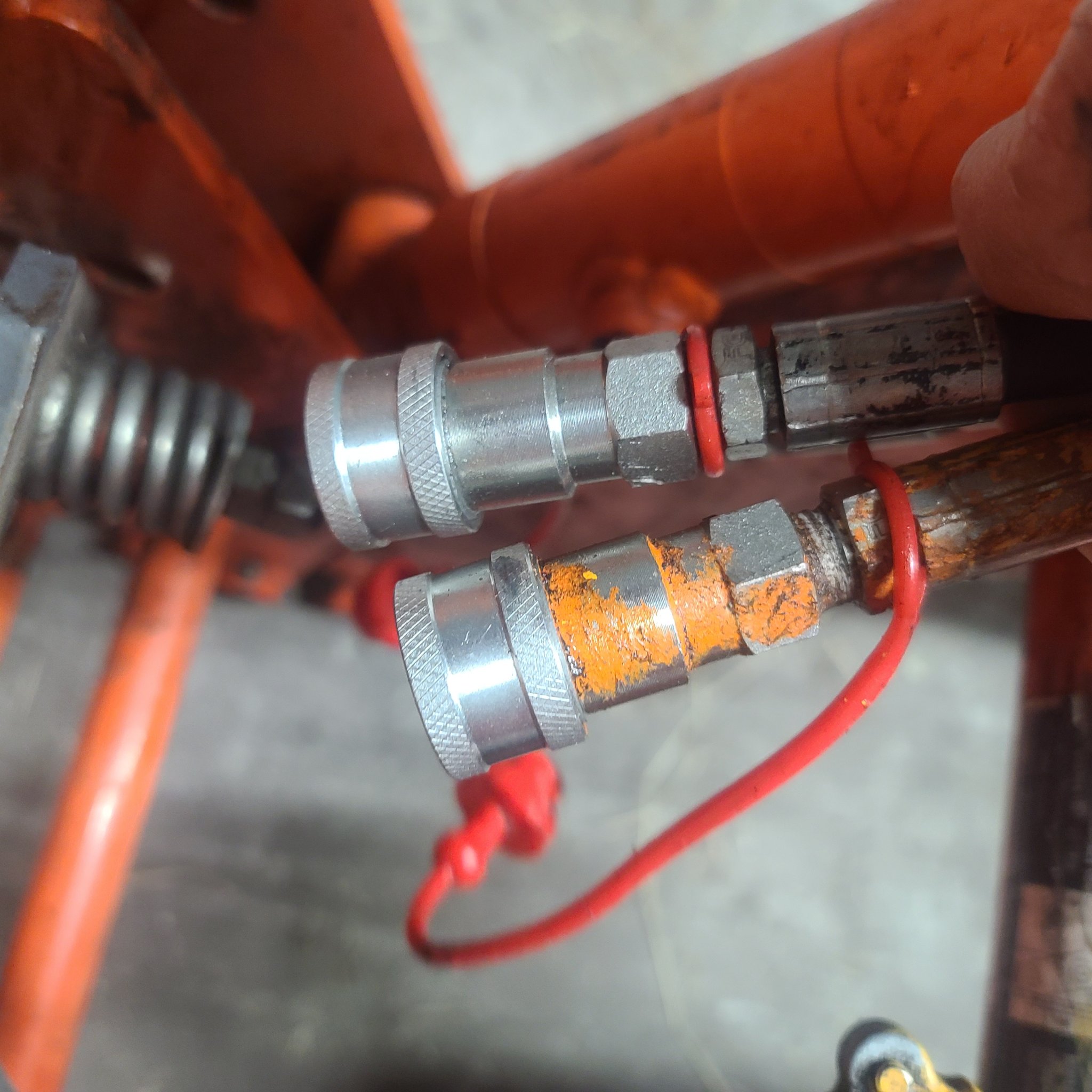

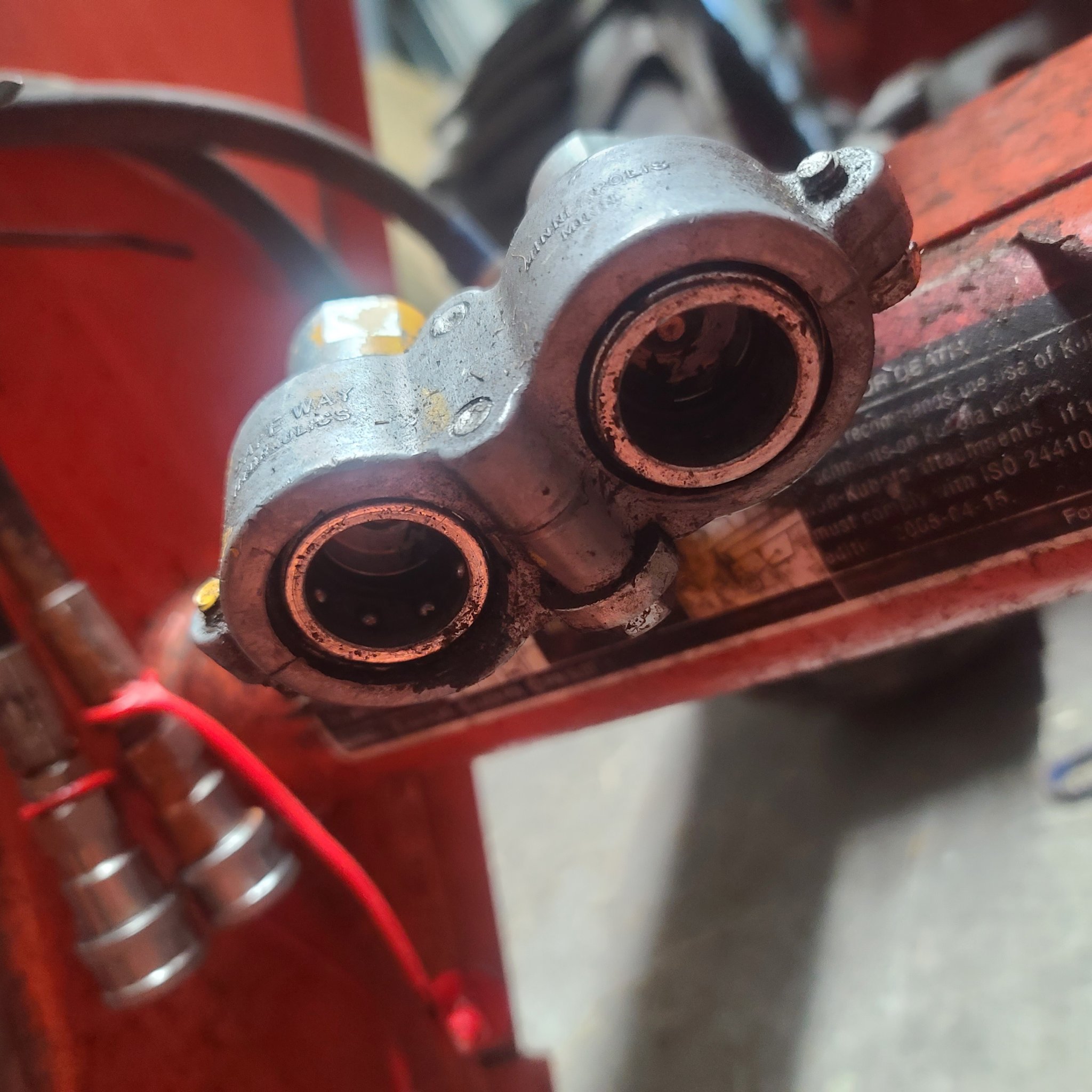

Quick connectors are notorious for doing what your explaining.
Try disconnecting and reconnecting and see if anything changes.
Try reversing the hose connections and see what you get.
I've switched connections numerous times same thing. Have changed hoses from another piece of equipment tried another cylinder from different grapple same problem.

Sounds like you've done everything except eliminated or bypassed the tractor side of the quick coupler, try that.

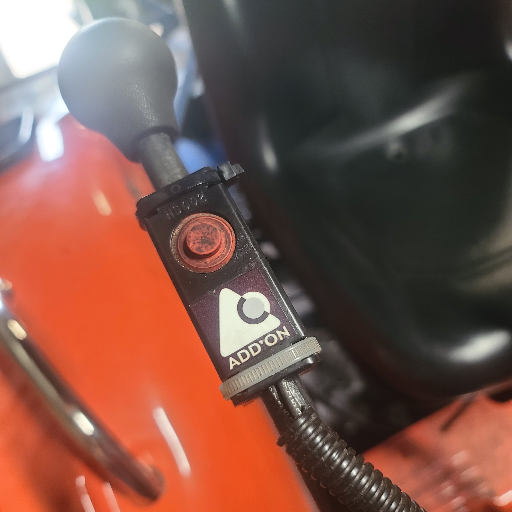

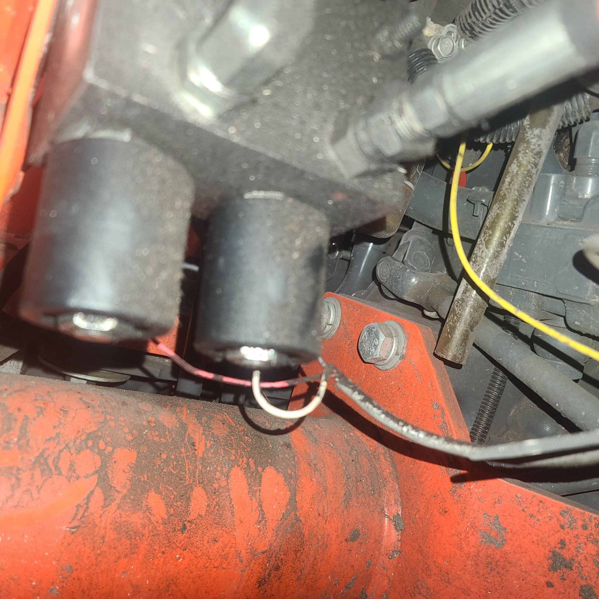

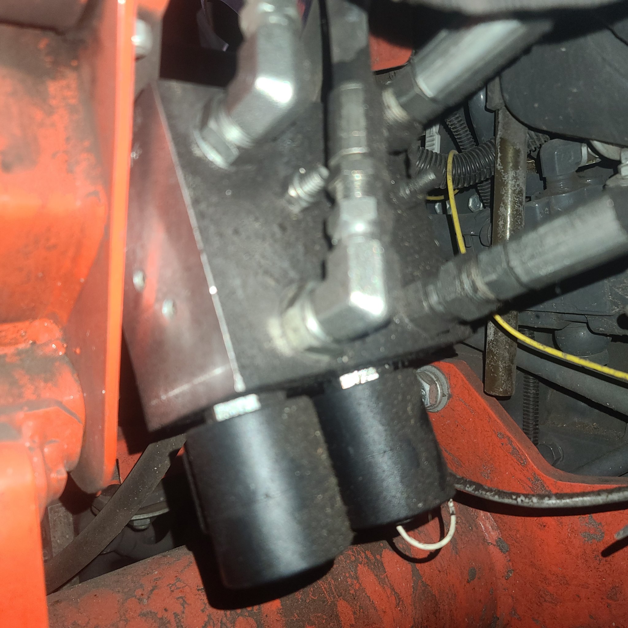

How many buttons on the joystick?
8,928
4,669
I thought so based on your picture and description of operation. With the button pressed the joystick handle is moved left/right to open/close the grapple. When the button is not pressed the joystick is moved left/right to dump/curl the grapple. Is this correct?
If so and it certainly looks like it from your pictures pushing the button should activate both solenoids. The solenoids activate two spools that switch the loader valve bucket work ports over to the lid cylinders on the grapple. With the button pressed can you dump or curl the grapple? If you can one of the solenoids is not working.

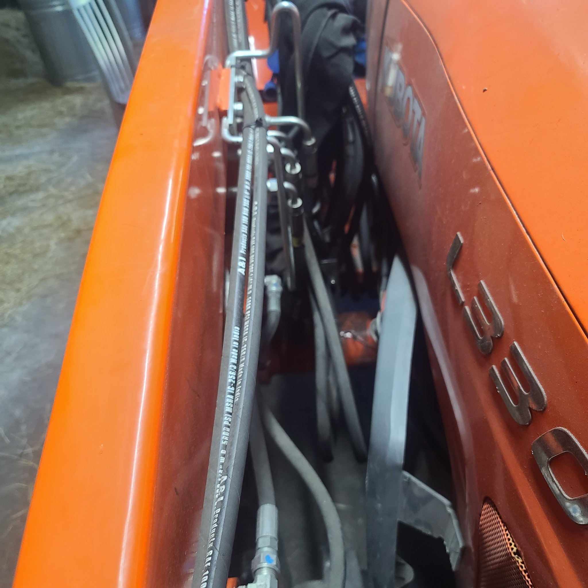

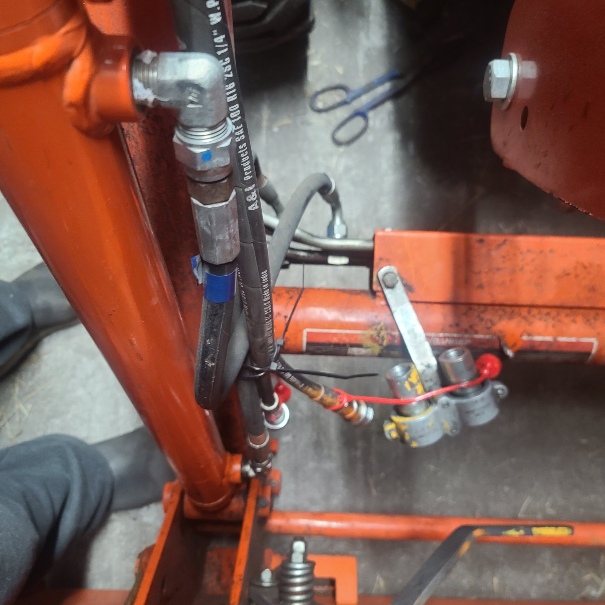

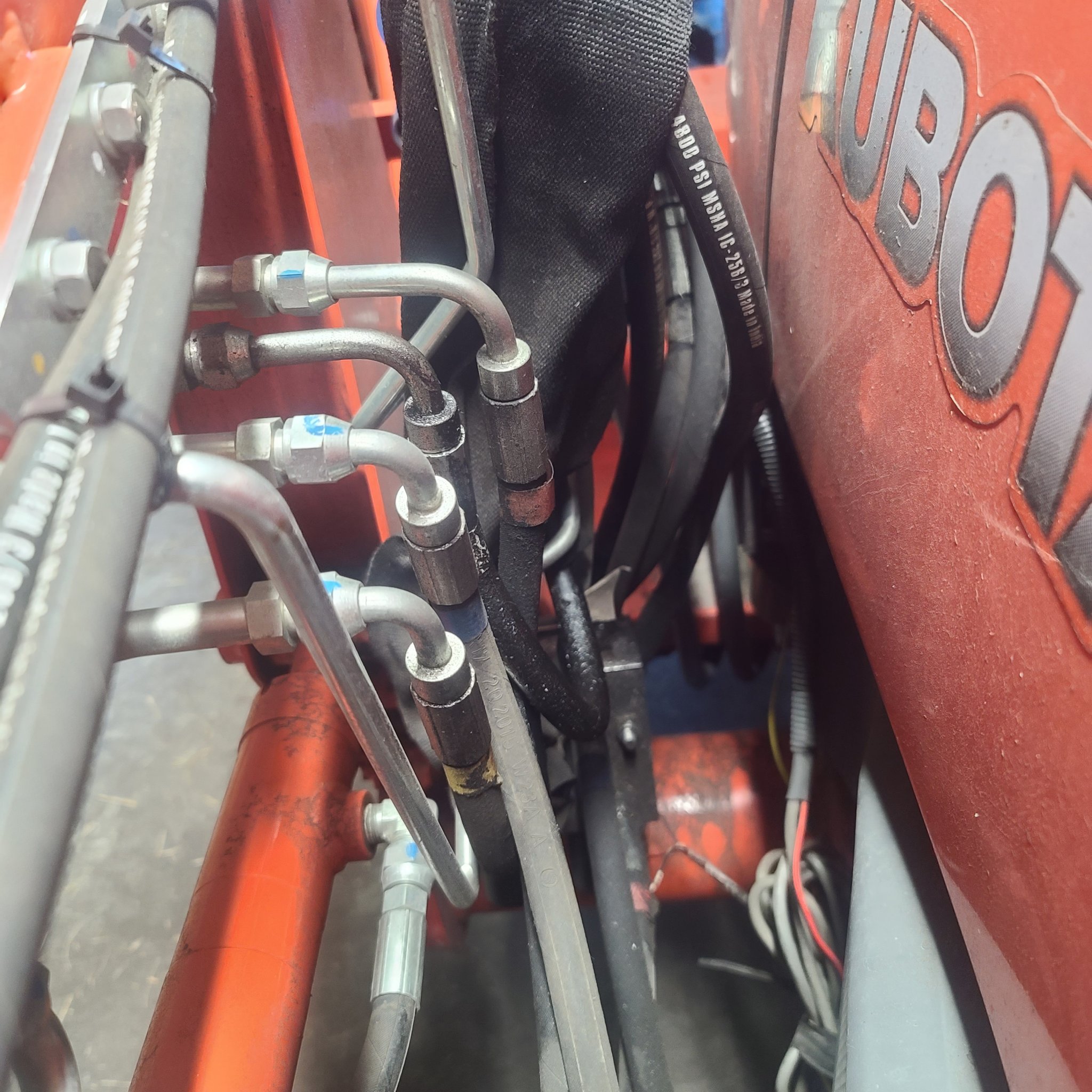

Please post a picture showing the entire right side of the loader from the joystick to grapple cylinders

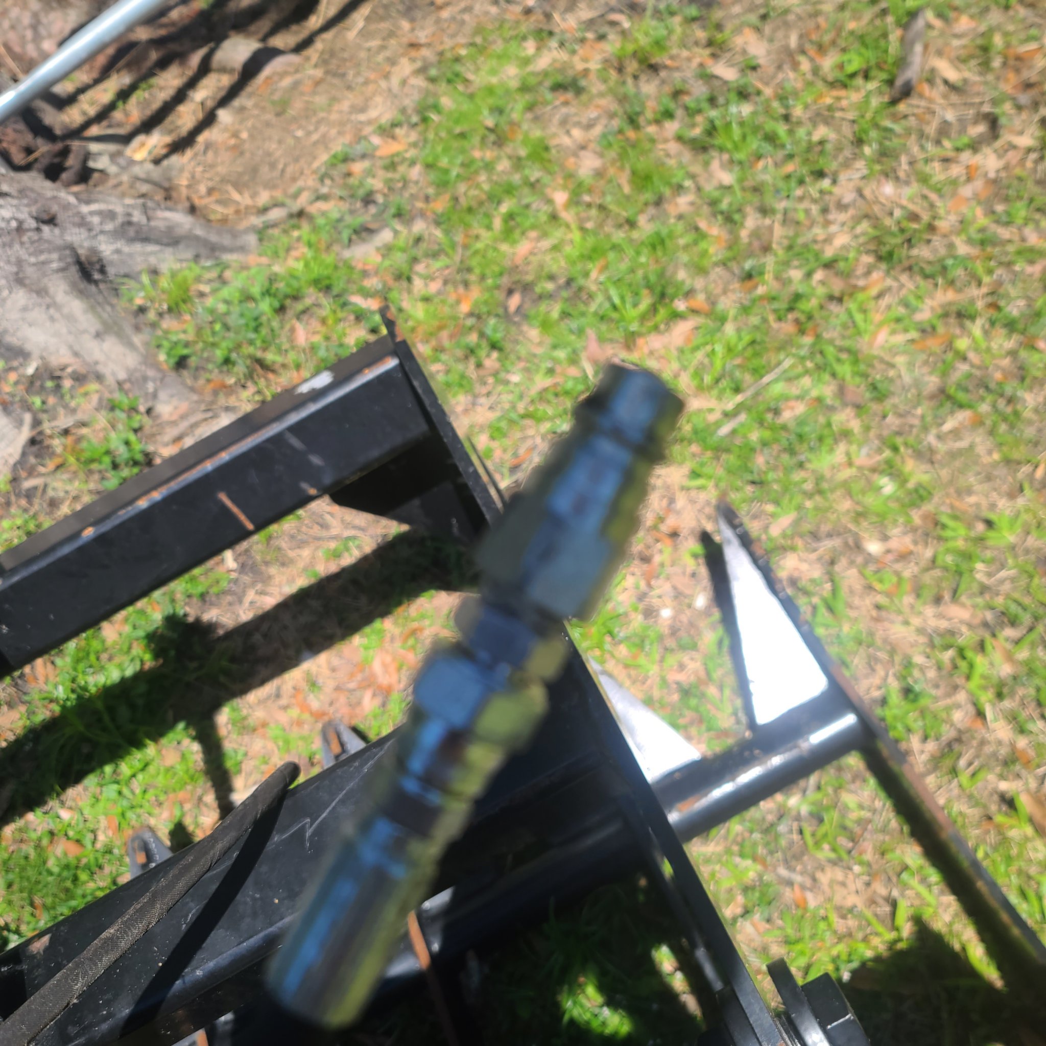

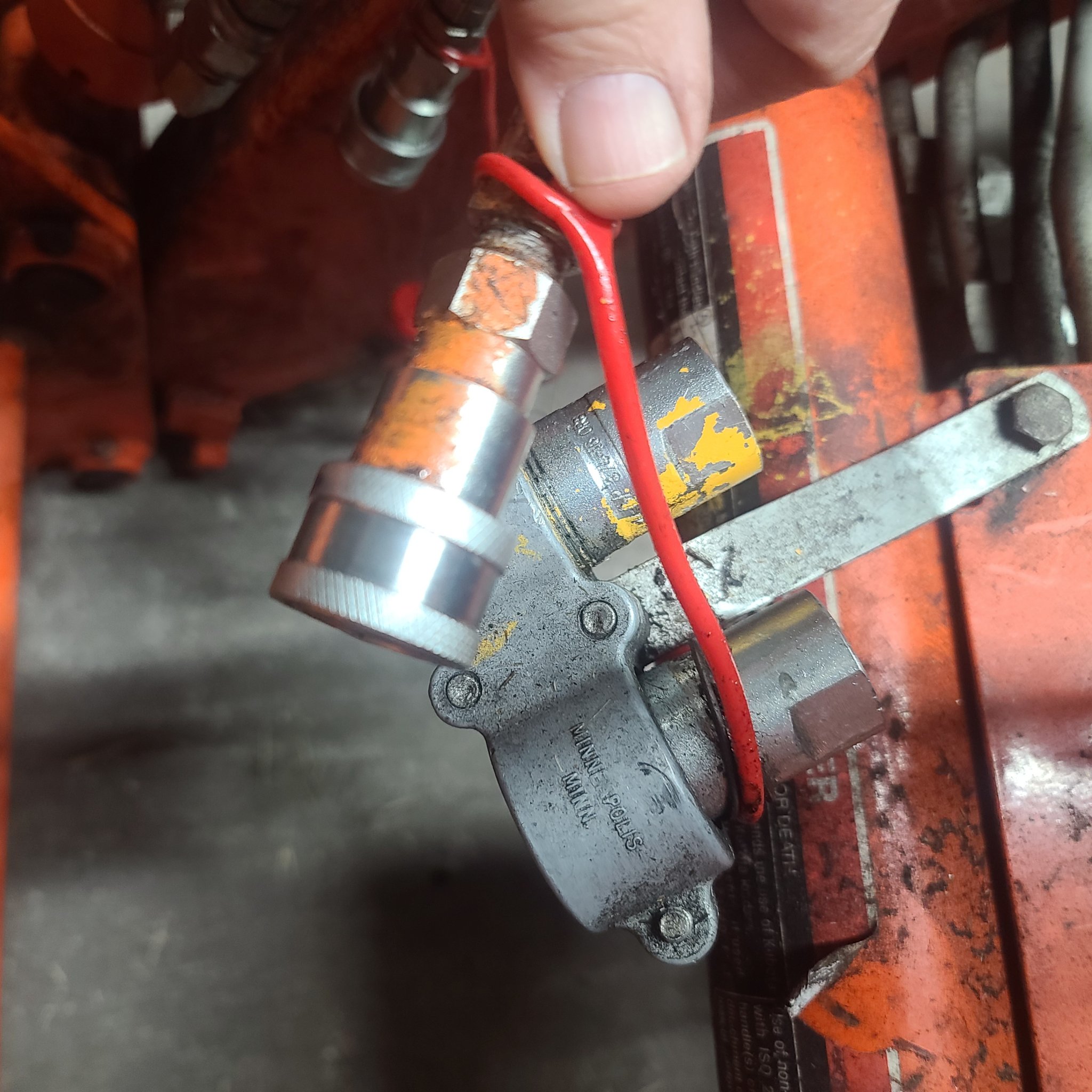

I'm thinking it may be what Wolfman said the fittings. It appears that the original Quick-Disconnect was 3/4 they left a broken Quick-Disconnect bolted to loader frame. Now the Quick-Disconnect appear to be 1/4 .
So if I wanted to put everything new as far as fittings and adapters and o rings and everything what sizes would you all recommend. The hoses are all in great condition.

If that is correct you you would have to have two couplers not working - one on the grapple tilt cylinder hoses and one on the grapple lid cylinder hoses. That sounds unlikely. I think something else is going on and I would positively identify the problem before starting to throw parts at it.

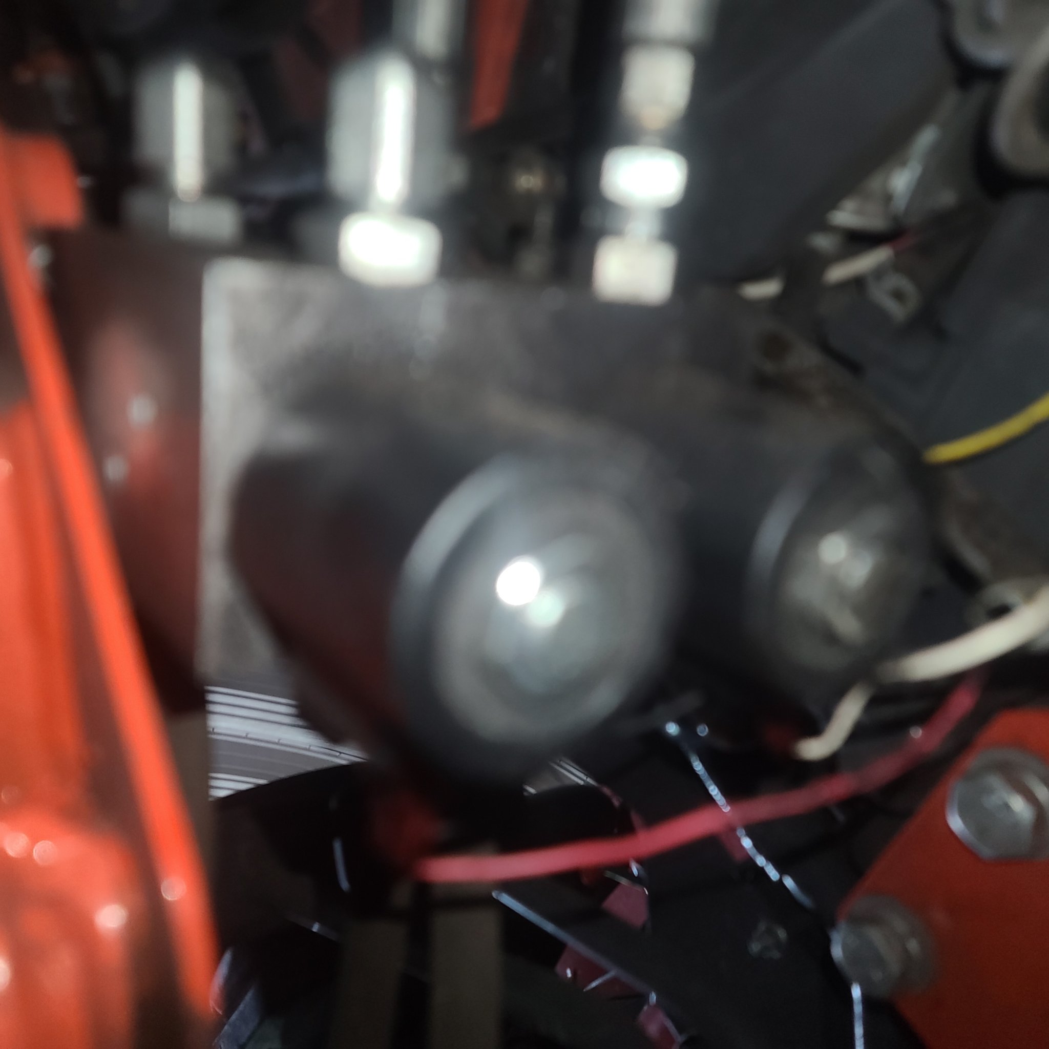

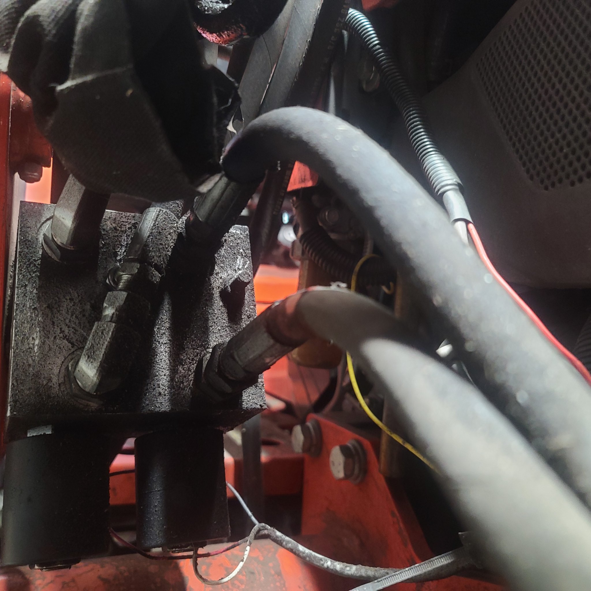

Think I need more info on the valve in this picture, how many lines are going to or coming from it?
Is it 4 or 6?
