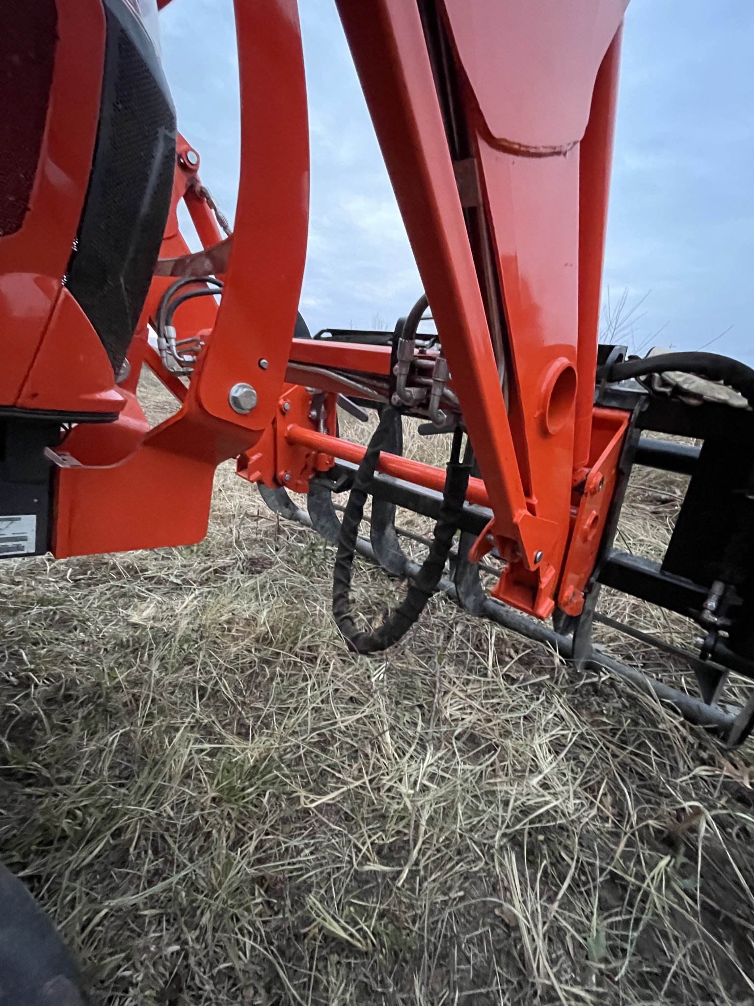

My 4701 has a Tera Force 8ft grapple installed by the dealer. I have had it for a little over a year but question the hose length that results in a droop. Concerned it will get snagged on a limb or stump. Any one else have one that doesn’t have this droop or confirm this length is needed?

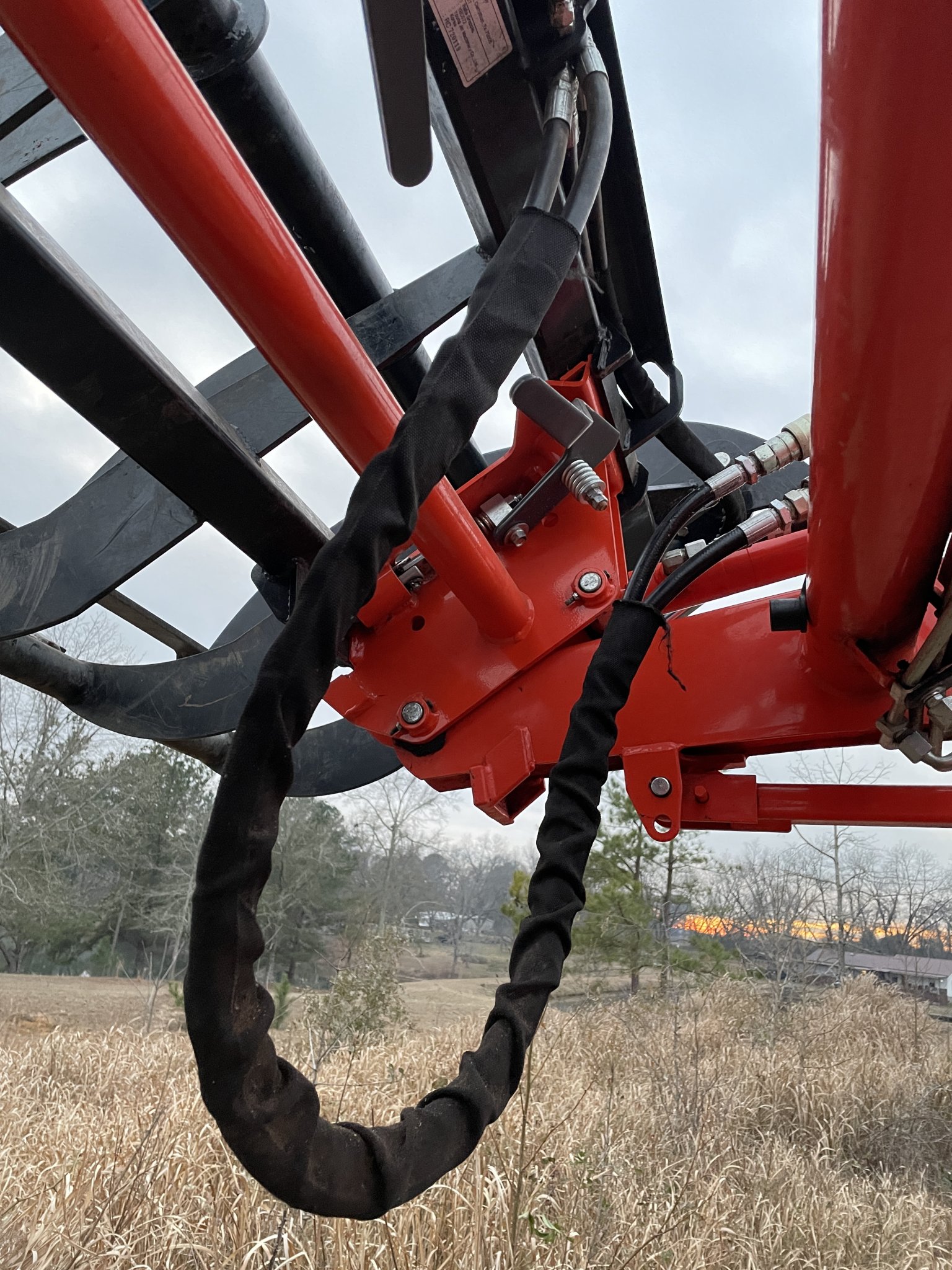

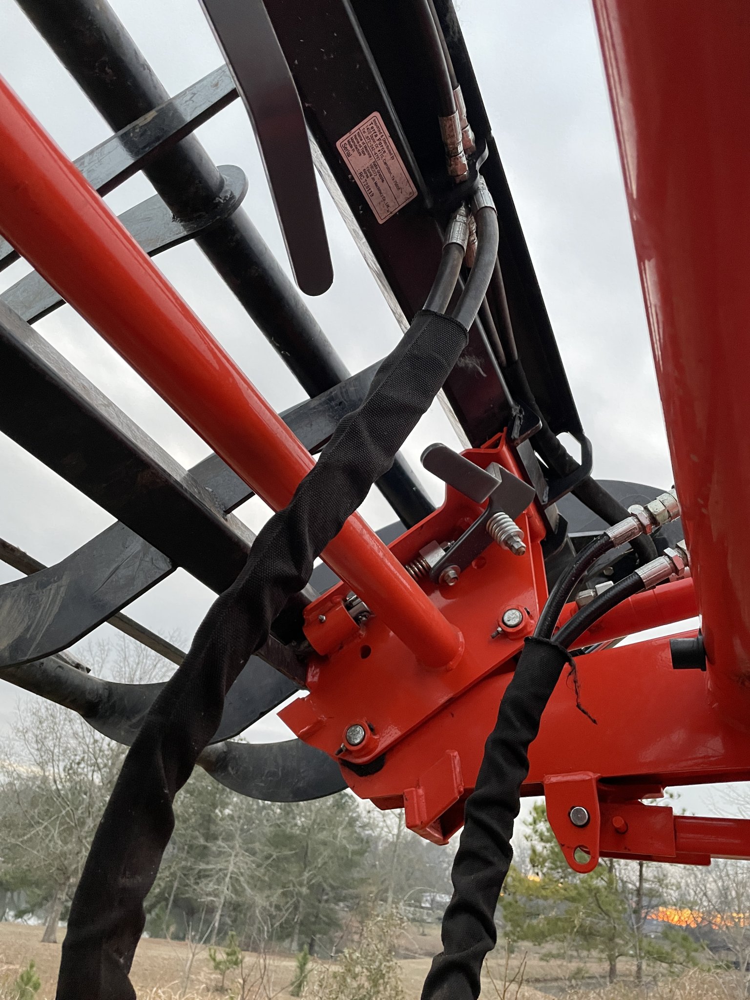

Wolf man is correct, Hold mine up with a heavy bungee cord 1/2" & will strech the cord about 8" to 10" when curled all the way down. Have made a plastic block to clamp around hoses to attach bungee & large hose clamp & 1 chain link on loader frame. Also crimped the wire hooks closed (On the second cord) Will get some pictures and post.

I used Velcro cinch straps on mine, at first it was a bungee cord but my nephew lost it some where.
