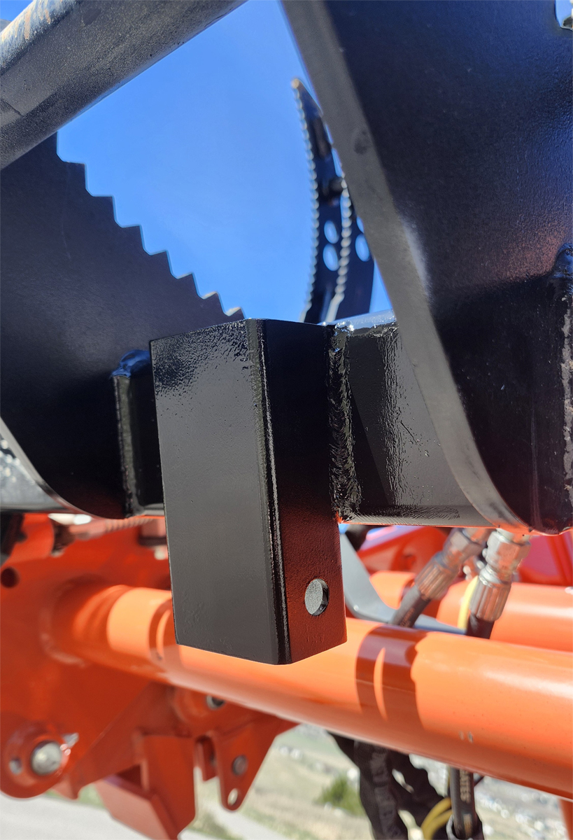

It's a pity that EA doesn't have a built in stand, but it's such an easy thing to add after the fact. It took me an hour or so to cut up some scrap material, drill some holes, weld everything up and paint it. I didn't want the stand to interfere with normal operation so I made it removable. Works great and makes it much easier to get the grapple on and off the tractor.
