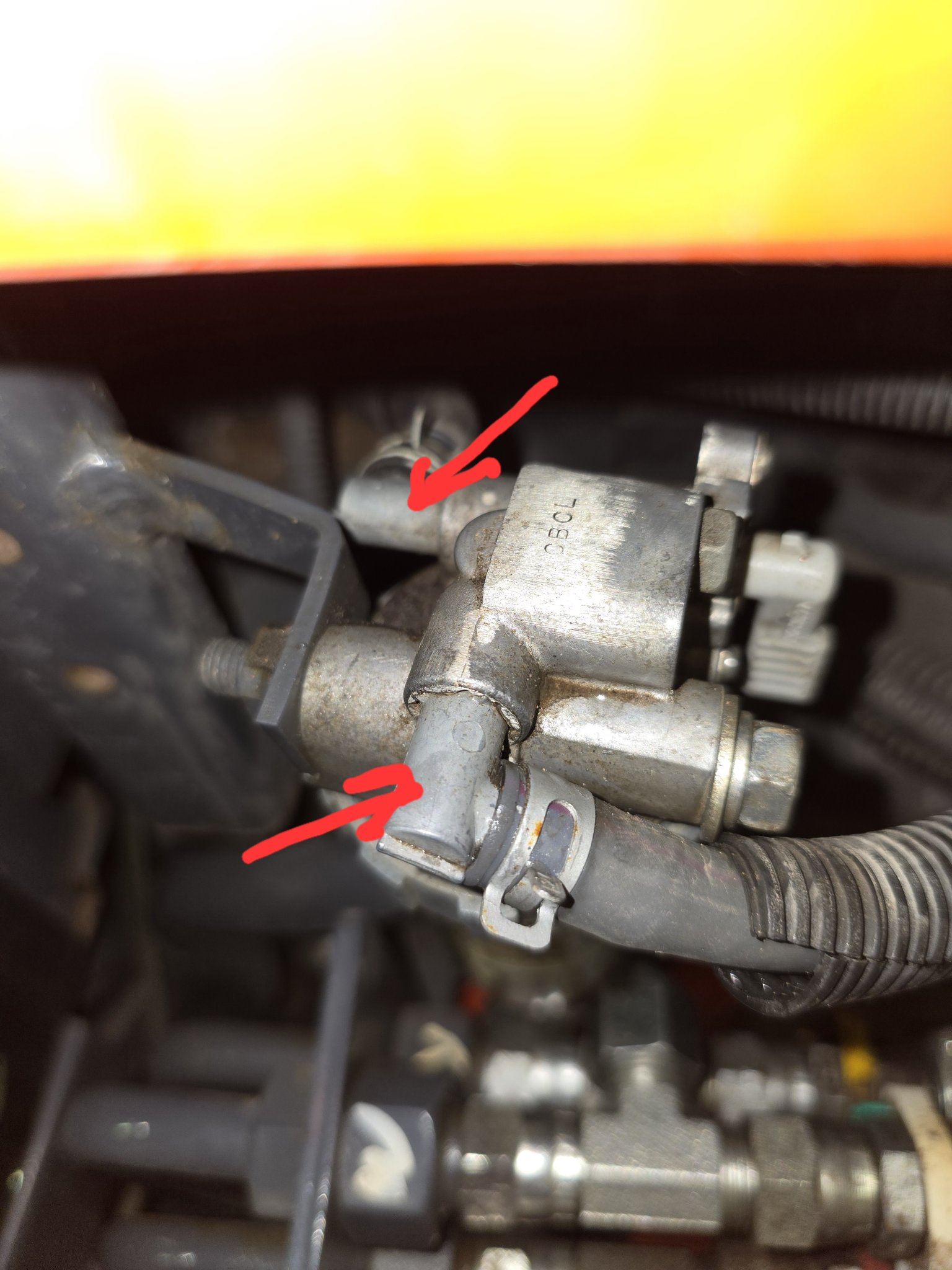

OK - so after a few false starts - I ran my tractor for about 45 minutes before it shut down again, I think I finally have come across the problem.
I was able to start my tractor last weekend and snowblow for about 45 minutes before it shut down again. Since then I was able to start it twice I think - both times it stalled within 1 minute.
Today the local Kubota dealer - Ginops of Alanson, MI stopped by. He quickly determined that no fuel was getting to the air bleed valve in the fuel filter because the 90 degree fittings in the water separator was blocked ..... dead flies.
I saw online that others had posted to check the 90 degree fittings, but I didn't see any in the fuel lines. For those less experienced than me - there's not many - it turns out that the 90 degree fittings are in the top of the fuel separator - not in the black fuel lines - I had looked. My service tech took the fuel separator off the tractor and cleaned the blockage - at least 2 dead flies in the 90 deg. fittings - and now the tractor seems to run well.
I have checked for these 90 deg. fittings before but could never find them -
Here's a picture - for those that may have trouble like I did -
If you have sudden "bogging down" of the throttle, check these, as others have said before.
Simply remove the fuel lines, - remove the water separator, and use a small screwdriver or something to clean them out.
When reinstalled, go through the procedure to bleed the fuel lines of course.
Thanks for your input.
I want to give a shout-out to my local dealer - Ginops Sales of Alanson, MI. Their field tech gave me his personal business card with his direct # so I can contact him at any time with any issues.
