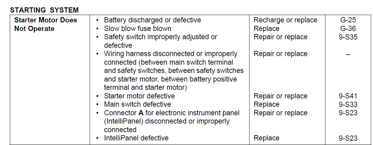

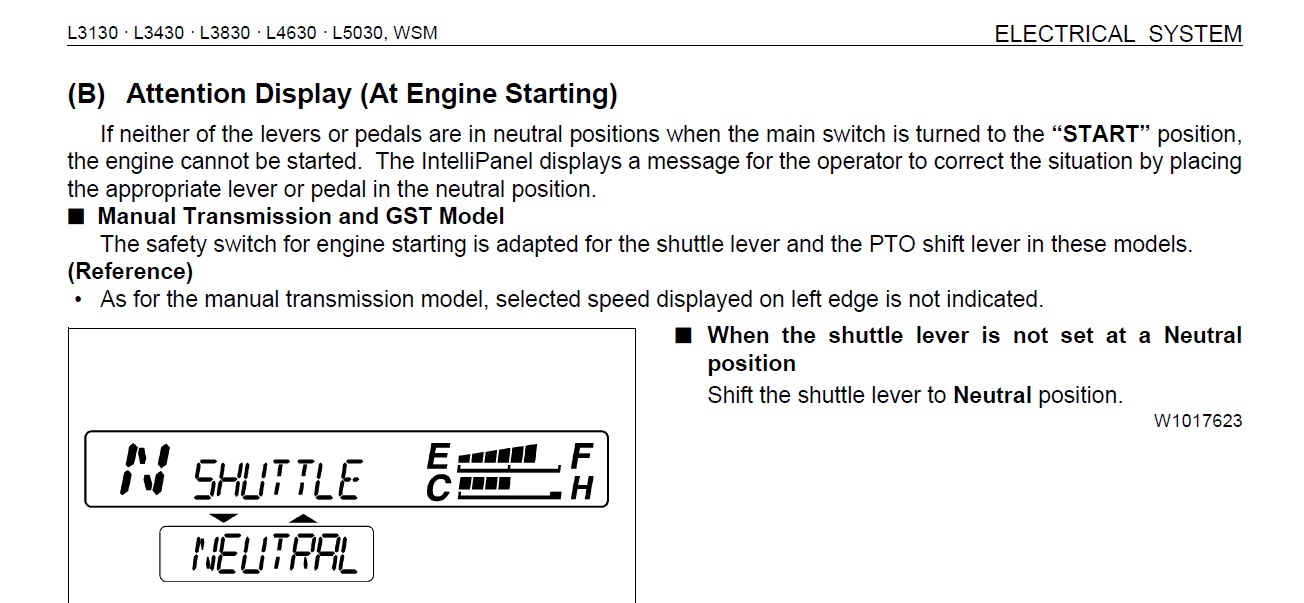

About four days ago I parked my tractor and yesterday I went to start it and it would not start. There was no clicking, no attempt to turn over no nothing. Everything else is working fine. All dash lights, head and tail lights, radio, heater fan, etc. The battery is only about 4 months old and fully charged. There is power going to the starter but no power going to the solenoid. I checked all fuses, including the slow fuses none were blown. A auto mechanic friend came over and we tried the hot wire trick. The engine turned over very fast and strong but would not fire off. Our thinking is that the hot wire is maybe bypassing the fuel (system) pump. That is just a guess! The dash lights say the glow plugs are working. The seat switch is working as far as we can tell and the PTO is turned off. I was blowing snow four days ago and turned off the PTO, backed into the tractor shed and shut down the tractor.
Any and all help is needed. It's suppose to start snowing Thursday night and snow for several days.
