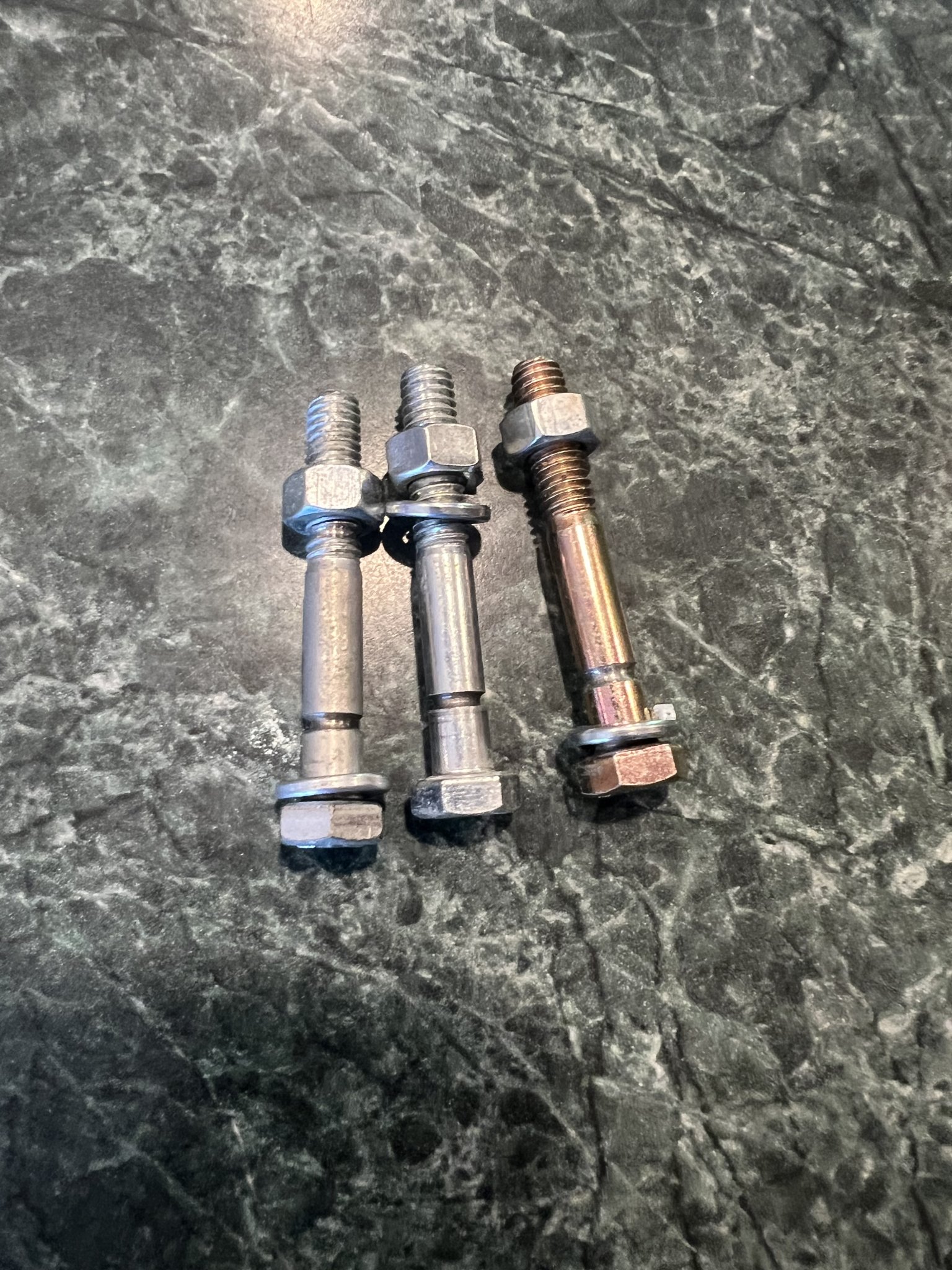

Just my snowblower model BX2750D, but they're grooved OEM shear bolts for mine.
Look like a grade 8 (right) for the impellor, and two grade 2 or 5 for the auger.
Not sure that's what you want for your application.
I can be as wrong as the next guy. I have never seen these grooved "shear bolts".

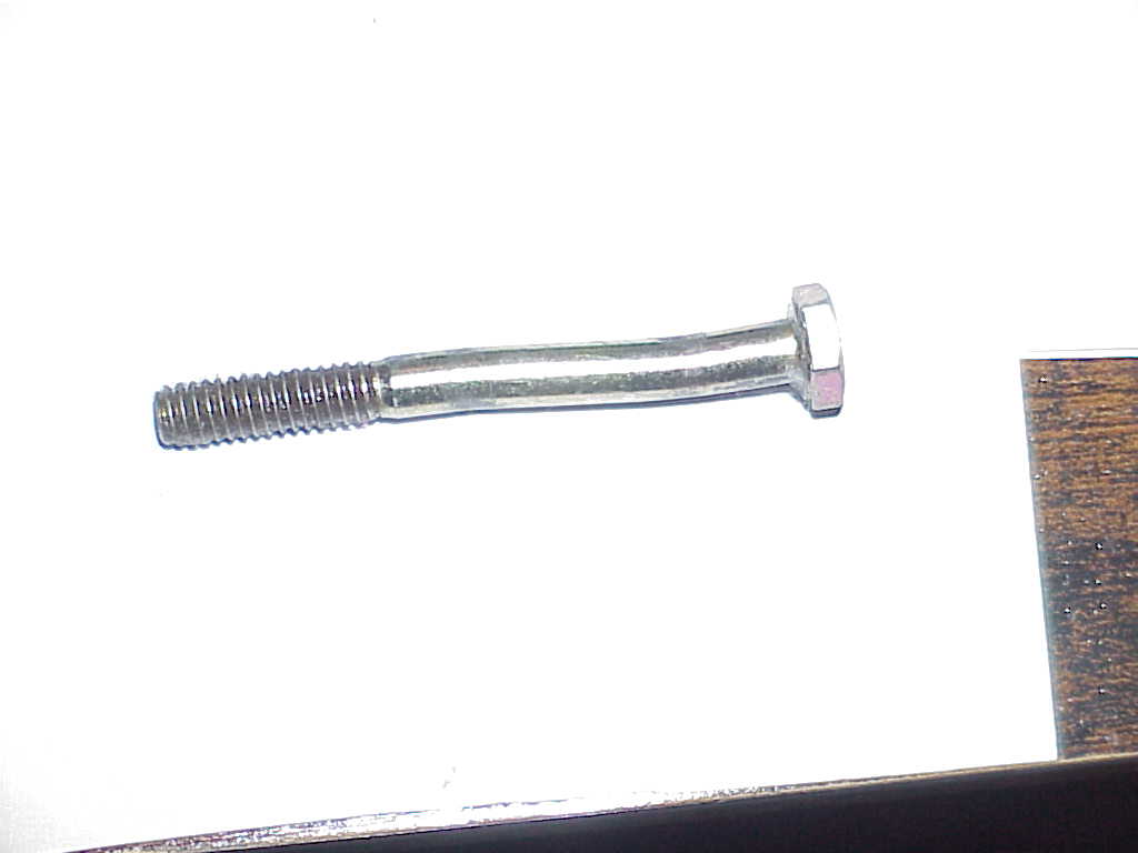

The bolt didnt break it was just a bit loose so I snugged it up. I was just thinking that it'd be good to have a spare. I took it out for a look and it just appears to be a standard hex bolt. There aren't any precut grooves in it.

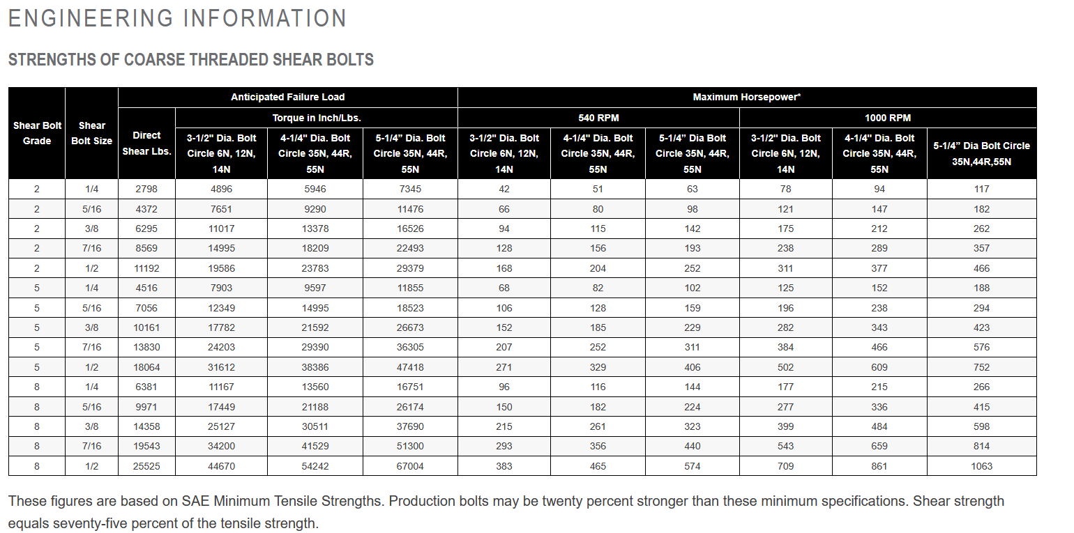

Shear strebgth is proportionsl to cross sectional area in shear. All the groove does is reduce the cross sectional area thats in shear.
The most common engineering formulas for calculating shear strength of steel fasteners are .5 or .55 x yield strength. So its easy to calculate the shear strength of any grade bolt with or without the groove. You can make a grade 8 bolt shear at the same load as a grade 5 by cutting an annular groove of the appropriate diameter at the shear plane. That groove MUST be coincident with the shear pIane or it has no effect.
