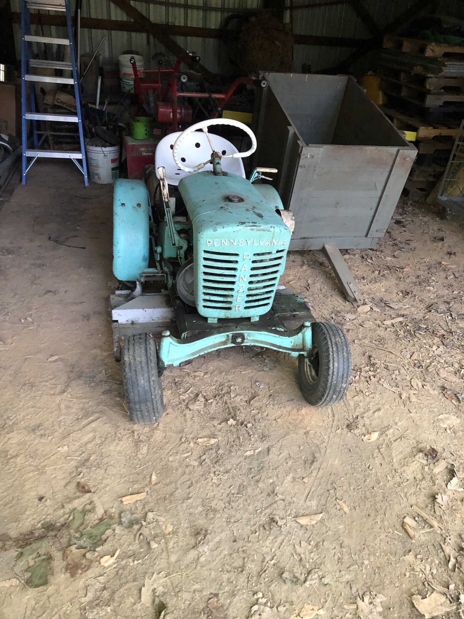

I have done similar with this thing and a 1000lb boat putting it in and out of our pond. Used it prior to obtaining the Mule and L.
It’s a whopping 9HP 1950 something and it’s 2WD (the GR’s we saw at the dealership when we bought our T recently we’re all 4WD) but it has an old car axle under the back, R1 tires, and the front grill is a casting that weighs probably over 100lb by itself. Used it because it was too tight an area to use a truck, brakes work well on the Panzer, and brakes on the 9N were likely to result in the whole rig going into the pond. Despite significantly more HP, I seriously doubt the GR weighs any more than this thing, turf tires aren’t going to pull as well as R1’s on dirt/grass, and HP isn’t the question: THE question is how much torque can the machine apply to the ground. 2000lb boat hooked to a GR on a slope with a bunch of water at the bottom? I wouldn’t do it. If I did take a wild hair and try it, the rig would be roped/strapped/chained to a large vehicle or fixed object such as a tree with slack set such that if it got out of control it would be stopped before everything including the operator went swimming being that’s the most likely result.
I now much prefer to use the L or Mule to put the boat in and out of the pond.
For 2 times per year, I might put some thought into possibly putting front wheels on the trailer via one of those manual trailer mover things and rigging up a portable winch to winch it into place after getting it close enough with the truck. Don’t know the specifics of your layout; just a thought.
View attachment 115835 It’s a whopping 9HP 1950 something and it’s 2WD (the GR’s we saw at the dealership when we bought our T recently we’re all 4WD) but it has an old car axle under the back, R1 tires, and the front grill is a casting that weighs probably over 100lb by itself. Used it because it was too tight an area to use a truck, brakes work well on the Panzer, and brakes on the 9N were likely to result in the whole rig going into the pond. Despite significantly more HP, I seriously doubt the GR weighs any more than this thing, turf tires aren’t going to pull as well as R1’s on dirt/grass, and HP isn’t the question: THE question is how much torque can the machine apply to the ground. 2000lb boat hooked to a GR on a slope with a bunch of water at the bottom? I wouldn’t do it. If I did take a wild hair and try it, the rig would be roped/strapped/chained to a large vehicle or fixed object such as a tree with slack set such that if it got out of control it would be stopped before everything including the operator went swimming being that’s the most likely result.
