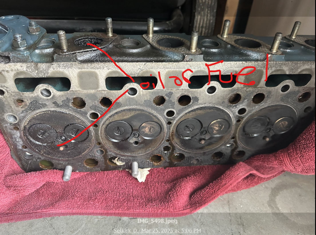

Bad or stuck rings or bad injectors.
Excuse my cartoon writing, in a hurry

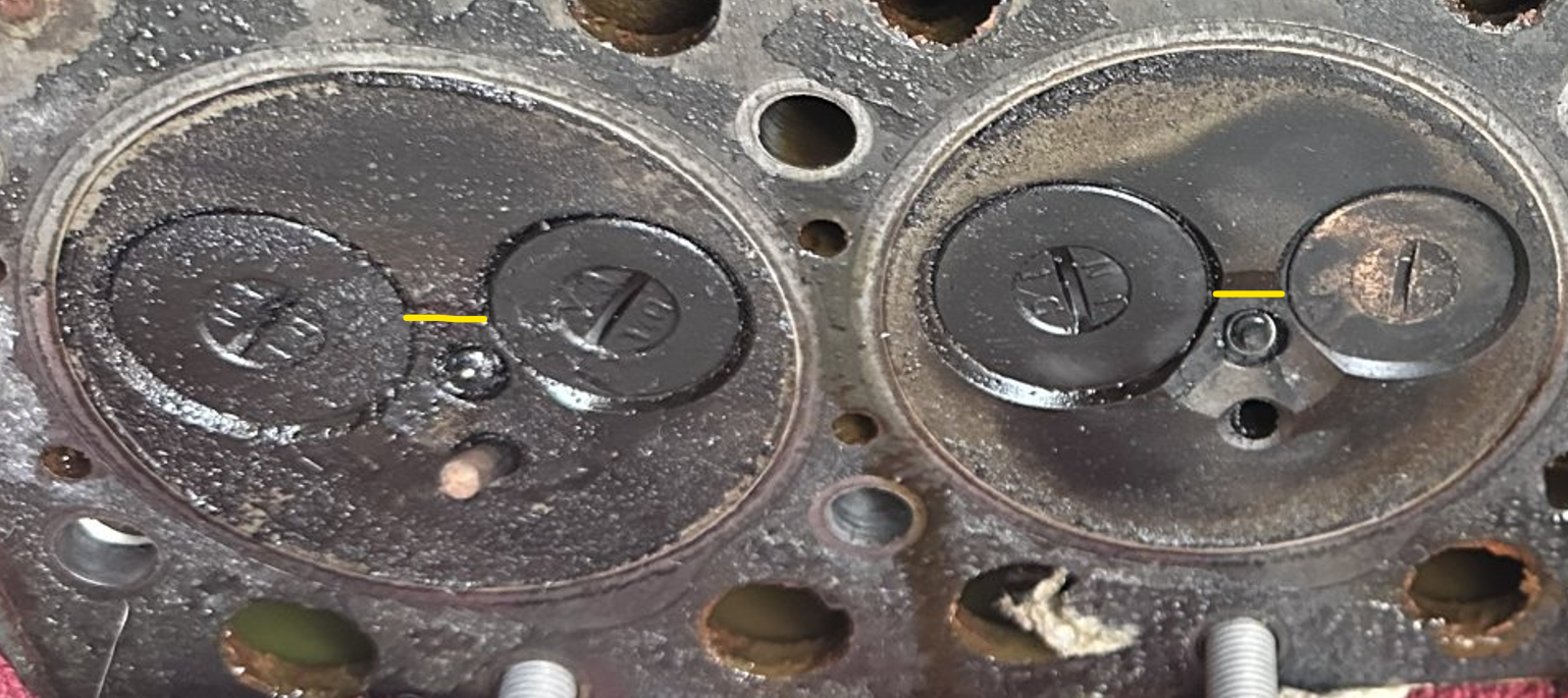

Can you send pics of the cylinders? I would try to avoid mulling the pistons unless absolutely necessary.
I would clean, disassemble and inspect the head before going further. It looks you may have a cracked head between each of the valves but you need to inspect them closely. See below

I think that is just an optical illusion even though they look wet. There is a depression there for the injector.
