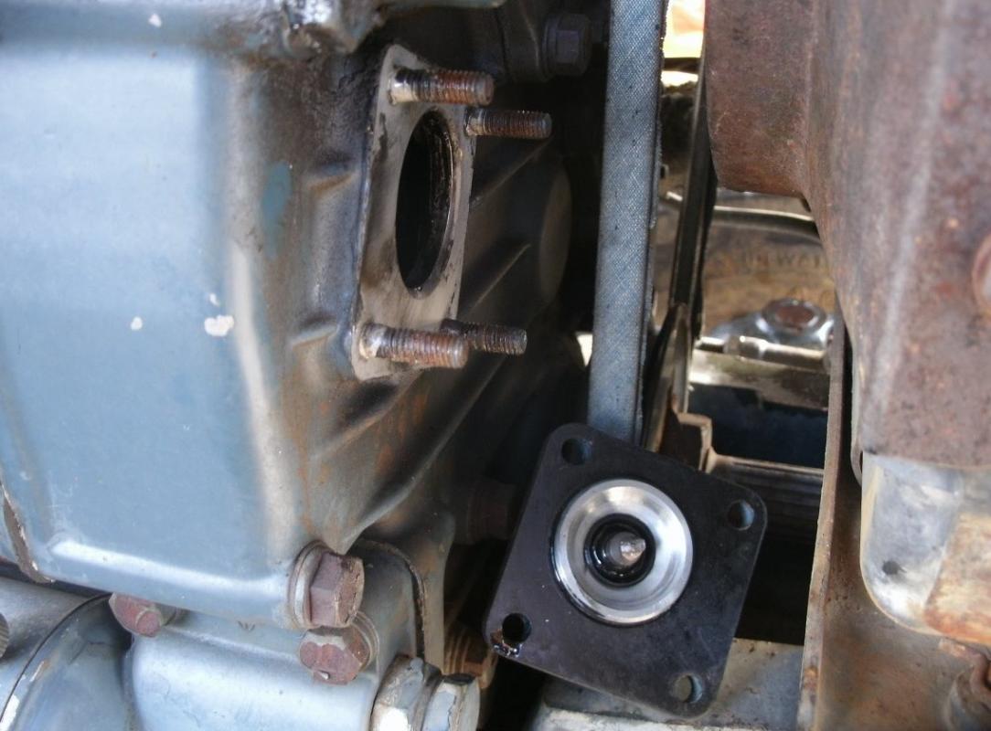

Look at the positive. If the tach is working when you spin the cable that means the expensive part is OK.
Post a picture please of where the cable connects to the engine, likely the injection pump.

Dave_eng. I'll post you a picture in the am. It attaches bottom right side very front of engine.

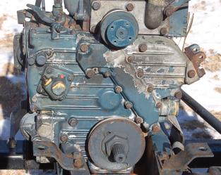

More than likely your problem is here....
And unfortunately that is an expensive part if you can find it,
but possibly repairable.......

Thanks all. From the other posts I can't tell what kind of mechanism I'm getting in to. Is there a chance I mess with timing taking this part off? Not sure I'm going to understand what is broke until I take that cover off.

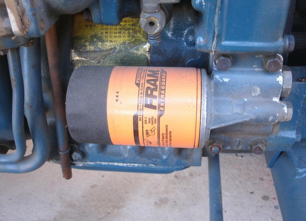

1) engine oil warning light on problem.
I replaced complete oil filter assembly from canister to spin filter assembly(bought from e bay) then resolved the low idle oil warning light on.(I was assuming the check valve control the engine oil flow)in the assembly was not function correctly)

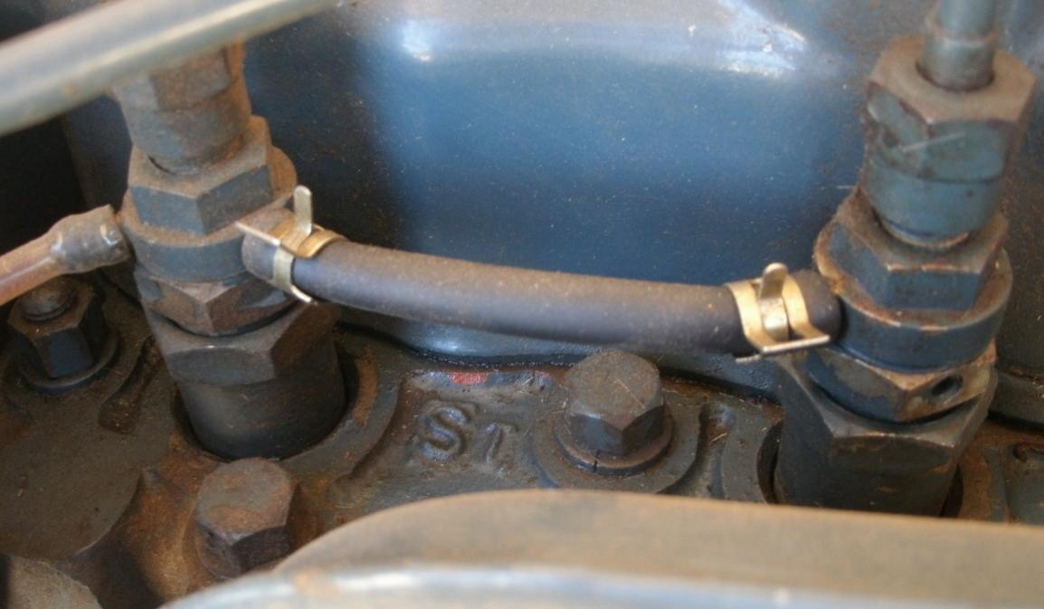

2) the injector leaking problem.
Replaced fuel returning hose to rubber hose with clamps.
no more leaking any fuel.
3)tech meter is not working problem.
disassembled cable housing on front engine then discovered the end of tip was broken. added some tip with welding machine and grinded to make sharp tip like flat screw driver must be correct length and wide(cable and meter self weren't any problem)
Now, it works perfect.

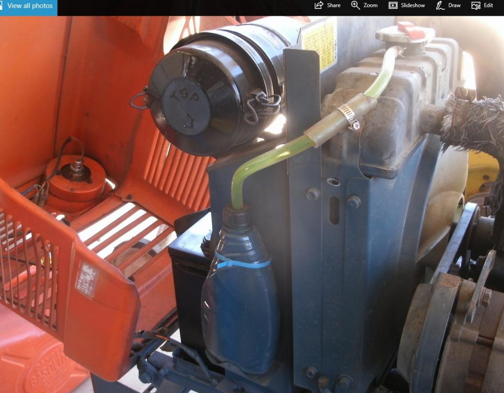

I had coolant overflow problem whenever running the the tractor for some period time so added home made overflow container(used spray bottle). works perfect meaning no more overflow the coolant.

Jkk, thanks that is very good info! Did you have similar symptoms as me with oil light? I did research the spin on adapter but the oil filter assembly was set for certain psi relief? Or something along those lines. Been a while since I read up on it and I was worried about adjusting something that was set for a certain psi. Ill definitely go research it a bit more. The spin on filters will definitely be cheaper in the long run! Gosh just looked up in the manual. It says right here to replace it!
I definitely tweaked the return lines on the injectors. Going to replace them as soon as I go back into town.
Definitely going to implement your overflow idea as well. I haven't replaced the coolant yet but when fall rolls around will definitely get that some.
