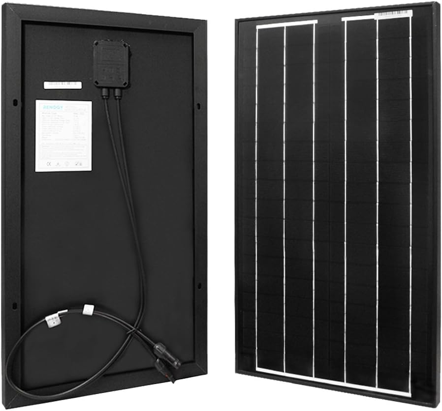

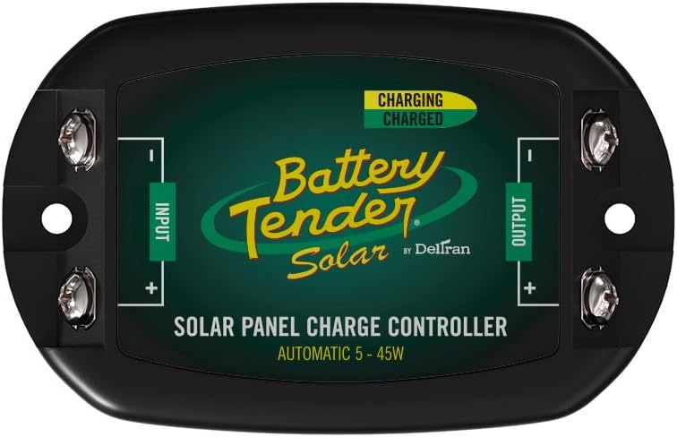

I keep 2 motorcycles in a (mouse proof) shed for the winter...
To charge the batteries I use:
A 30 watt solar panel ( Renogy RNG-30D)
And a Battery Tender solar charge controller. (#021-1162)
The controller has a cord that plugs into the bikes pigtail to the battery.
Every few days or so I will swap from 1 bike and plug into the other.
The solar unit works just like the 110v tenders.... when the battery gets to 12v it goes into maintenance/float mode and the light turns green.
Works flawlessly.
Works flawlessly.

John,
For that controller and panel.....
Did you have to cut and splice the panel wires and screw them on to the controller and then cut and screw on the wire lead that goes to the battery...?
Or... did it come complete..... like .... plug & play..?
John T
2017 BX23S
May 5, 2017
1,014
471
under a rock
John,
The solar panel uses a bullet type electrical connection. Male-/female+
The controller end(s) use a ring terminal.....So I just made an appropriate connector wire.
For controller output/battery side, I used a Tender pigtail (SAE)
which plugs into an 20' SAE extension cable..... From there I plug into the bikes or the tractor.... They all have SAE pigtails to the battery.
Even my jeep and pickup have pigtails.... so if I really wanted to I could park next to the shed and run the cord out the window to the vehicle.

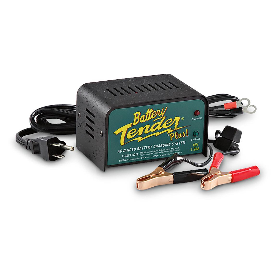

Someone commented about Tenders not charging a dead battery...
That has not been my experience.
They will charge it.... but it days a long time. at least 24 hours.
I'm talking about a traditional 110v plug in Tender.
My wifes bike has a slight parasitic battery draw for the clock on the dash....
I had a brain fart and left it all winter in the corner of the garage....
I put the "Battery tender plus" on it and it brought it back to life. It's been fine a couple years now.
I have since learned to disconnect the battery in the winter.... :sneaky:
