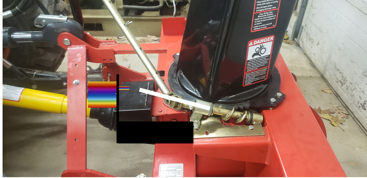

Although I wanted a blower with hydraulic chute rotation and deflection like my last one, beggars can't be choosers. I found this Blizzard on Craigslist in 'like new' condition at a great price. It's now mounted and ready to go.
The more I looked at the manual rotation mechanism the more it looked like an easy conversion to an electric drive.
On ebay there was a motor that looked like it fit the bill:
1/17hp, reversible and 12v.
So I did a quick sketch of what I think is a plan:
The black plate will go on the underside of where it is shown and will be bent so the motor shaft and my extension (white) line up. With any luck I won't need a universal joint. The existing manual shaft is secured by a screw (between the universal joint and clamp).
The wiring is pretty trivial. I have a 6 fuse block under the fender and a dpdt momentary switch on the way.
Am I missing something? The motor shaft is just under 50rpm. Should I use the universal joint anyway? flexible coupler?

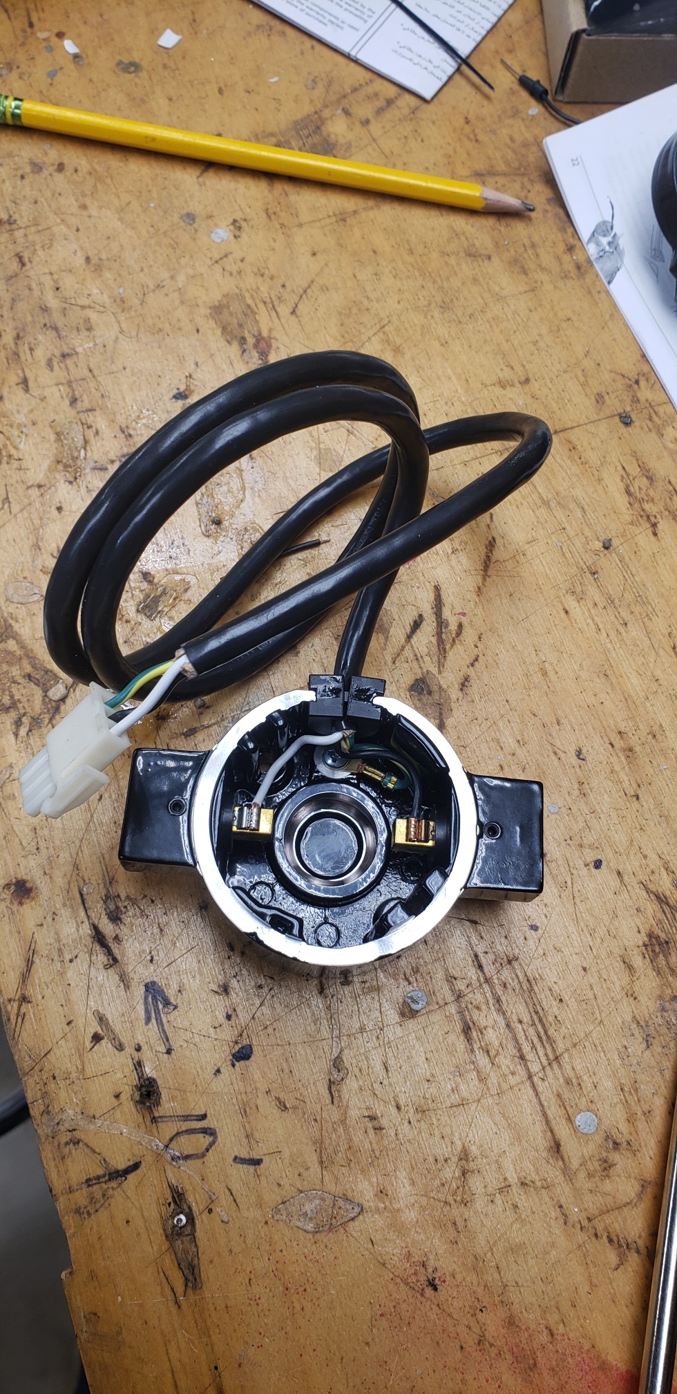

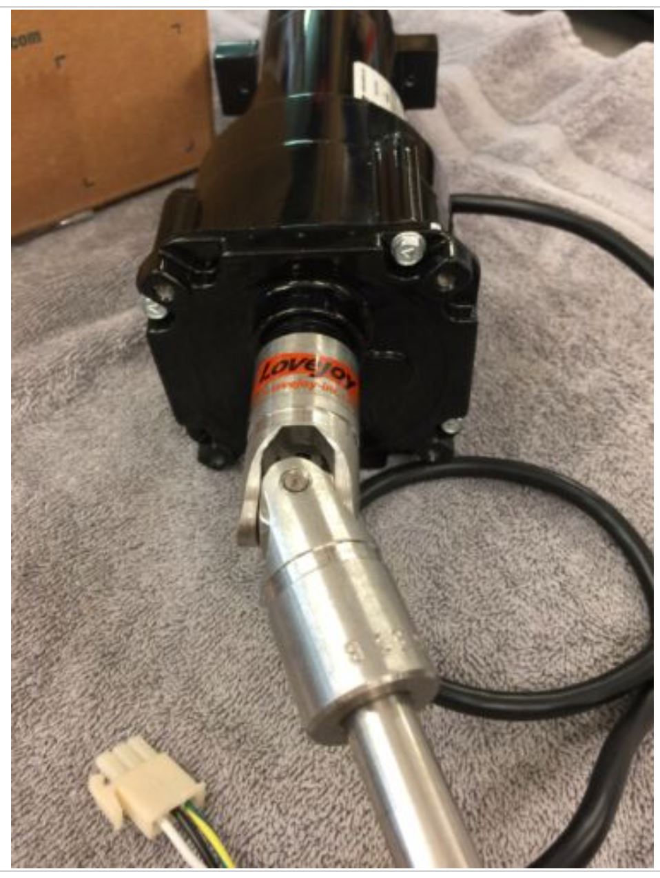

Of course the motor didn't come with he Lovejoy coupler. It was just in the picture for display purposes. No problem. I have a couple on order that should be here in 2 days.
The wiring is complete. Several steps to it. First I had to replace the cord/plug that came with it.
Then test it to make sure I didn't fubar it completely.

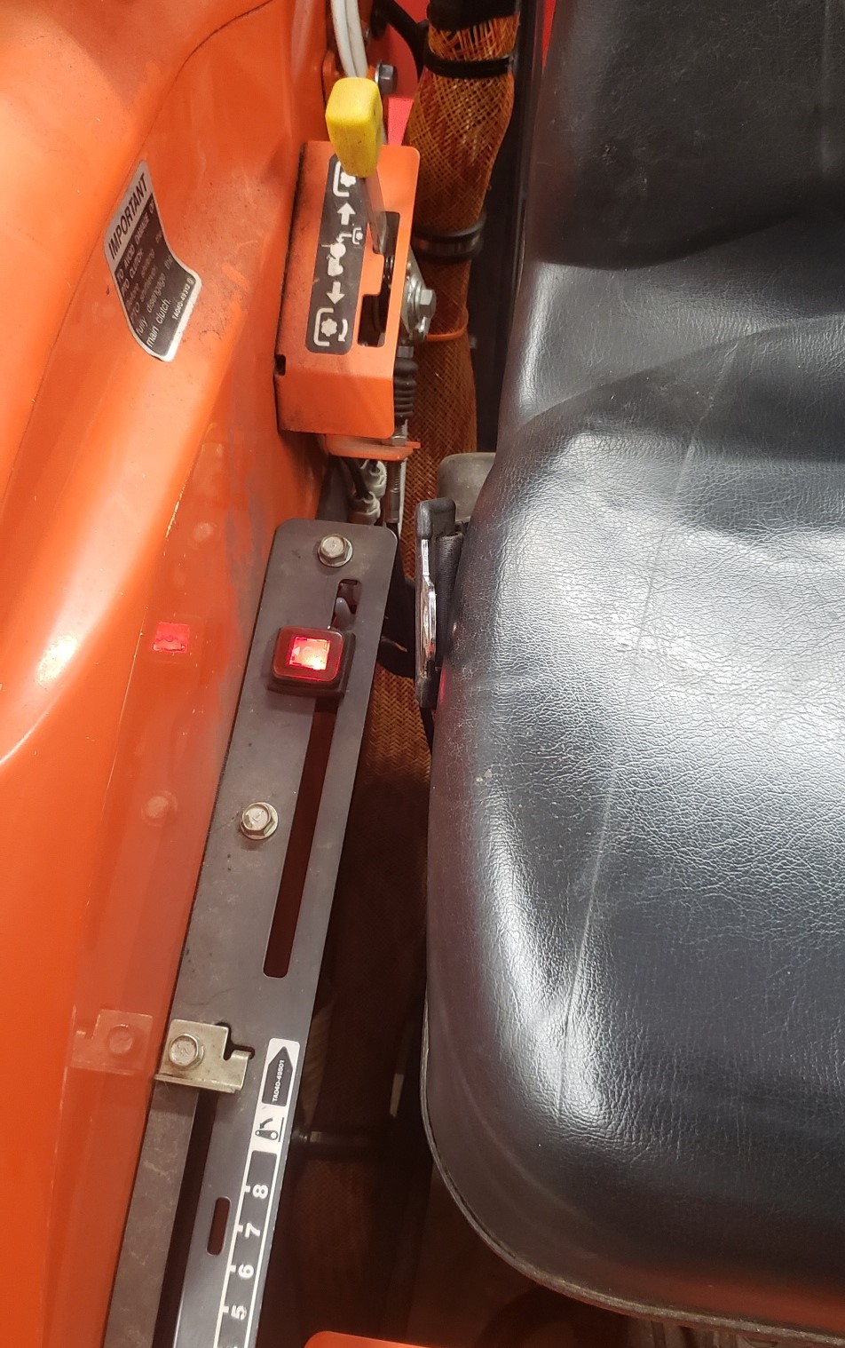

Install new lighted dpdt (center off) switch in the unused draft control slot
Wired it all to the fuse block I had previously installed in the left fender. Plug it in and test it.

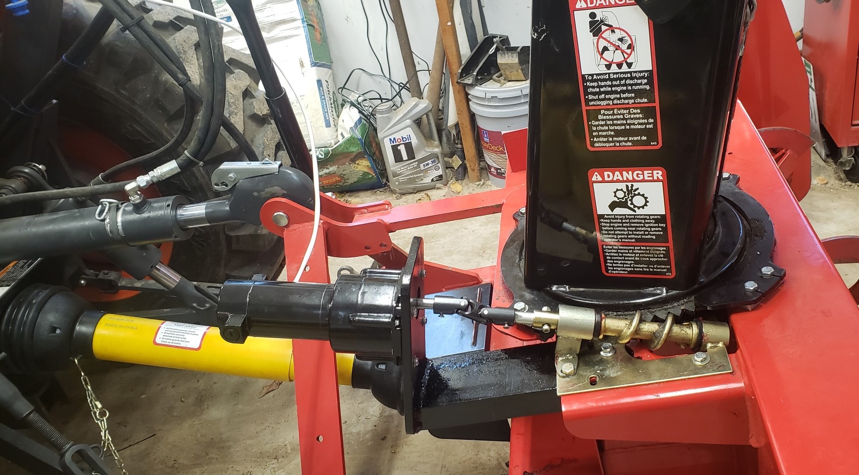

It works! Unfortunately my friend who welded up the mounting plate got the angle backwards. Instead of a 75deg angle he made it 105 degrees. When he dropped it off I really felt badly telling him. You can see the angle is about 15deg on the shaft with the worm gear. The mating face should be 'leaned in' that 15 degrees.
He really did a great welding job and after looking at the piece I realize 1/4" steel is waaaay overkill especially since he put two gussets on it. He should have a new one to me in a day or so. btw he is the gentleman I sold my L3400 to a few years ago (10 yrs old, 130 hours). He has as much wax on it now as I have grease on my current machine.

And its finished - just some touch up to do.
Demo of electric chute
I want to wrap that U joint with some kind of grease tube per GreensvilleJay's suggestion. Also have to come to terms with some kind of limit switches
Here is a closeup of the motor / mount assembly. I didn't realize the U joint came without set screws. I had to tap them. A new learning experience.
I had original calculated that the angle should be 72 degs for the mounting plate. Then I just assumed the worm gear was at 15degs and my calcs were off. So I had the bracket made at 75degs. If I had gone with my measurements the alignment would have been much closer.
