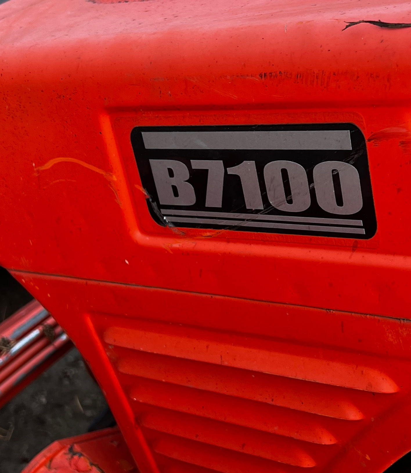

Kubota won’t start since it got down to below freezing
I assume it’s the glow plug, it’s always had a bit of trouble starting, it’s from 1980…
