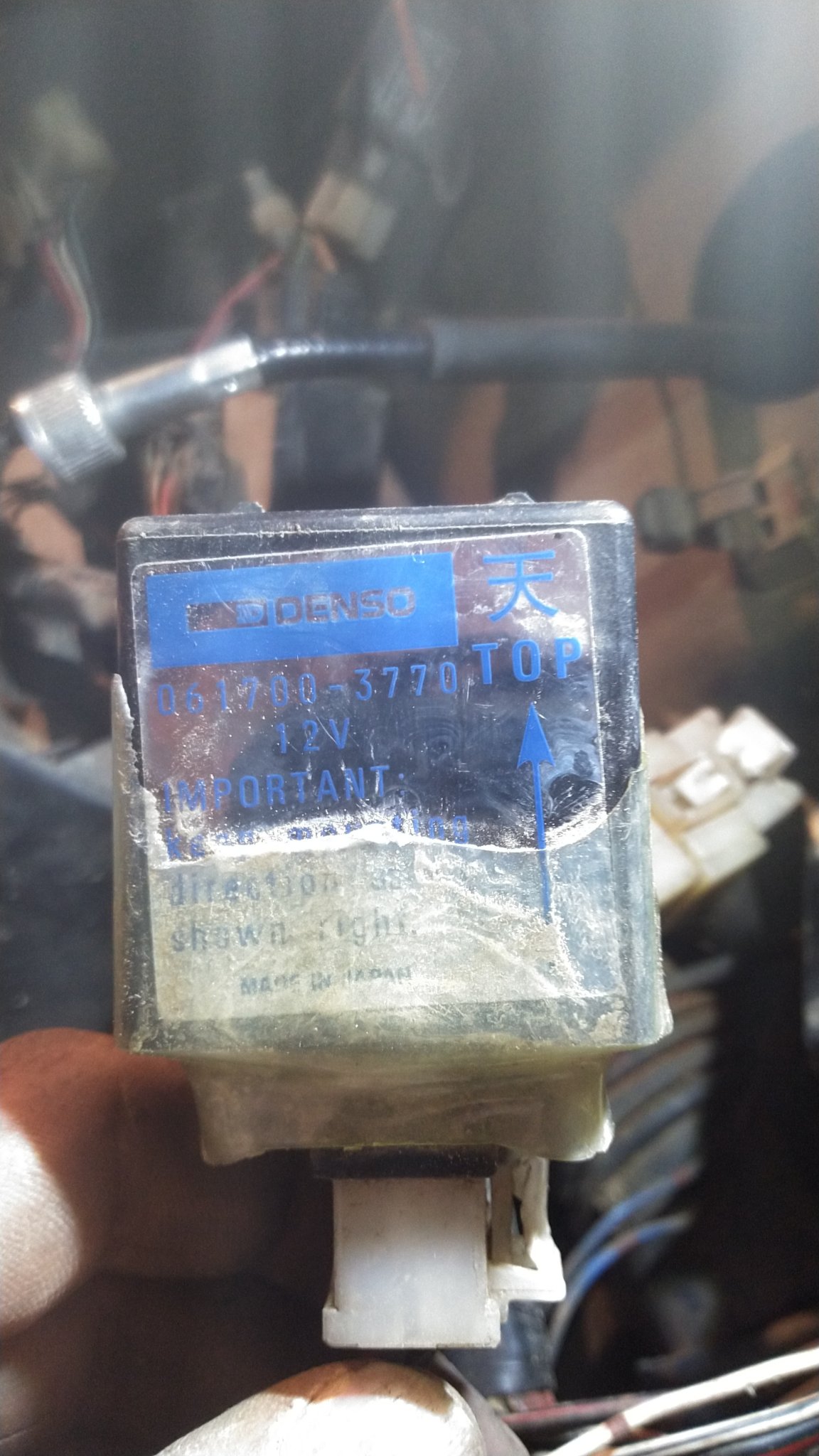

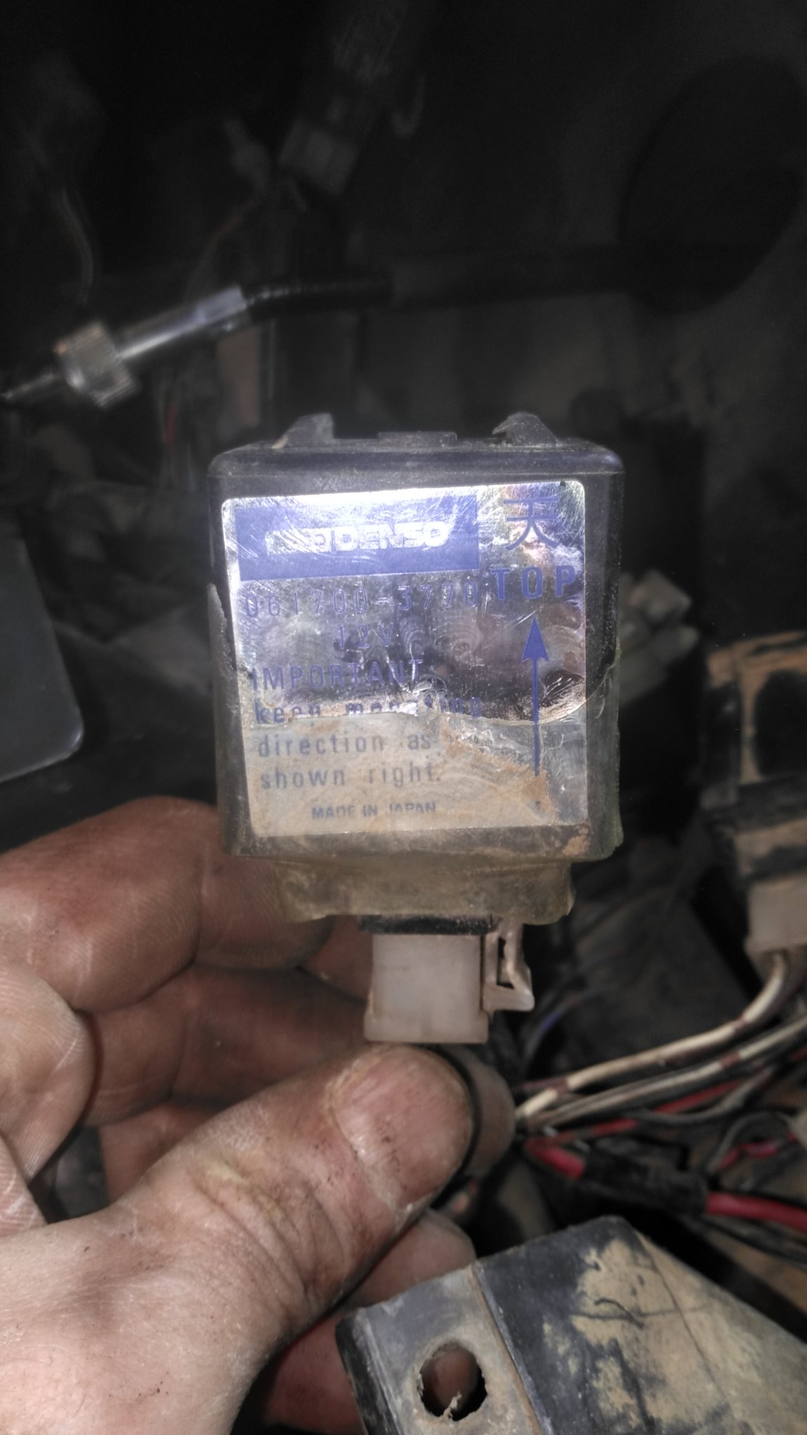

Here's what I've come up with so far by testing things with my light tester. I have 11.6-12volts with the key in the on position going to the glow plug relay. When I test the glow plug controller I have 11.6-12 volts of power to #3 main switch AC and #5 glow relay. I've included a screenshot of that diagram. I'm also including a picture of a relay or controller (not sure what it is) that comes through the same wiring harness as the controller and relay. No idea what it is. Also from what I'm reading there is a slow burn fuse? Where would that be located? Thanks Nick

I figured out that relay is for the starter. Does anyone have a better picture of where the water temperature sensor is located? I found what I believe it is but I'm not sure

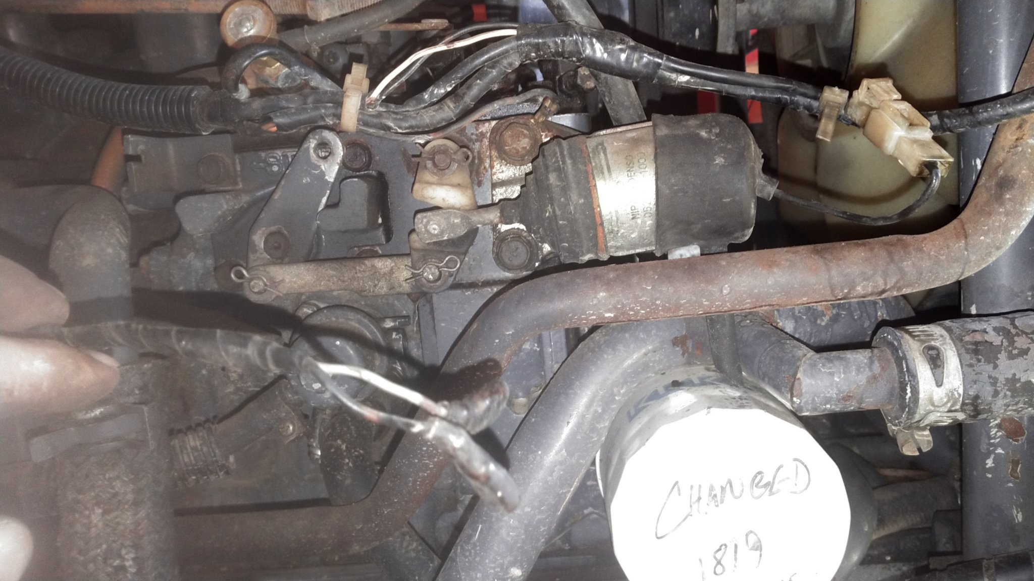

I found it. Picture attached. The only wires I have (pic attached) as you see are 2 wires that run along the same bunch of wires for the head light. These 2 wires don't even reach the water temp sensor

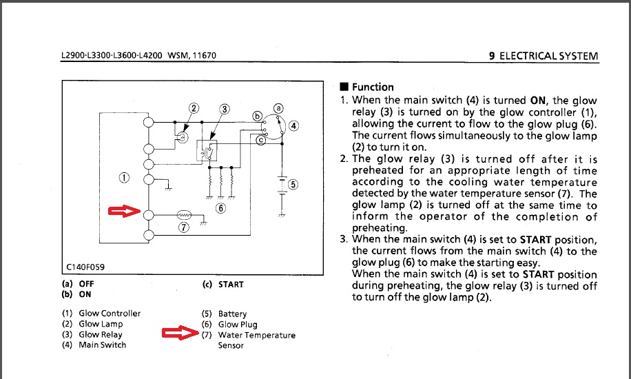

My WSM as previously mentioned is not for a L35. Further it seems to be missing the electrical wiring diagram.
Perhaps it is time for you to buy a proper WSM.
I found this schematic for the controller showing where the temp sensor connects.

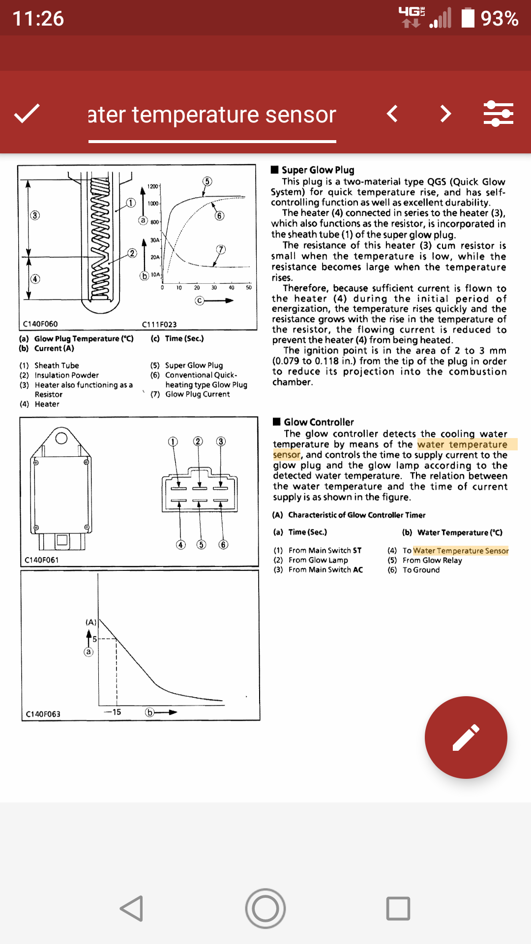

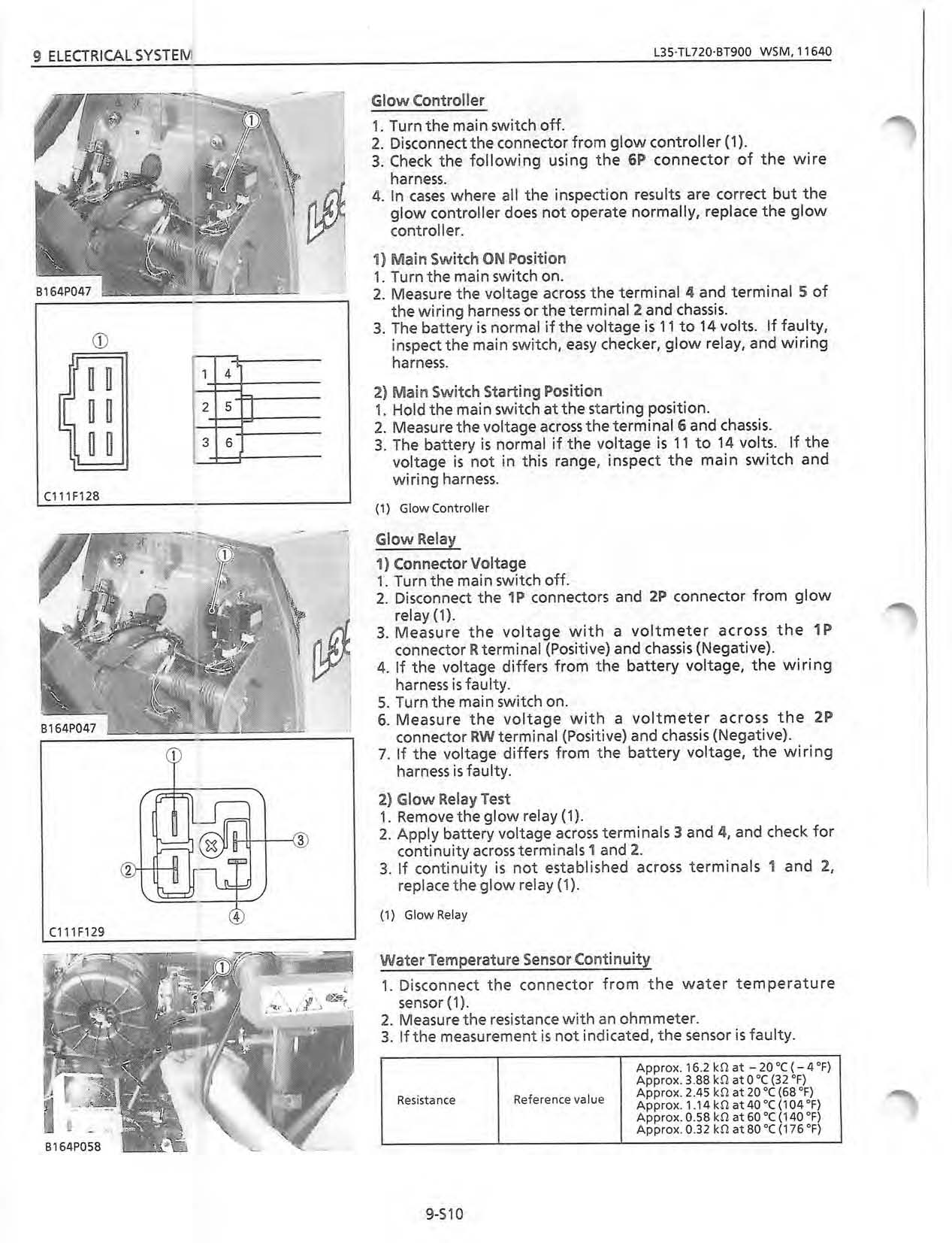

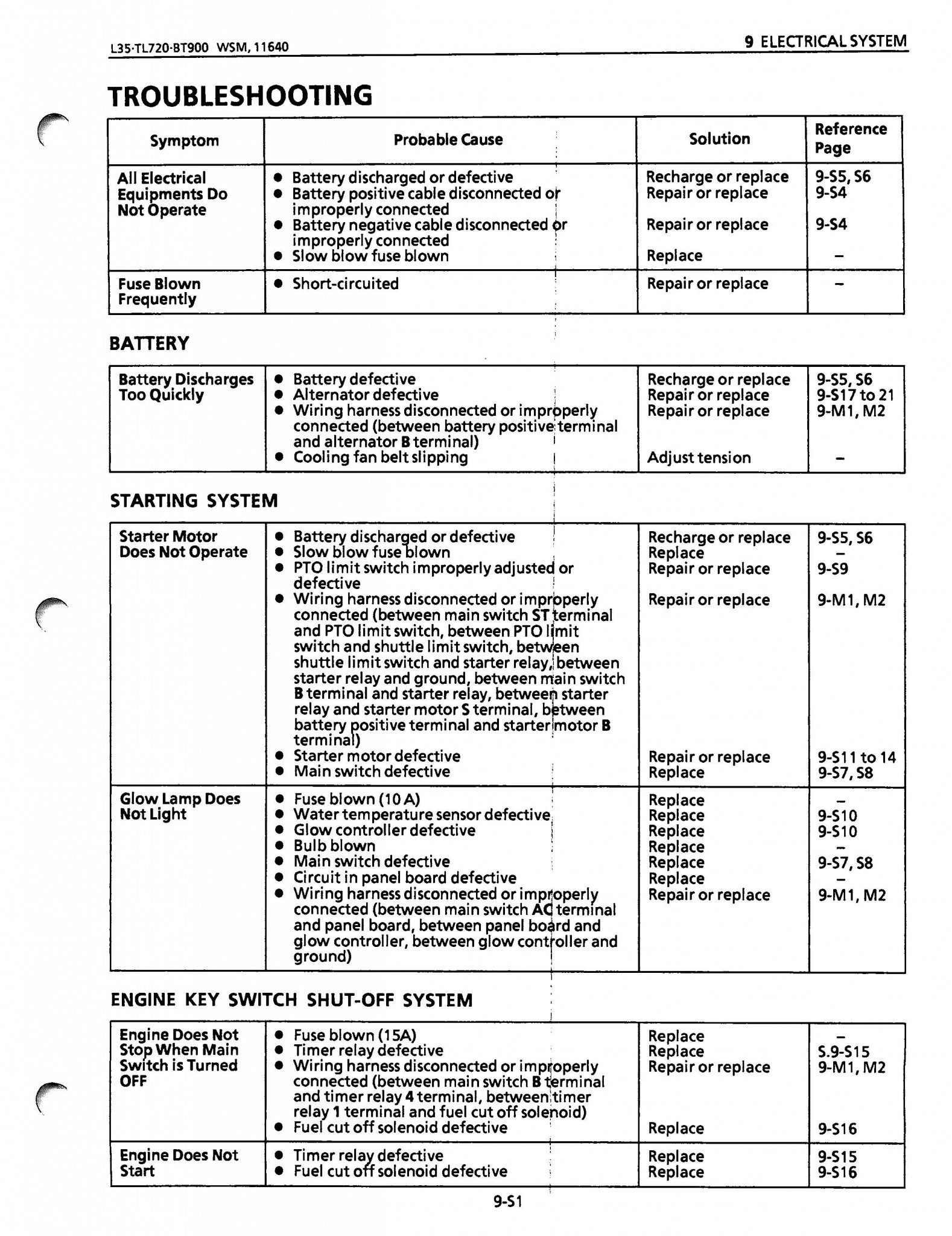

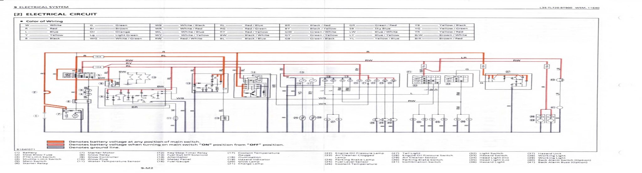

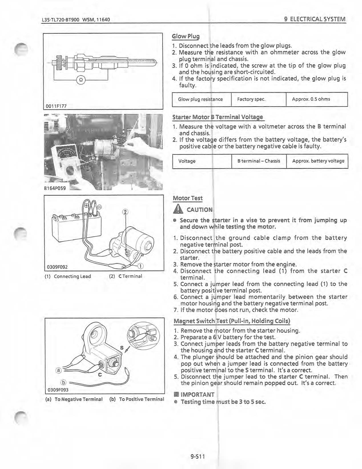

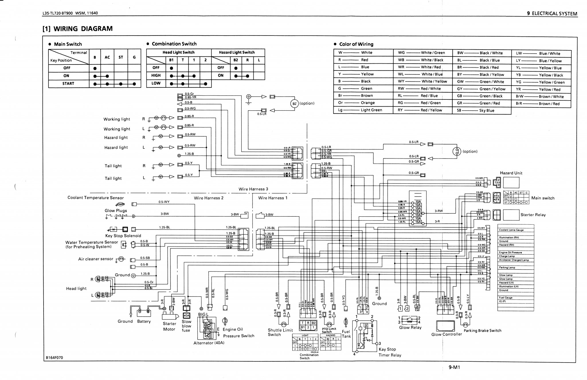

I have a L35. When I turn the key to start the glow plug light does NOT light up. If I turn the key and leave it on for say 10-30 seconds it still takes forever to start. With this being said is it my glow plug controller or glow plug relay? I've read if you change one it's best to change them both? Any suggestions?
1. Unless the indicator light is burnt out, the problem is before the relay as the timer/controller controls the light.
2. I thought an open temperature sensor would just cause the controller to stay on a long time, but according to the troubleshooting chart it can cause the light (and controller?) to not turn on.
3. There is a temperature sensor for the glow plug controller separate from the sensor for the temperature gauge. The one you're interested in is near the air filter. See the service page attached.
I've attached some pages from the WSM which should help you. You can test the light by pulling the connector off the controller and grounding the WB wire with the key on. It should light.
I'd check the temperature sensor at the connector. That way you're checking for continuity as well as sensor resistance.
Hope this helps. Let us know how it goes.
View attachment 69886 View attachment 69887 View attachment 69888 View attachment 69889 View attachment 69890

Had a better look at the scematic, lower right 'glow relay',looks EASY to bodge !. If you remove the connector going to the 'glow controller', you can ground the wire going to pin #4 of the glow relay. That should put power to the glowplugs. If that works,(put voltmeter on glowplug..should get 12V with relay on..) wire a $2 pushbuton between #4 and ground. Be nice to use 'spade lug' connectors instead of cutting the #4 wire, in case you decide to troubleshoot this properly ...all winter long.....

Easy to test glowplugs...
1. take pictures first...so you KNOW where the wires go later....
2, remove wires between the 3 plugs.
3, use ohmeter.
3a, first connect ohmeter leads together and remember the number ( say it's 0.4 ohm),
from one plug 'wire connection' to ground.
3b, connect ohmeter to power stud(connection) and ground of a plug, say the meter read 1.1 ohms
subtract that number from the first one ( 1.1-.4) which is .7 ohms and kind close to the 0.5 in the spec.
THAT plug is GOOD. If you get a reading the same as the 'shorted probes' reading (0.4 in this case) then the plug is BAD. The reading has to be 0.5 higher than the storted probes value.
If you put a voltmeter on the plug wire it should read 10-12 volts if power is getting there. Even a simple 'test light probe' will work(it'll light up(.
