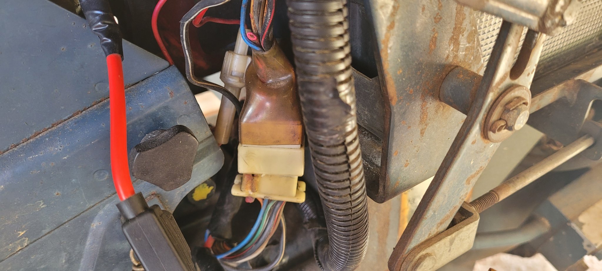

The glow plug indicator/resistor quit working. I purchased a new one, installed it and when i tried it, it shorted out. burned the main wire from the starter, burned the main 9 wire plug and broke my volt meter. I removed the new indicator and bench tested it to find out that is was defected and the post must be touching the frame of the indicator. I got continuity from the post to the entire part. I am in the process of fixing all the damage. the vendor refunded my money and sent me a new one at no charge. I am going to bench test before I install the new one, but it is a pain to install. just thought that putting a switch would be easier. ps. know where I can get a replacement 9 pin connector?The indicator is also a resistor so I would not replace it with a switch.

I was the one that suggested you contact @Mountainman at his siteThe glow plug indicator/resistor quit working. I purchased a new one, installed it and when i tried it, it shorted out. burned the main wire from the starter, burned the main 9 wire plug and broke my volt meter. I removed the new indicator and bench tested it to find out that is was defected and the post must be touching the frame of the indicator. I got continuity from the post to the entire part. I am in the process of fixing all the damage. the vendor refunded my money and sent me a new one at no charge. I am going to bench test before I install the new one, but it is a pain to install. just thought that putting a switch would be easier. ps. know where I can get a replacement 9 pin connector?
