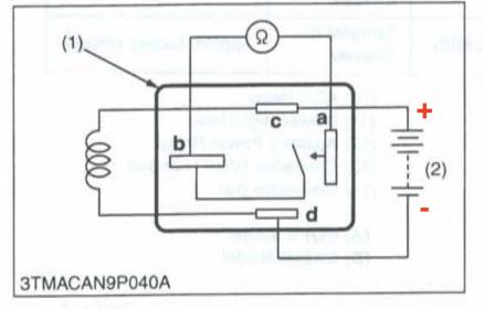

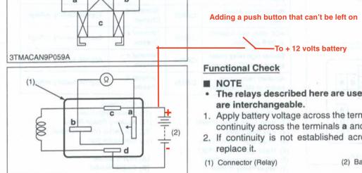

Kubota had a problem with glow plugs relay not carry enough current. The current replace part has copper blades that are wider on the power side of the relay. Looks like there is a 50 amp fuse suppling the current for the glow plug. I have a relay on order. While I have the dash panel off I plan to add a manual override button to activate the glow plugs. See attachment and let me know if I am missing something. Thanks for all the replies.

The schematic I attached is not correct. I would be applying power to the glow plugs and not closing the relay. I guess posting is good for catching your mistakes.

I am having trouble understanding the glow plug relay schematic. My guess is I should add +12 volts to the "a" blade of the relay in order to close the relay. In addition the power must require the switch to be on. Sorry for the incorrect post. Thanks

I don’t understand the schematic either. I thought there would be a hot and a ground going to the relay to control the relay and then a then a 50A hot which is controlled by the relay which goes to the glow plugs. If that make any since whatsoever.

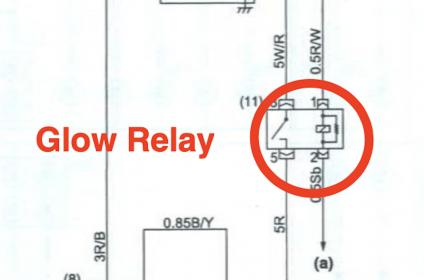

It an over simplification here is a better schematic from the same service manual. The problem is not having the sensor circuit and timer controller in the dash information. In addition the shop manual over simplifies the schematics. If I put the manual override in, I will look at a double throw switch that will break the 12 volt being sent from the sensor / timer. I know the sensor sends an ohm measurement that represents temperature to the timer in the dash that supplies voltage to close the glow relay the required amount of time depending on the temperature. I don’t have a clue what the back voltage will do to the timer circuit in the dash.
Thanks for looking and the reply

The glow plug relay load is heavy wire to a 50 amp fuse. The relay closing wire is on a 5 amp fuse in the schematic of my previous post
