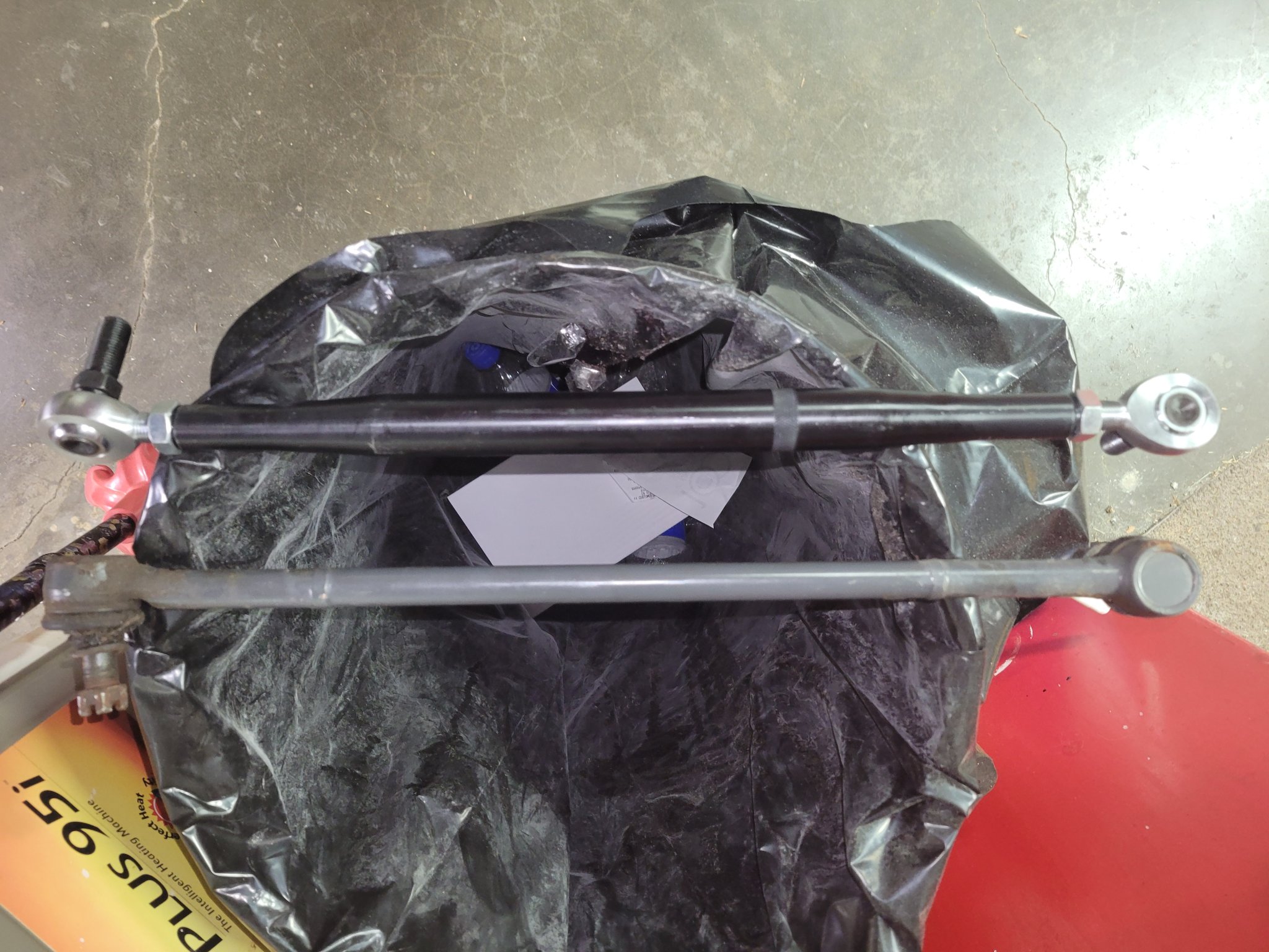

I have had 4 GF1800's. Refreshed and sold 3. Everyone, without fail, the steering was sloppy. Kubota used very simple ends on the tie rods. Not tapered, just like a bolt from a ball joint thru a flat plate. TIghted the nut instal a cotter pin and done. All of them have worked loose. I've tightend them and that works for a while, but the seem to work loose again. Next time I have the current one apart, I'm going to replace the steering links with good heim joints that are designed to have a bolt and jam nuts with nylon lock. Don't see a real need for high end race car type joints, but absolutely will upgrade the whols system.

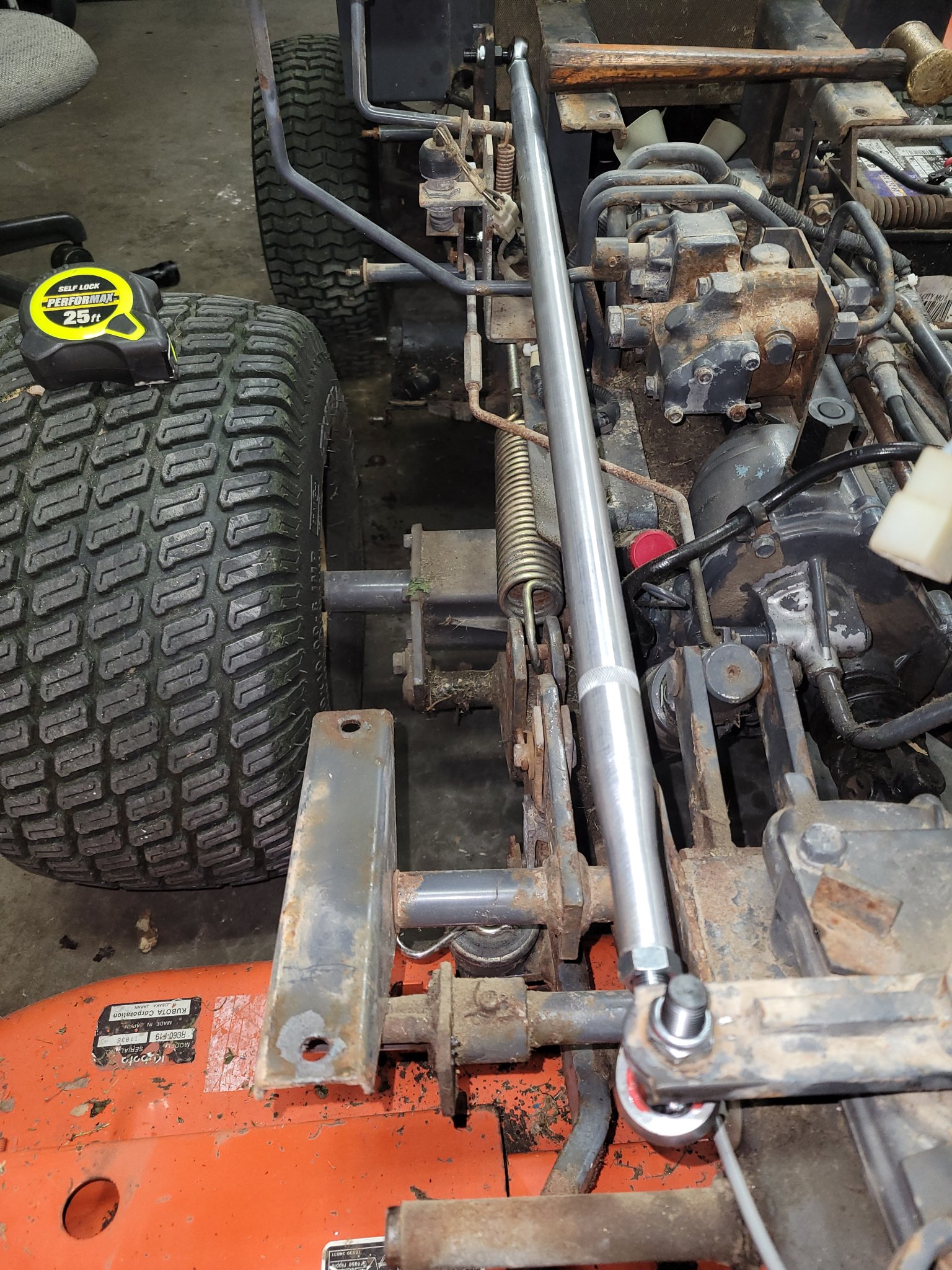

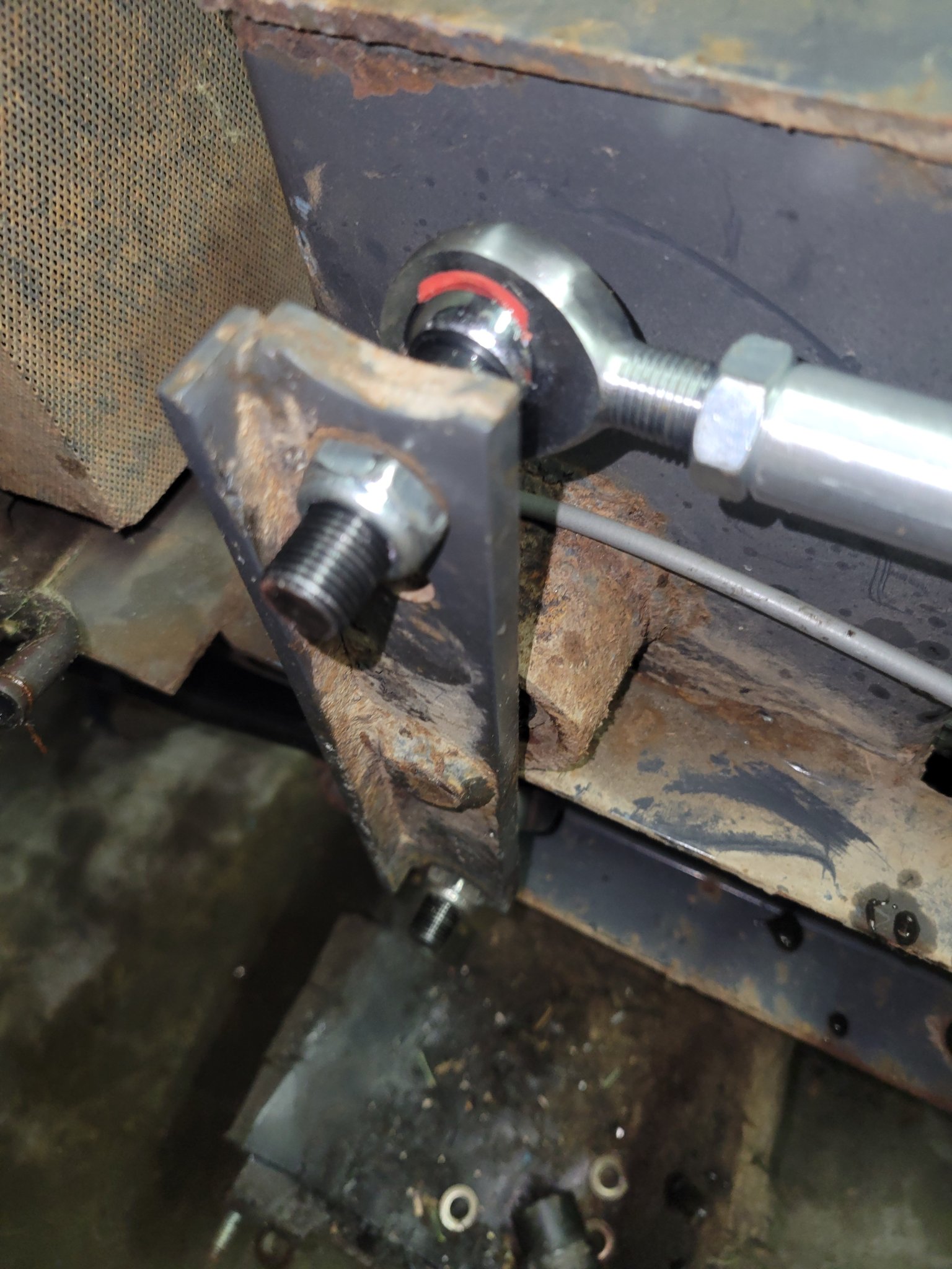

I checked the joints themselves, (Thanks for the tip Hugo!), they were tight. All the play was in the holes the studs go through.
I elected to just replace the complete assemblies. Little more cost, but the end result is now the machine will travel in a straight line without constant corrections.
All the holes had to be drilled to 1/2 inch to fit the US standard. Another plus is the studs have wrench flats so they can be properly torqued.
Total Cost $122.20
2 XMR8 Joints with studs. Nylafiber. self lubricating
2 XML8 Joints with studs. Nylafiber, self lubricating
6848-33 1x1/2x33 Aluminum Swaged rod
6848-14 1x1/2x14 Aluminum Swaged Rod
4 1/2 Jamnuts (2 lH 2 RH)
4 Locknuts, 1/2 SAE Thread
Sourced locally (for me anyway) from Rod End Supply
