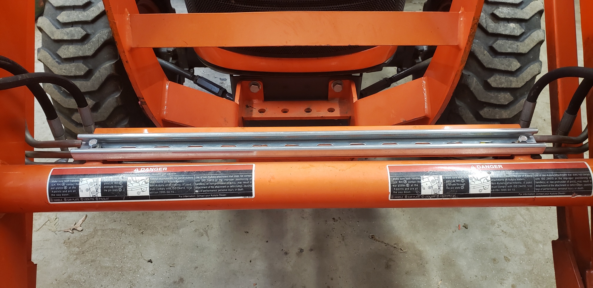

My #2 son was up here for the weekend and we were talking about the pros n cons of what I was planning to do with the ubolts around that 3" tube. He suggested mounting a piece of angle iron on top of the hydraulic cover plate that is attached to that tube with 8mm screws on the ends. Sounded ok.

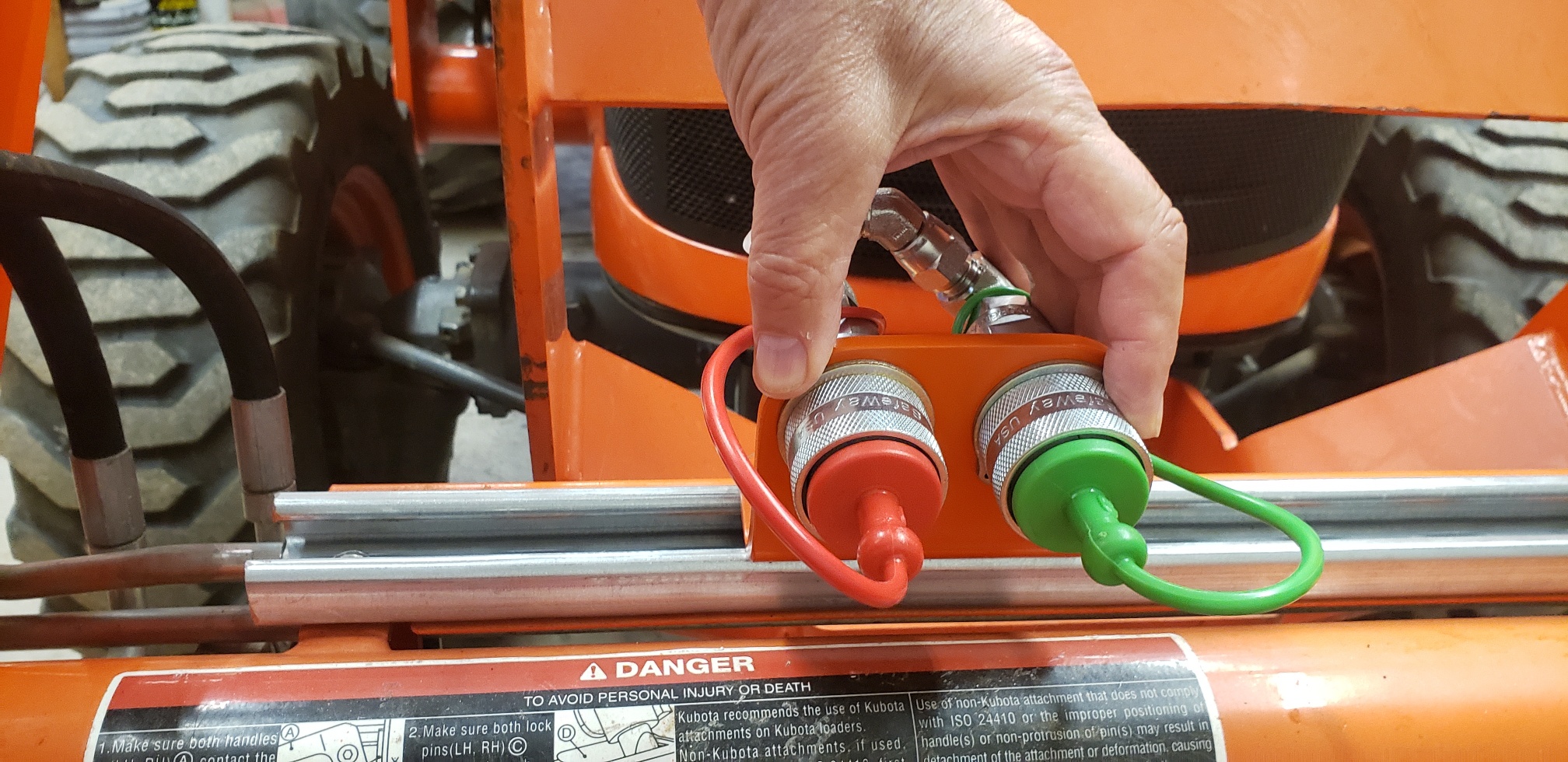

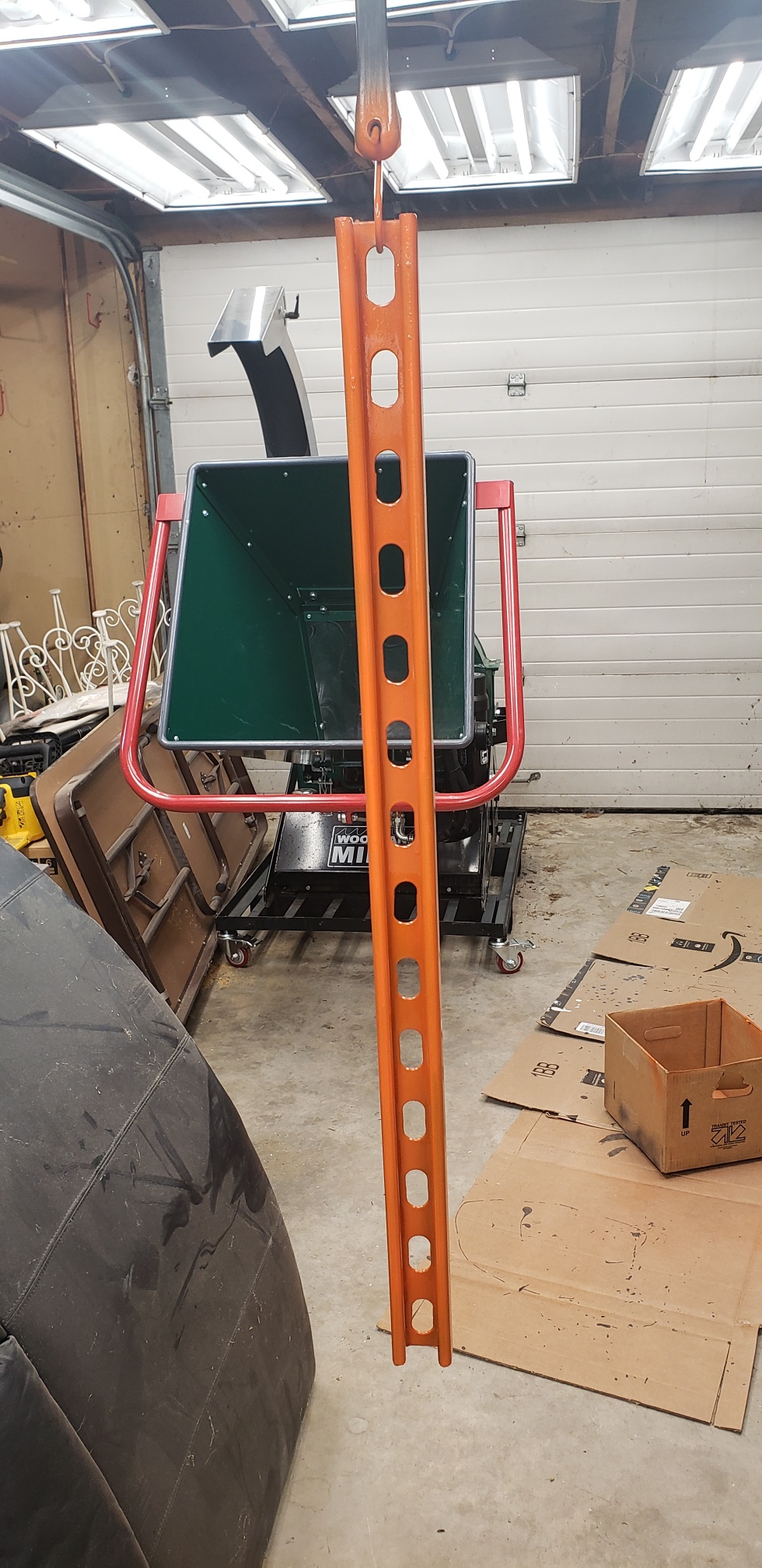

After he left I was looking at it and the light bulb went off. I have some shallow strut left over from my ballast box project. So here is where we iterated to now.
Test fit the strut:
The breakaway couplers and mounting bracket were supplied by Brian of Fitrite. Using 2 3/8" strut spring nuts I can mount that securely to the strut. Just need to drill out the mounting holes on the bracket to accept 3/8" bolts. Test fit:
and while I wait for the bolts and spring nuts:

That's pretty much how are Summit kit does the front mount. But without the unistrut. You can enlarge my previous pic and see it there. You might also consider being able to mount your angle plate both parallel or perpendicular to that cross tube. (should be easy with the unistrut) Doing it one way or the other may make your connecting hoses fall into place easier throughout the full motion of your grapple. I also sent you a message. I'll go searching for my stash of those brackets.... :)
