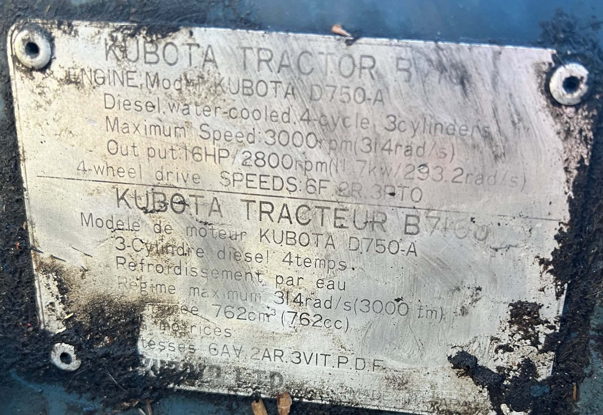

I had this in the shop, ALL summer, so went to get it back and was moving manure from near the house.
The rubber bootie broke, i thought I ordered the correct one, looks small.
Got the parts number from the forum.
Will not easily go into gear, help please...
pictures below.

That 40 year old boot looks pretty dry rotted. Probably got 10 years worth of dust, dirt, and water in there. Take it apart, clean it, lube it up.
