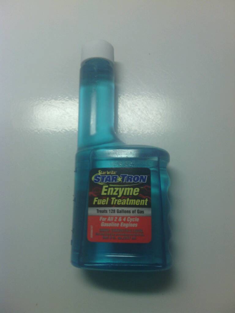

If fresh gas doesn't solve it, sounds like a clogged main jet. I use an ultrasonic cleaner (Harbor freight, $89 for the 2.5 liter one) to clean my carbs and jets. Had the same issue on my log splitter (Briggs OHV motor but similar design to the honda)....once I cleaned the carb and jets, I was good to go. If spray cleaning your jets doesn't work, buy some number drills and clean out that jet to the correct size (or buy a new jet). When you choke your motor, its using a different fueling circuit than the main jet. Once you kick it off choke, the main is too plugged and it won't get enough fuel. Also use "Startron" in your fuel from now on to prevent the alcohol from corroding and clogging your jets.
