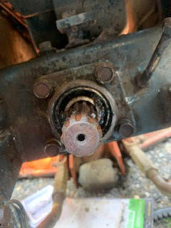

I need some help on my G5200. The bearing that sits in the front axle behind the PTO pulley is bad and is stuck. I've removed all c-clips and driven the pto spindle out. I've tried everything to get it out to no avail. I removed the 4 bolts that hold the support around the bearing (070 in pic) but it won't move. Does part number 070 (66091-25040) have to come out before the bearing?

Maybe lugbolt will reply.
I know he dealt with this problem with his G1900. It's all here, in this thread:
After reading that, I immediately ordered a case of PJ-1.
I just checked the front axle pivot in my G1800 a couple of days. Loose, took grease readily.
This is one of those Kubota 'gotcha' engineering deficiencies. [That last word might be too harsh.]
