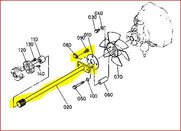

Remove the propeller shaft to eliminate HST drag (not very common).
