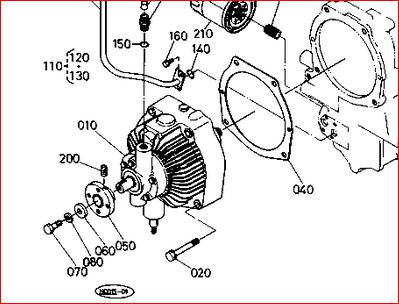

Heres the big question. Does anyone know if that pump hub comes off without taking the pump out so i can get it on the bench and get those 2 sheared bolts out of the hub and order 2 new bolts. OF COURSE they are sheared off flush on the crank flange side so you can't get a grip on them for removal. And i guess I'm going to need a new crank output shaft flange that interfaces with the pump hub.

Yes the hub comes off, bolt in end and set screw or locking bolt (#200).
Use a good pulley puller to get it off if it's stuck on. :)

WOW, awesome :D:eek:
Thank you soooooo much. I could not figure out for the life of me what i had done wrong.
Am i correct that the bolts final resting place is unimportant because there is a groove machined around that entire banjo fitting ? Im talking about the bolt that is part of the sump screen. There is a hole machined through the middle of that bolt. I put 2 new O-rings on the banjo fitting and i marked the head of the bolt so i would know where that hole through the bolt was. When i tightened it up, that hole ( looking at my mark on the bolt head ) did not line up perfectly with the banjo fitting exit to the feed pipe. Its probably 20 degrees past it. Is that ok ?

Yes the fiber (disk) joint is bad, pulled the bolts right threw it.
The fiber joint allows the drive shaft and the HST to be coupled in a way that the engine, shaft, and HST do not have to be in perfect alignment and still work properly and without binding.
For that system to work efficiently, properly and safely, it needs to be assembled properly with the right parts and tight! ;)
You are correct. The bolt position in relation to the fitting is not important.
