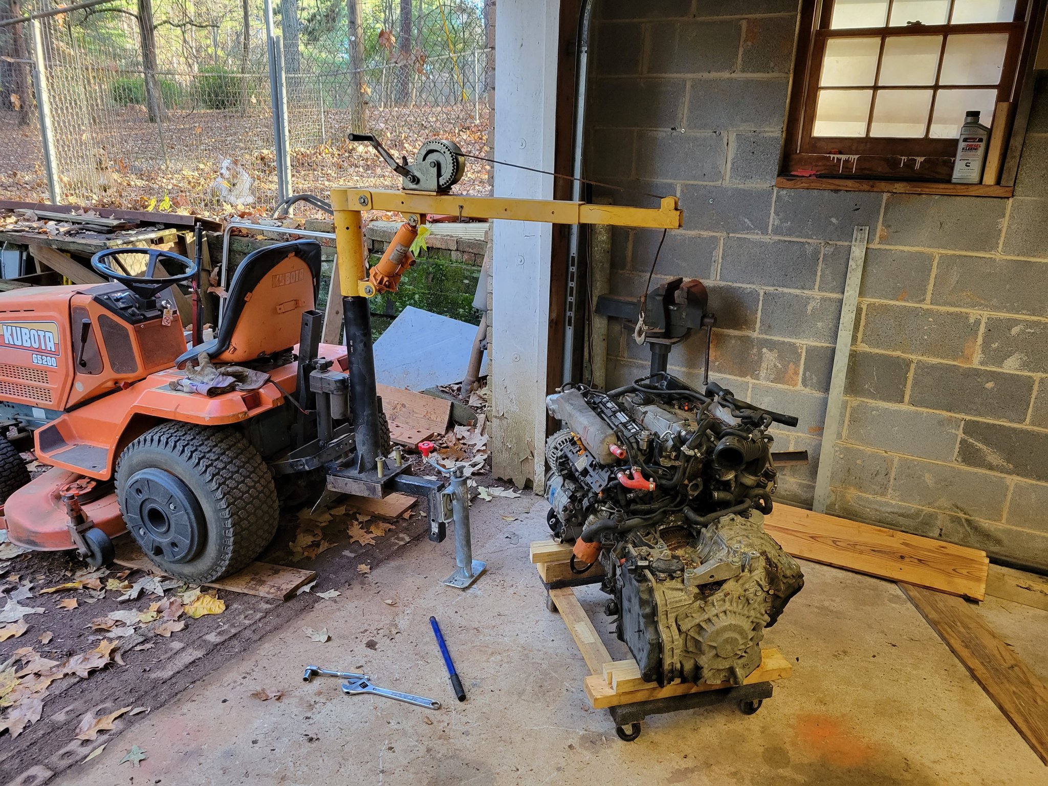

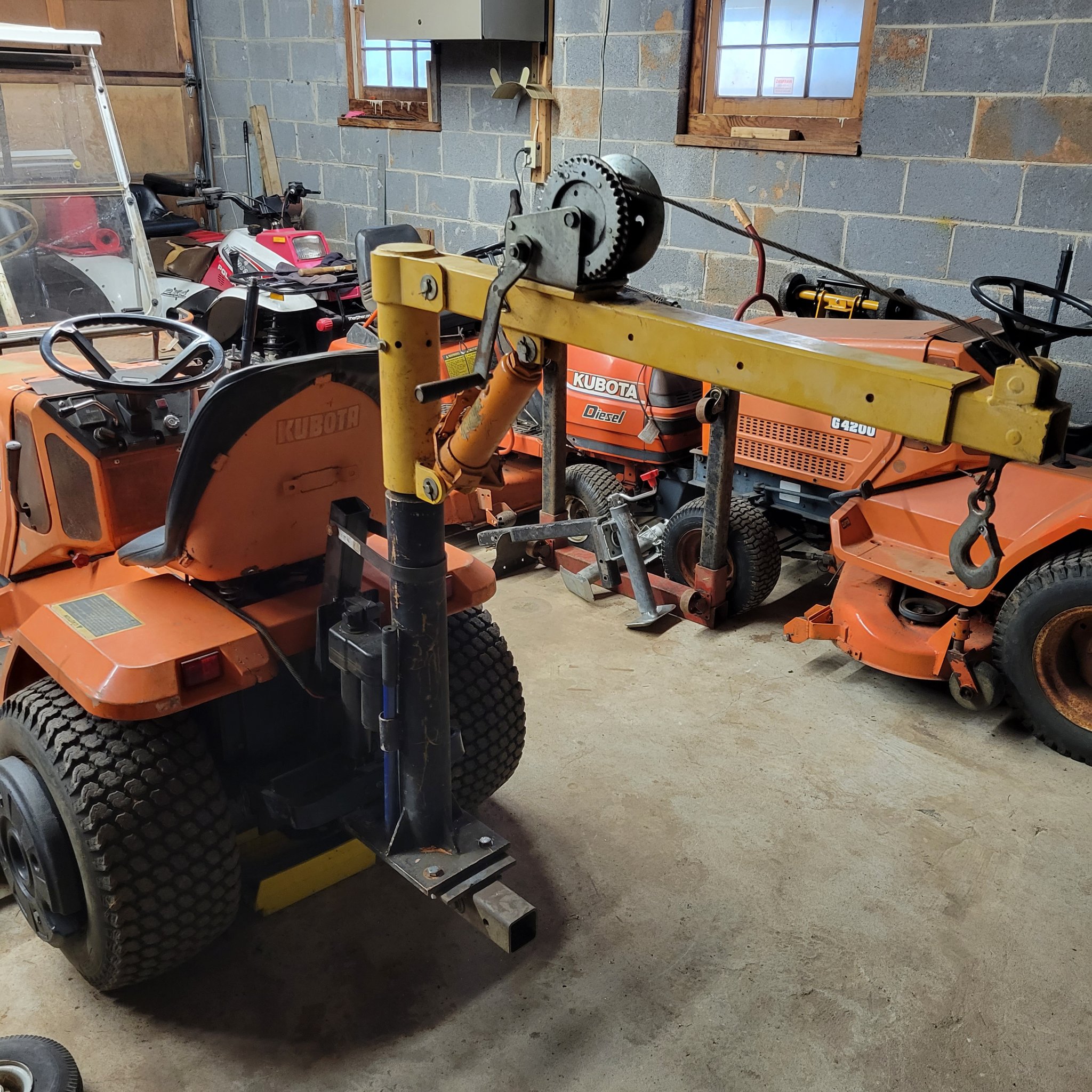

I've been trying to figure out a boom pole for it and settled for a truck bed lift. With a support I got an engine out of a car and into a trailer (480 lbs). The car was inaccessible to a cherry picker. I've used it without a support for things under a hundred lbs. I'm only using this in the afternoon position so not to flip over the small tractor. I used my home made receiver that attached my sleeve hitch for ok not so slow removal.
Makes my back feel much better already!
