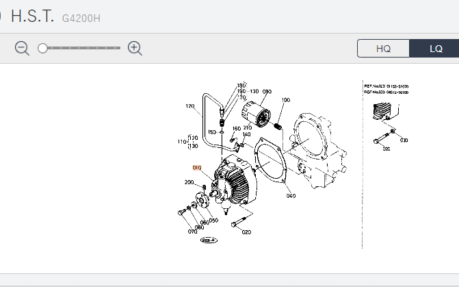

Folks:
This tractor is outfitted with an Eaton 11 or perhaps Eaton 1100 HST Transmission . This is way above my pay grade so I turn here for help . My mechanic [ an independent and a fine fellow ] says that the Eaton Pump and the transaxle case appear to be a single unit and that to remove the pump requires removing the transaxle case too . The Eaton manual that some one here kindly provided a couple of years ago doesn't show that to be the case .
The Messick's schematic for the transmission seems to confirm my mechanic but the Shop Manual kindly provided by Messick's seems to suggest the Eaton Pump comes out separately . Do any of you know or have an opinion ? Here is the Messick's drawing :
This baby backs up just fine but won't go forward . So I want to take it out for rebuild at an Eaton authorized shop . If it comes out without the transaxle case the job is simpler and transport to shop is easier .
Obliged for any help .
30,813
6,862
4 bolts to split the HST from the Rear end, it's not all one unit.
