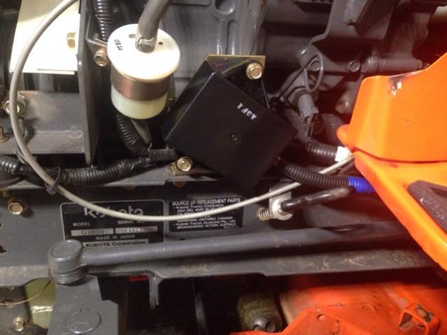

G1800 will not crank. Starting protocal followed (on seat, pto disengaged and pulled back, foot on brake), no go. Tried jiggling pto handle and tapping on starting (worked in past), no go. Checked power to starter, ground wires, and safety switches: all good. Checked fuses: all good. Checked black/white wire running to starter solenoid: no power, traced black white wire back to mystery box on opposite side of engine. Continuity good from solenoid to mystery box. Continuity good from mystery box to ignition (black yellow wire). Mystery box is 3 inches square and .5 inch thick, with bunch of wires leading to and from. Jumped power sending 12v to the starter solenoid and tractor starts up and runs (had key on and did the pre heat protocal prior). Key turns engine off. What is mystery box? What else to check? http://www.orangetractortalks.com/kubotagallery/?image=258

I'm having exactly the same problem. The mystery box is called the combination box. It could be your problem, but in my case it is not. The combination box cost $146. I bought a new one but I have the same problem with the new box. I hope I can return the new combination box to Messick but I'll chase that down tomorrow.

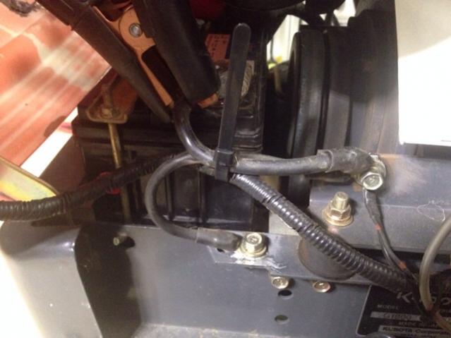

1) The ground connections between the battery and the frame and block were slightly corroded. I cleaned them up with sandpaper and applied a bit of anti-seize.
The grounds I cleaned are pictured here.
2) The Combination Box was bad. It wouldn't relay the 12V to the starter solenoid under any condition. I wonder if the bad ground may have caused the combo box failure?
I had previously thought the combination box was not the problem because I had the same "no start" condition after swapping it out. However, the bad ground was also causing low voltage (~10V) in the starter circuit.
After cleaning the ground connections and swapping the combo box, she fires right up.
