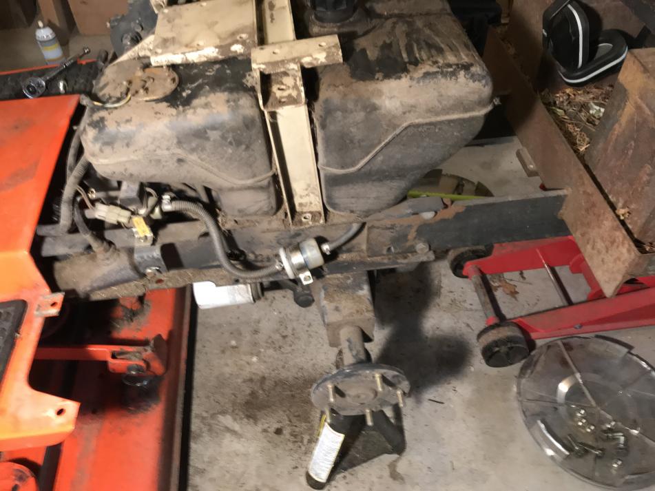

Hi AScott. That pic looks familiar. I had to do a similar tear-down to replace the steering box in mine. Never had to replace the driveshaft, but at least I know how to tear the machine down to get to it. I was actually a bit surprised at how relatively easy it was to tear down and rebuild.

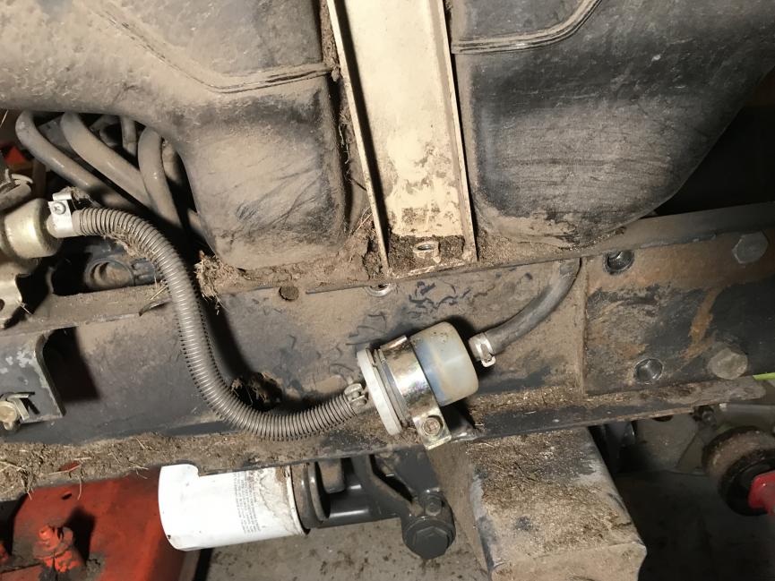

I had to unbolt the radiator and lift it slightly to get the drive shaft out. The cool thing is every bolt was 12mm except the steering wheel.

Remove seat and rear fenders and wheels and put jack stands under axles.
Remove the 8 (4 per side) bolts holding the transmission to the frame. Rubber mallet to move the axles backward 3/8" or so, allowing room enough to remove the drive shaft.

You also need to remove 2 bolts holding the fuel tank to the frame. To reassemble just rubber mallet the axles forward 3/8" and re align bolt holes. About 2-3 hour job. Probably an hour job now I know.

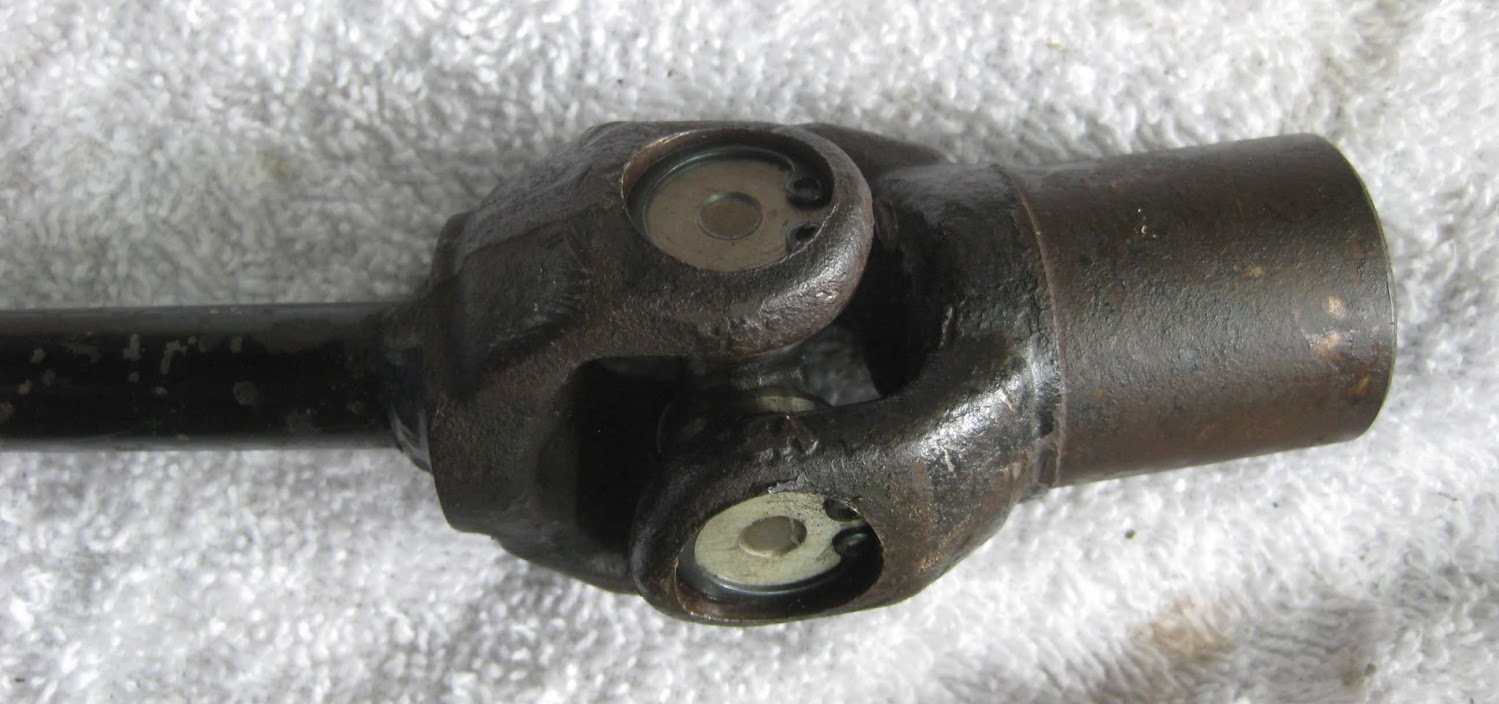

Once out, I followed this approach for disassembly with a hammer, sockets, and bench vise.

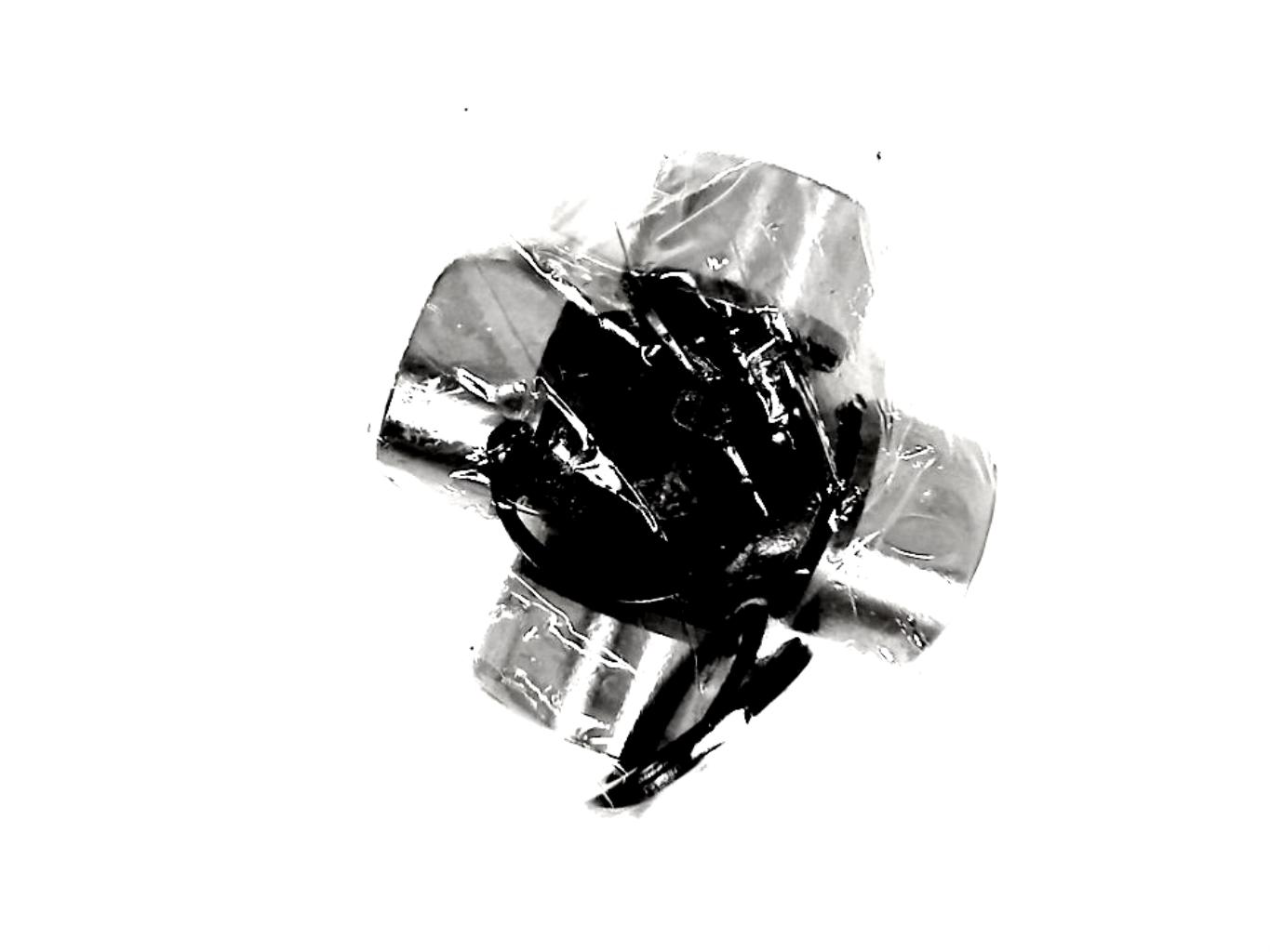

The parts manual lists Assy Joint Cross 66101-13580 for my model:
According to Messick's, that has been superseded by 66091-61830:
My local dealer does not stock that part, so I ordered it and followed this approach for easy assembly.
