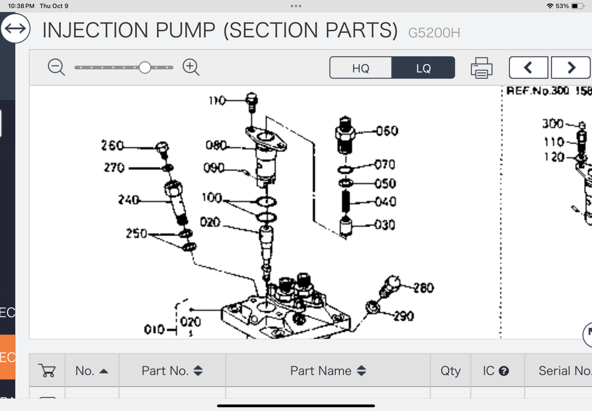

Good ’enin the forum. It’s been a while. I’ve checked in from time 2 time. The G 5200 has been running great….until I took her out to do a last final mowing of the season. I started her up and flipped open the hood to check things out and saw there was fuel leaking (sprayin) from near where the injector lines come off the top of the pump. There are 3 hold-down collars at the top of the pump, under the injector lines. These 3 collars(?) are attached to the top of the pump by tamper-proof torx screws. The leaking seems to be coming from under these collars. Or at least that seems like where it’s leaking from. I’ll see if I can post a picture.
My question…. does anyone know what is under these collars and what would make it leak?? If I take these collars off, will pieces go flying all over the place?? If the leak can be can be be remedied, will the system need to be bled?? And if so, how is that done??

I found this diagram on the Kubota illustrated parts site
There is NO way that I would take anything off of the injection pump. It is probably leaking underneath the #060 part but certainly could be leaking under the #080 part as you think. That is just a more difficult place to leak from what I see.
I would take the injection pump off and have it rebuilt by a professional injection pump shop like Oregon fuel injection or perhaps your local dealership.
There are probably some shims between the pump and block that must be replaced exactly as they are (same thickness total) so don’t loose any of them. For sure don’t send them off with the pump!

RK, thanks for the intel. That sure looks like an accident waiting to happen!! I’ll take your advice under advisement!! Take care. Semper-fi & This We’ll Defend, Mike

You think they put tamper proof screws on it for a reason? :unsure:
If you pull them off you change the timing curve and without the proper test equipment there is no way to set them properly.
There are a ton of "rebuild kits" out there, but they don't tell you about the downfalls of pulling them apart.
