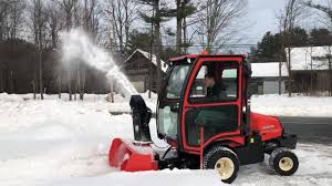

A snowblower that gets the job done and will not disappoint you can see here: snowblower for adults
