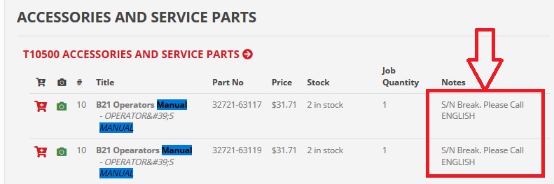

Investing in an Owners' Manual as suggested by Geohorn is a good idea.
I cannot find a free one.
Note that there are two possible manuals based upon the machine's serial number.
