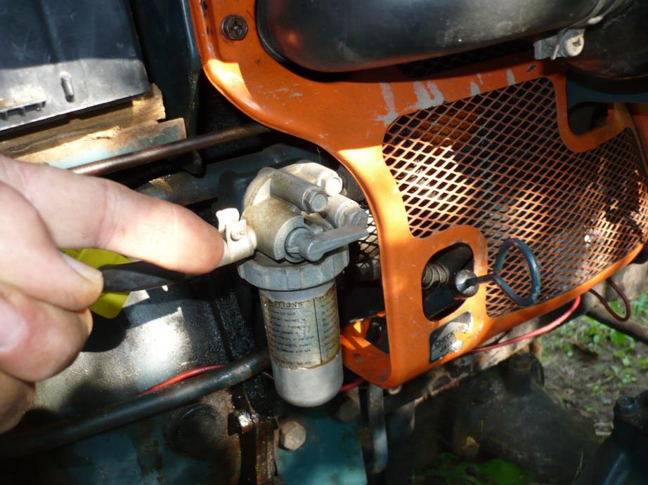

It's not clear from the manuals about when to use the fuel shut off.
My B5100 is the first diesel I have.
On the other tractors ( gas powered) , I normally shut off the fuel valve when I know
that I will not be using it in the next day or two or longer ( weeks sometimes) .
But of course diesels are different.
SO, when do you shut off the fuel valve?

in the real world - you should shut it off everytime the engine is off........
HoWeVer .......95% of us dont......(including me)
On a gas engine where the tank is ABOVE the engine, the fuel can get into the carb, leak into the cylinder, then into the oil! Can happen in diesels too!;)
you get whats called hydraulic lock - the piston comes up and tries to squeeze all that liquid and well you know how that is gonna end up ......
I had a 53 ford, learned the hard way when my oil level was rising on the dipstick......I learned real quick - cut the fuel off everyTIME.
it IS there for a reason, changing the filter is good one too!;):)

I shut that valve off when I change the fuel filter.
I've owned Kubota tractors since 1980 and never shut that valve off except for filter change, and never had any kind of a problem with fuel leaks or anything else. But then, everything I own is before all the electronic gizzmos. Maybe that makes a difference.
8,554
4,305
I don't have a B5100, but I wouldn't shut it off unless changing the filter. That's why that valve is there. Wouldn't shut it off otherwise.
Just HMO....:p

Heck, I'm going to look again but I couldn't even find a shut off valve on my Kubota. Since it had a screw on can filter I supposed it didn't need on...wrong! I took a bath in diesel until I could get the old one off and a new one on. Lucky I had one open in my other hand!
9,387
5,112
Pinch the fuel line off with a pair of pliers. Or pick up a clamp to put on the fuel line when changing. Keep a pail next to you, and place the new fuel filter with packaging removed and ready for install right next to where your working.
Crimp line, remove filter, drop in pail. Snag new filter and install. Should only lose a little fuel out of the old filter, and maybe a few drips from the fuel line ;) remove clamp or pliers from fuel line, and leave fuel filter a little loose. Finish tightening the fuel filter when fuel filter gets full of fuel :) will cut down on your priming :)
Good advice Daren. I did have the new filter out & ready because I anticipated a drip. Was I EVER surprised! :eek:

I have a small cup with diesel in it which I use to fill the new filter and bowl with before re-attaching. Our tractor doesn't have a fuel shut off, so we put a bolt into the fuel line to stop the flow. Re-attaching was quick and easy, no air gap, runs perfect. My thinking is that the trick is to have your bowl full when putting the filter back on.

My little Yanmar has a setup like that with a bowl & paper filter. In fact I replaced the old bowl, seal, and filter at the same time on it. It has a fuel shut-off valve in the head. Close fuel off, unscrew bowl, empty contents, clean bowl (or replace), insert new filter, fill bowl with clean fuel, screw bowl back on, open fuel valve. Purge lines and go back to work.
My Kubota L2050DT manual illustrates and explains it roughly the same way. Trouble is the tractor doesn't have this type of filter. It all appears factory and I imagine the manual wasn't updated to match the tractors since the model was replaced the next year. Seems to have been common with Japanese CUT manufacturers.
Mine has a screw-on can filter.
