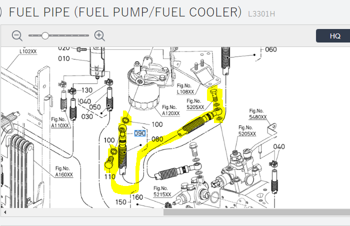

L3301 HST tractor, Only 250 hours. A rat chewed through a fuel line between the Fuel Filter and the Supply Pump. It is the fuel line right after the fuel filter and right before the supply pump. I have not had a chance to go to the Kubota Dealer in Watsonville CA yet. I would prefer to buy parts on line and then install it by asking some handy friends.
Here are my questions:
1. What is the part number for this fuel line?
2. How difficult to do it?
3. Is there a step by step instruction somewhere on line for replacing that fuel line?
4. Any on-line video instructions for the process or related process?
Thank you all in advance.
The first picture shows the staring of that fuel line. It is connected the the fuel filter at the right side (when you are looking at the fuel filter.). Then it looped back to the supply pump as shown in picture 2.

Fuel line part Number:
TC650-42800
It's pretty simple to change, pull the banjo bolt, make sure you collect the 2 washers one over, one under the fitting on both ends.

Thank you all for your insight inputs. I really appreciate it. I started to look for the part, so far no luck yet. But I am going to call around to see if I can get one. I would like to ask that if that part is used in other machines with different number. If I can buy a braided line with the same ends and length, that would be a excellent solution. If the washers at both ends would be crush or copper washers, would they come with the line or I need to buy separately? Thank you all again. Digou
Separate, part #100 on the diagram above.
