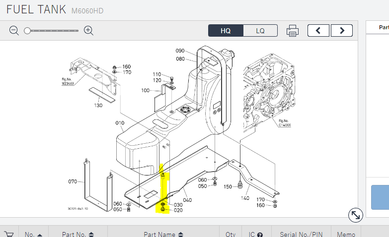

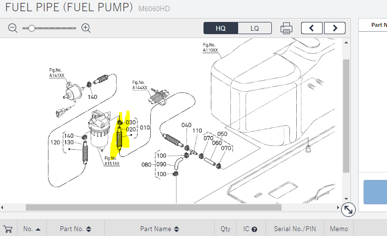

Sounds like you have an issue with the separator (very common).
First, check the drain on the tank, open it up and you should get good flow.
Second take the line off coming out of the separator, you should get good flow.
Third take the line off the output of the separator, you should get the same fuel flow there.
If you don't pull the separator off and check / clean the input elbow of the separator.

Yes, Because it would depend on where in the factory fuel lines, that he connected the jerry can.
This is why I try a provide as many pictures as I can when I explain troubleshooting.
