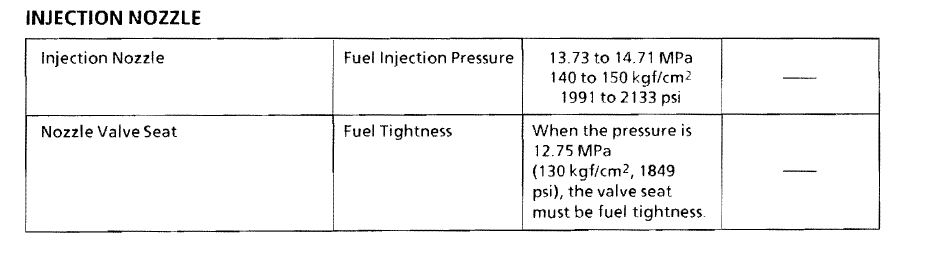

Does anybody know where I can obtain the technical specifications for the L245 Fuel Injectors? I have a desire to test mine but I don't know what the specific tolerances and limits are.

Kubotabooks.com has the WSM, the specs are in it. ;)

Thanks! Unless I missed it, which is entirely possible, I did not see any injector specs for the D1101A engine. I looked through all of the Engine docs and I did find one page of specs listed in what looks like a Power Point presentation. Just no Fuel Injector specs.
I did see where other injector specs were listed and mostly in the same range. I'll use those numbers to see how mine stack up.
