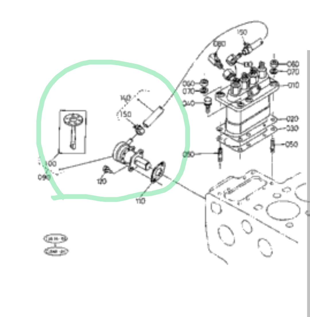

If you're sure it's fuel and not hydraulic fluid, the lift pump is the most likely suspect. Yours has a replaceable diaphragm.

The lift pump can go bad and it will allow fuel into the crankcase.
really simple to check that, pull the lift pump leaving it connected to the lines, put a bucket under it and let it sit for a day or two, if there is any fuel in the bucket then there is your culprit.

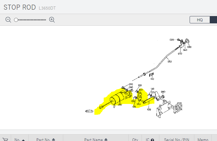

I will throw something out as a question on this -- I have not been back to the shop since I started this thread. I read in the owners manual of an electric engine shutoff. Obviously that would be a solinoid as shown in the parts manual. However, I do not think mine has the solinoid (thanks to previous owners) and I use the pull lever to kill the engine. IF I push the KILL LEVER in after the engine has stopped - and key off -- would that allow fuel to flow into the injectors and into the engine? I think I have answered it with No excessive black smoke on start up...but wondering........

No not at all, the electric stop solenoid only pulls the stop linkage (same as pulling the stop rod) for about 5 second then it returns to the run position.

All back together and headed out for more grading. After only a couple of hours it was obvious that did not fix the issue as the oil was growing up the dipstick. Next option was to pull the fuel lift pump. The problem was instantly found. Diesel was dripping from the plunger end of the pump. This was a great time to do some long overdue preventative maintenance and replacing the fuel lines.
