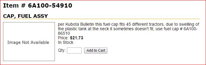

dayum. never would have believed that! Good call NIW.
now - if THEY new that .......still should have sent the correct cap!
14,438
6,741
I would go back to the same dealer and tell them I did some research and found this, "Item # 6A100-54910" replaces the original cap. Can you confirm this information. (This will force them to learn something and to get in their books) Might even help someone else in the future.
When they discover the information is correct, have them order it for you and return the original one that doesn't fit. There is no way I would pay for two caps with one not fitting, unless postage or gas was greater then the difference.
