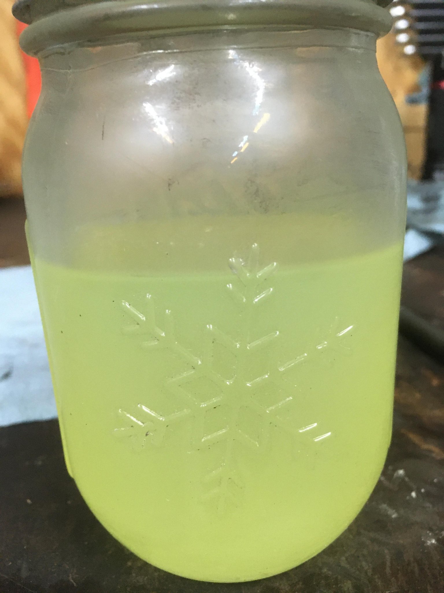

Diesel doesn't start to haze until 14°f. And, it has to stay there for a bit. A 5 gallon bucket of diesel won't get that cold unless it's that cold for several hours. The air has to suck all the heat out of the fuel before it will start to gel. So, no. You don't "need" to run right out. Pump fuel is generally treated for your climate already. Off road fuel possibly even more so. I know the supplier nearest me has a sign on the pump that says it's treated to 0°f already.
That said, adding some lubrication to the very dry diesel we are forced to use is never a bad idea. It wil also help pull water out of the fuel so the water separator can do its job.
Edit- this photo is fuel straight from the pump. The outdoor temp got down to-5°f that night. Daytime temps were in the 20s. Well below our normal temperature. Would this have happened in my truck? Probably not. All the lines are protected and most are insulated. There was no mass diesel catastrophe that year. But....not too long ago in TX, I had to mail my BIL a quart of additive because trucks were gelling and there was no additive to be found. So it can happen.
