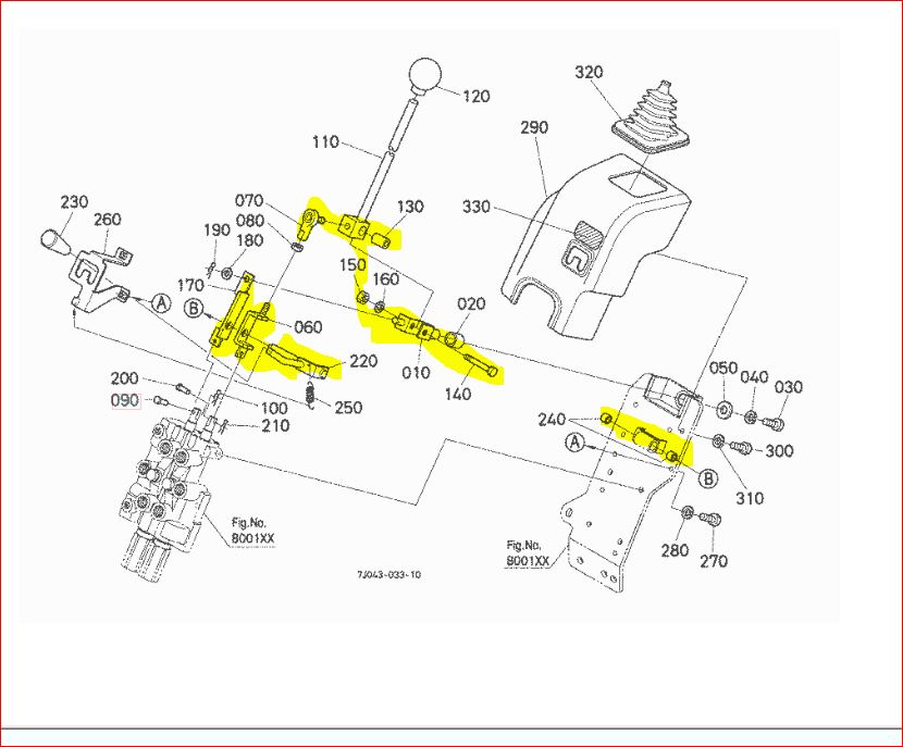

That's not the type that freezes normally.
Before you jump into taking it apart make sure the handle linkages are free, I'm betting that's where it's freezing up.
And on this model you can NOT drill any holes.
You might need to pull it apart and clean and oil the detents but that model they are semi sealed, but be warned it's not for the faint at heart. :p;)
When you pull it apart all of the parts in yellow will come out. :eek:

I looked at the parts diagram last year and decided to hold off and hope for the best. When the temp dropped this year, it did freeze again. If I just leave it and it continues to freeze on extra cold days, will the freezing do any damage in the control valve?
The first diagram also has parts that are yelow highlighted. Are these the linkages that need to be lubricated and will I need to remove the plastic cover?

Yes in the first diagram is all the linkage, lube all of them.
