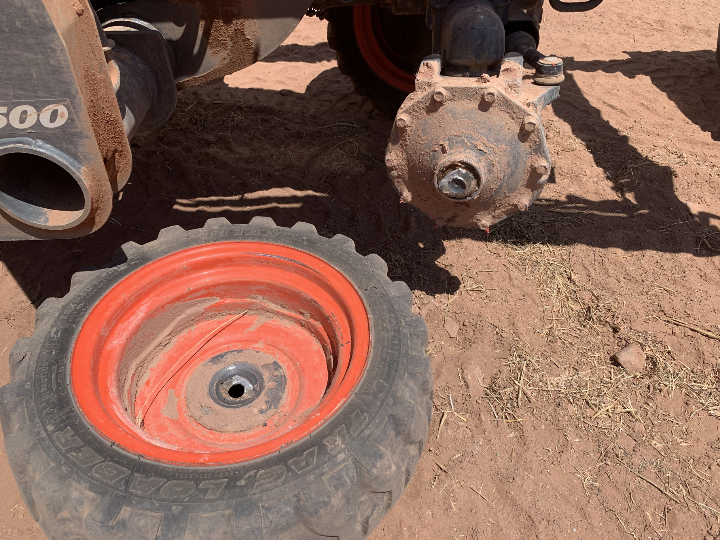

My observation is that K is frugal and makes all of their equipment on the lighter side of factors of safety. Do a search on these forums for broken axel/wheel if you want pics of broken SCUT/CUT parts
