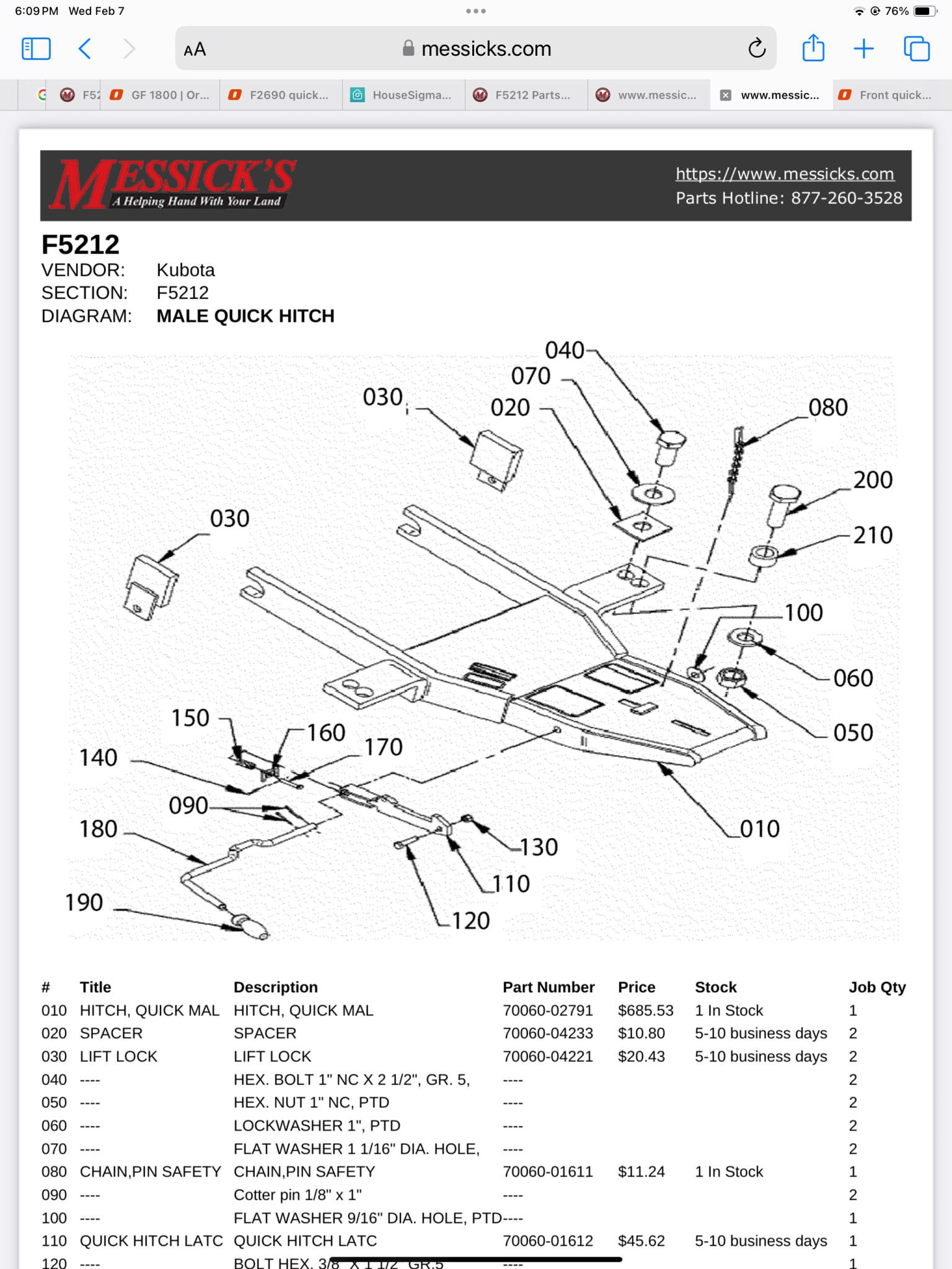

Someone’s idea of adjustability? Not enough meat to keep those holes from turning into a slot if used to any real extent.

I had to look rather deeply at this oddities kept coming up.
The GF's are Canada only, The US does not sell them so support is very limited.
The GF just has different mounts on the arms than the other models.
They use a one bolt mount, not 2 bolt mount.
That shoe just uses 2 bolts.
It's not an adjustability thing.
Are you trying to adapt this to the GF arms with only one hole on the arms?
Contact a Canadian Kubota dealer and see what mount they are using now.
If it's a mount with 2 bolt holes, then the arms on the GF have changed.
You can either alter your arms to fit the new 2 bolt pattern or you can alster the shoe to fit a single bolt pattern.

Appreciate your reply. Both pictured are for the F series. I had a GF but recently moved up to the bigger F2690. Hope that clears up your reference to the smaller GF1800. Both pictured are the same and meant to fot the F series but have different bolt patterns. ???

They are pretty hard to come by. They list for about 900 CDN at the dealer. I recently bought a snowblower that included the hitch. Only reason I bought it. I converted the F5211 to a F5212 by grinding off the mounting bolt holes and relocated them. Are you in Canada. The F5211 only fits the F60 Series unless modified.
