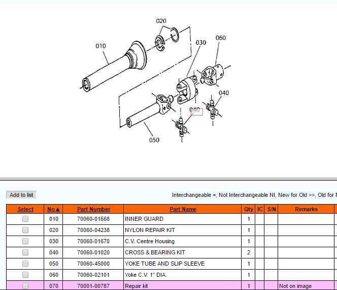

North Idaho Wolfman: I appreciate the help, I saw that diagram and basically need 10,20,50,40 x 2, 30, and 60.
I haven't been able to figure out what exactly is in the repair kit #70. Does anyone know??
