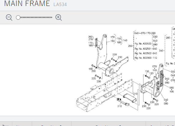

I ordered a LA 403 from Kubota 9 months ago. Still waiting for delivery.
Now I found a LA 534 model near me. It was attached to a B2650.
Can anyone confirm if will fit or what issues will I be dealing with?

At a minimum you will need all of the subframe components that normally stay attached to the tractor.
30,162
6,334
Main frames are completely different and one will not bolt in place of the other.
