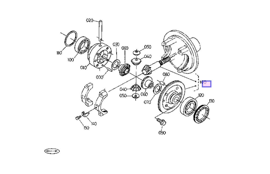

Set about replacing couplers on the front driveshaft and I've noticed that the splines that come out of the front diff are completely worn down. What are my options? How do I remove the shaft out of the front diff?

Your options are not good, the only real option is to replace the front ring and pinion gears, they need to replaced as a set. ;)
