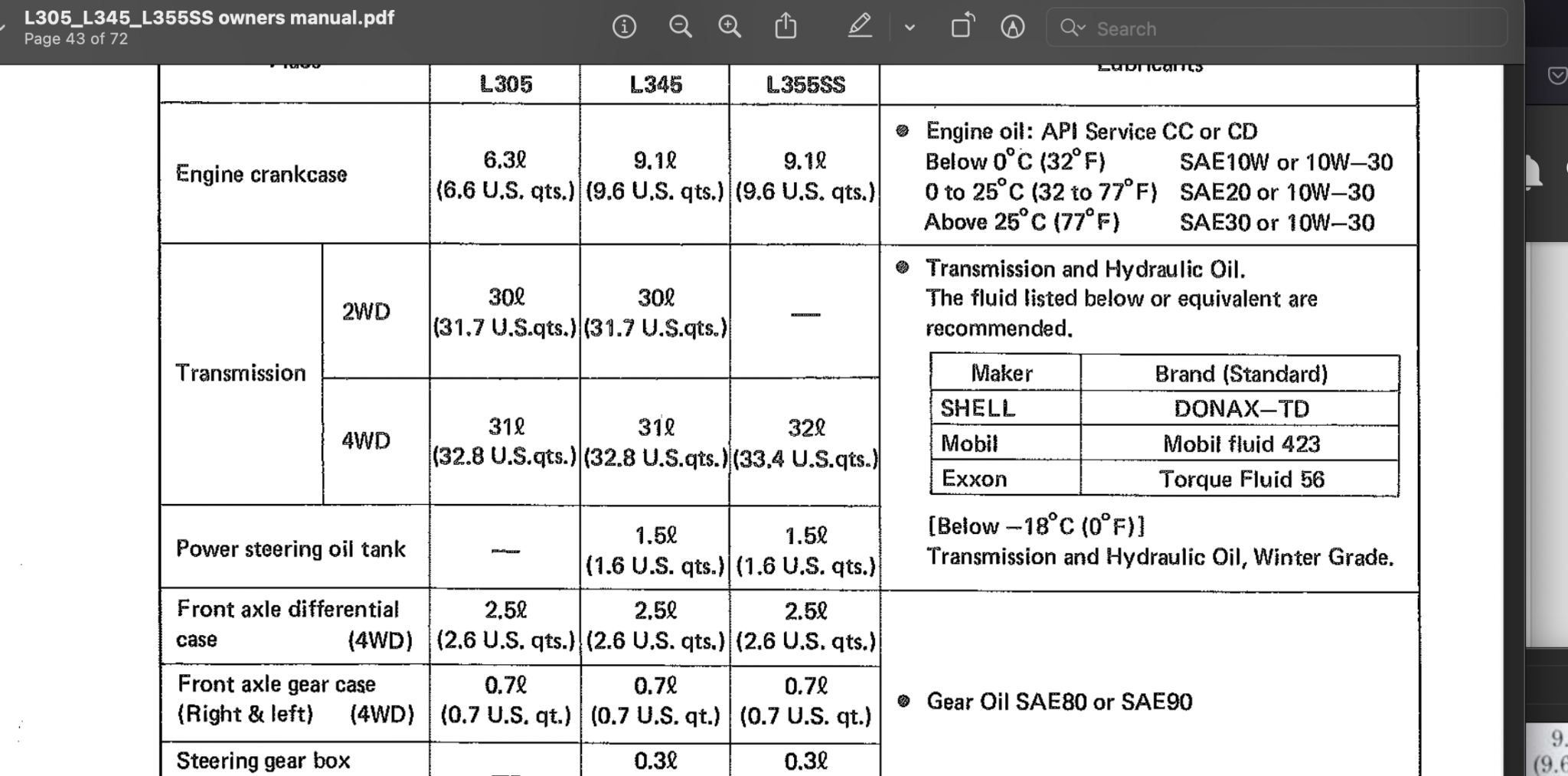

Hey guys, Another resurrection for this thread. I also have an L345DT.
It's time to drain and refill the front axle.
I see a huge discrepancy between the owners manual and the WSM.
So, do I fill the center section with 5.3 qts or 2.6qts? This is really confusing.
I drained about 4 qts. plus a bit more. Maybe 4.75 qts came out.
The outers will both get .7qts of gear lube. So at least that data is correct.
I filled it with 5 qts of gear oil and the fluid level seems really high to me - it comes to the first (lowest) thread on both fill ports.
am I missing something?
Thank you for any/all help.
